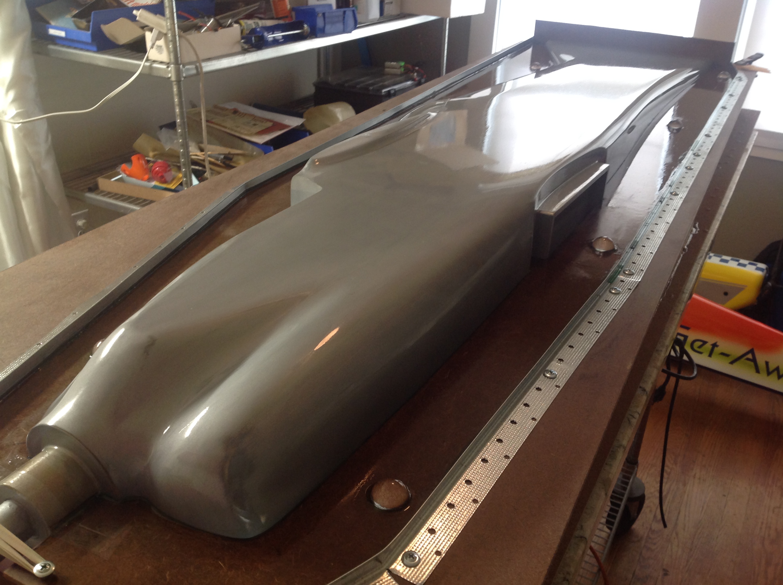

The parting flanges got cleaned up and a sealer of epoxy applied today. This coming week will be spent fine tuning the flange surface. Looks like mold production will happen the week between Christmas and New Years.

Let the mold making commence! Got the plug into the parting plane for the last time, got everything in a couple coats of wax and then PVA. Now the fun really starts.

Ok the fist mold half is done. After a few days cure time I will start on the next side.

It took a bit longer today then expected but I was able to remove the parting flange, do some clean up and get the plug prepped to do the other side. I ended up having to do some sanding on the mold flange, then polish it back out. Then my 10 year old Partall wax didn't want to buff well but after a couple hours I has the surface back to a nice shine. As it sits now, I have the first coat of surface resin on and will apply the second coat first thing in the morning.

The second fuselage mold half is done and I have trimmed the flange. Next up is the hatch and wheel pant molds.

Thanks Ken, I plan to separate the molds and polish them over the weekend. I will post pictures when finished.

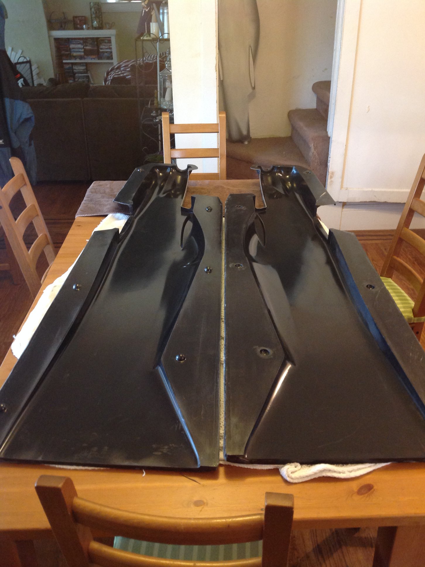

I have molds!! Planning on a fuselage layup next weekend.

Ken, I haven't done any polishing yet. That is the finish left by the PVA. I didn't go into much detail here but most guys spray PVA as per the instructions. I apply it with a foam craft brush. I get much better results this way and it is a faster way to apply with the brush.

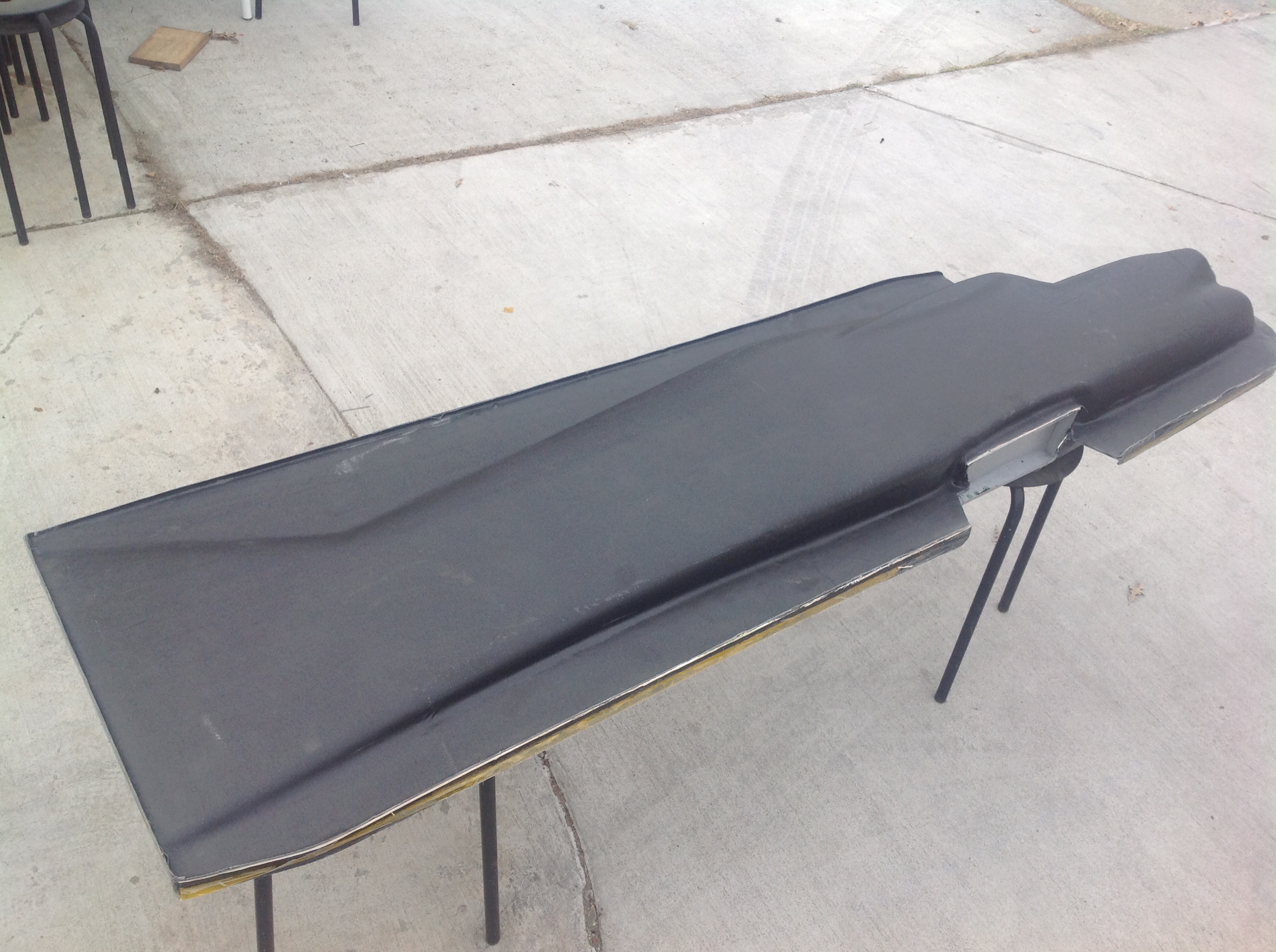

This is what I have after about 15 minutes with a small orbital polisher on each side. More then good enough as I am not doing a paint in the mold job. I will shoot some Klass Kote white primer in the mold prior to the layup. Should result in minimal work needed prior to shooting color.

I think I am finally going to see some fruits from all my labor. The first fuselage half is in the mold and under vacuum.
