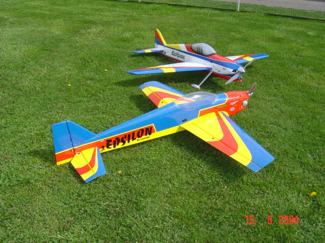

Joined: Nov 2003
Posts: 34
From: Santiago, CHILE
Here are more pictures
. This is my Epsilon ARC. Last weekend was their Maiden Flight. The configuration that I used was:
OS 91 FX
APC 14x8
Fuel Tank in the CG (20 oz.)
VT-30 Perry Pump
Futaba S9101 for Ch 1 & 6
Hitec HS-5945MG for Ch 2
Futaba S3004 for Ch 3
Hitec HS-5945MG for Ch 4
Futaba R127DF
Futaba WCII
MK Bell Crank for Ch 2
Pull – Pull for Ch 4.
CG: +/- 40%.
Weight: 4.550 Kg.
Fuel: Dynamix 15% Nitro 18% Oil (http://www.dino.com.ar/productos/dynamix/dynamix.html).
The first two flights was with the engine incidence too low and to the left. Use the cowling as guide (for the OS 91 FX) and you can’t go wrong.
I defined three conditions: 3D as Marcelo says for 3D, Normal as Marcelo says for Sport and Landing with 40- 50 % of Sport definition. Exp –40% for all.
On the fourth flight I increased Ch 4 in 10-15 % for conditions Normal and Landing. For Pattern Flying I used Landing condition but I still think that I must decrease Ch 2 in 5-10%.
I increased Ch 2 & 4 in 15% for 3D and I can do hovers with 50% of power. At 65% I have unlimited verticals.
I tested the WB 60 six months ago and I really liked it, but after 5 flights I feel better with my Epsilon. I selected it for Pattern AND 3D !!!.
One incredible thing with the Epsilon is the Knife-edge and the Snap Roll
P.D: GRACIAS a TODOS en CAModel ...

Got the 110 in and ohh boy is it good
After a few minor problems. Bolted the motor in ran it up first tank fine, rich ... lean etc to run it in. second tank all looking good ... ok no escuses now then fuel her up again and off into the blue ... taxying out just checked the throttle response ...that soft mount is moving a fair bit I thought then a second look I saw the engine had pulled it self clean out of the top mount.[:@]
[:@]Took it home and reinforced the F1 carbon both sides.
I must reinforce at this point it is not a fault with the model. I mounted the engine inverted so the top two bolts were in the 1/8 thick top piece of the F1. Lesson learnt
Managed to get a flight in between the showers on Tuesday night and this has got to be the perfect combination. The YS is not even run in properly yet and has vertical to rival a .... rocket ...well nearly. prop hanging a dream ... big vertical uplines fantastic ( all though trying to lay off them till the YS is can be peaked out )
: D
You might say I am a very happy boy with the best plane I have ever ever flown.
