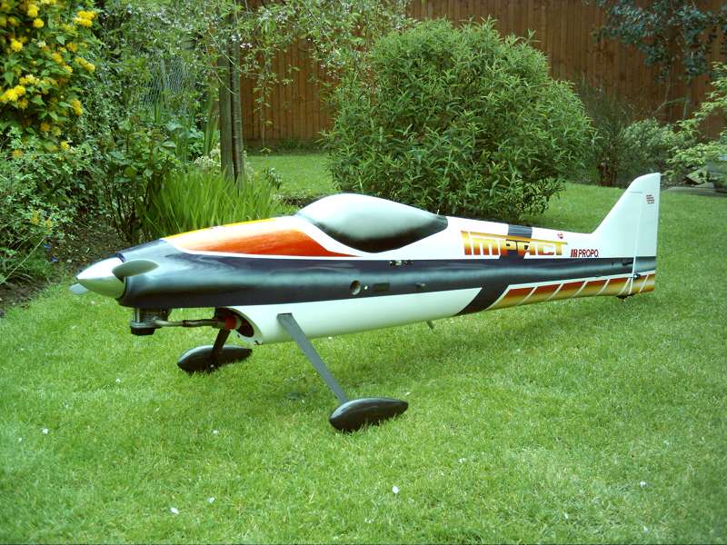

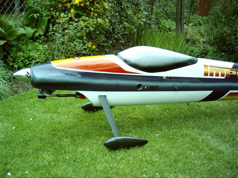

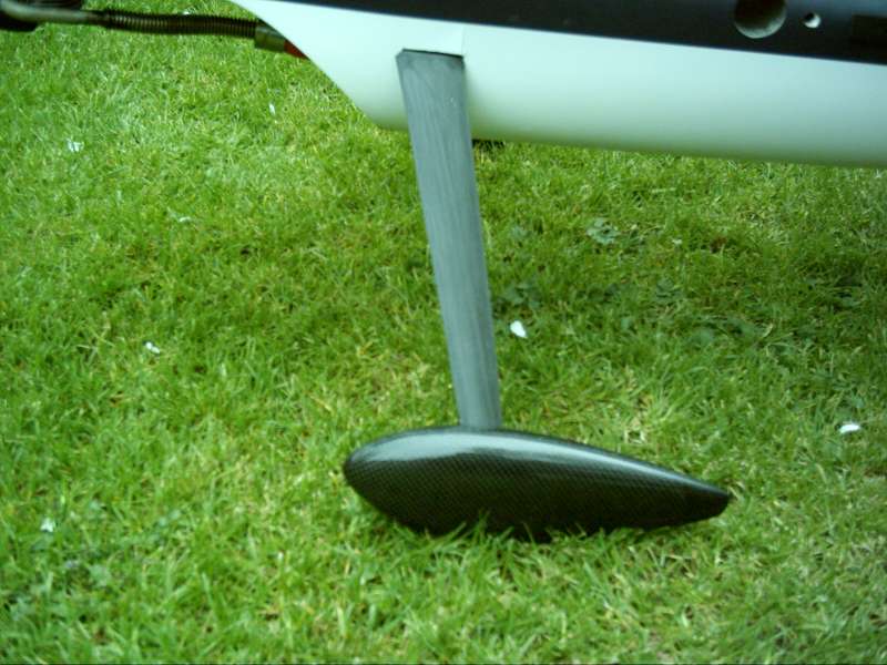

Thought I'd share these with you. After an engine cut (my fault entirely, forgot to adjust throttle trim in ST1) I have had to fit some new gear to the Impact. I've gone for the Bolly F3a Wide with matching spats. I got them through Elation Models here in the UK (check www.elationmodels.co.uk). I had to trim the fixing plate a little in width on each half but other than that they went together quite well. They do provide a wider track than the carf u/c and the legs are solid carbon strand instead of carbon cloth over foam.
Regards,
Andy.

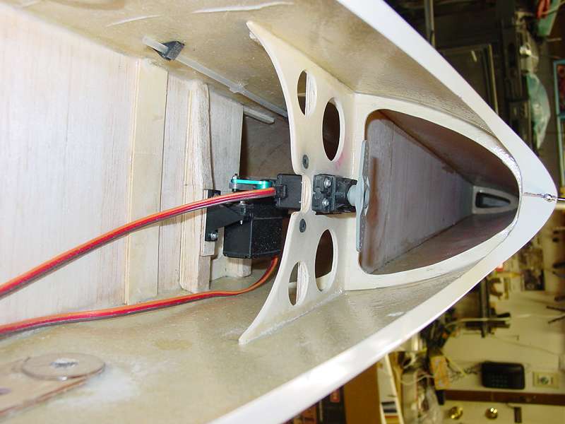

I use fuel tubing split down with a scalpel, here's a picture of the servo & receiver tray in my Impact. The tray is made from carbon sheet that's 1.5mm thick so I decided to protect the servo cables where they pass through to plug in to the receiver.
Andy.

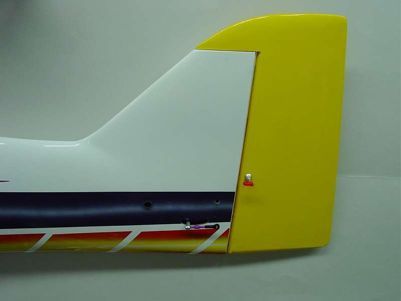

Due to some teasing from Composite about my red rudder, here is Impact #2 with a new color on the rudder. Sort of a before and after :-)

Great pic's! Have you angled the rudder post back on the #2 Impact? it looks as though it's leaning back slightly. I would imagine that the angle would give a little down elevator effect whilst introducing rudder movement, is this an effect your trying to build in to the model?
Regards,
Andy.
Old 05-04-2005 | 10:12 PM
  #575
Eric.Henderson's Avatar
Joined: Sep 2003
Posts: 1,413
From: HENDERSON, NV
Default RE: Impact
It is, and they are all, exactly the same. The red-rudder just happens to be turned a bit towards us.
There is absolutely no need to change the hinge angles. I just made the top a bit shorter to reduce the power of the counter balance. (I actually cut the counter balance completely off my Temptations.)
What you cannot really see is the double bevel. that made it easier to retro-fit. Also on number 2 I slipped a 1/8" fin rib in place. It runs a t about 45 degrees up from the TE of the stab. Now you can't compres the fin at all.
I intend to fly number 2 tomorrow - it got too finger-bone-chilling cold and windy over that last few days. I will fly both of them as hard as is "fair to the plane" and see if all of the upgrades succeed in keeping them together. I may even do some reverse avalanches with 1.5 snaps !!!!
I can fly number one left-handed around the field on KE rudder @ 1/4 throttle. I hope number 2 is as good?
