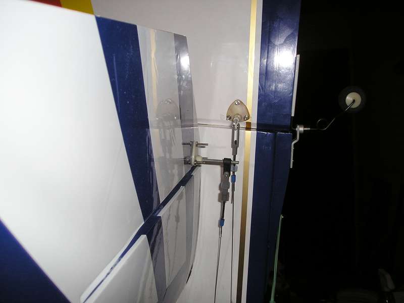

Hello Men,
It's great to hear the flight reports, I'm ready to get mine in the air. Thought I would post some pics of the control horn I used. They did a great job of getting the clevis pin over the hinge line. Also, how are you guys cutting the bottom of your cowls for air on 2 cycle angines?
Greg

#391
Bodyworks,
I got the control horns at Tower Hobbies. The aileron horns are Great Planes, Tower #LXEVC9 and the elevators are Dubro are Tower # LXEMF9. I did have to cut length, sand and drill holes in the elevator horns to get them to line up over the hinge line. I other words they were about 4mm too long. The only drawback is you can't get them individually, you have to purchase them with all the hardware. I thought it was worth it because of the clean application, and I got the plane on sale. If I were to build another one I would consider the Great Planes for all control surfaces. They are less expensive and though they might not get clevis pin directly over hinge line it would probably be enough to achieve Ackerman effect.
Greg

My friend and I ordered two excellerons together, and I built mine first, when he was building his I noticed the control horn hardware of his plane was slightly different than mine, actually when we were testing the surface we noticed a bit of 'give' of the elevator under load. On closer inspection I saw that there was a lot less plastic material holding the screw of the control horn on all his hardware than in mine. The base of the plastic thingy on mine had a lot of more material holding the screw and was a lot stiffer than his. GDAVIS on your 3rd picture I noticed that you used the stock hardware for the elevator surfaces, and it is the same as my friend's, the skinny ones, try pulling the screw with your finger and see how much force it needs before the plastic starts to flex, I bet that it will flex with relatively small force.
I am not close to my plane or his to get some comparison pictures, but I'll try to get them so you can see the difference.
My friend has flown his plane like that a couple of times, so maybe it is no big deal, but just wanted everyone to know.
Gabriel

#394
My Feedback: (55)
GDAVIS,
The stock control horns on my Excelleron are the same as yours and I've been flying
mine , with YS 1.10, since last September and it's been through lots of flights and
some pretty severe maneuvers, high speed snaps etc, with no problems. I wouldn't
worry.
tommy s
worry.

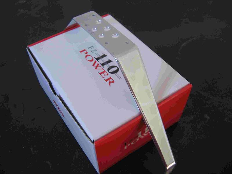

Weighed all the parts today:
STAB & ELEVATORS-7.66 OUNCES
FIN & RUDDER-3.05
LEFT WING-14.0
RIGHT WING-14.0
FUSE-22.0
BELLY PAN-3.4
COWL-3.8
CANOPY-2.5
LANDING GEAR-3.51
ALL HARDWARE-14.3
TOTAL KIT WEIGHT= 5LBS, 8OZ
I also started on the LG diet. Didn't really lose too much (0.4 ounces), but they look better. I just drilled some holes and beveled the edges and polished it a bit...
