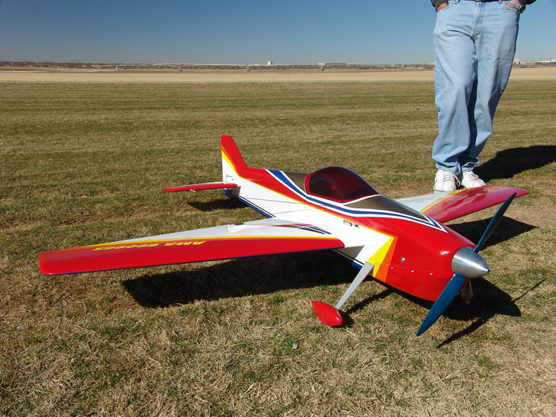

I flew my Excelleron yesterday for the first time. Boy! It is a smooth flying airplane!
Mine has a Saito 100 with a 15x6 APC pulling it, and while it is not a rocket in vertical it sure pulls it good enough to make huge loops and vertical climbs, have not tried vertical climbing snaps yet, but anything in the Sportsman and Intermediate patterns it can perform with ease.
Speed is great, I cruise at a hair above half throttle and only use full throttle when climbing, and this gives you a very manageable medium speed, it may be slowed a lot with a 16x4W but haven't tried that yet.
The specs on my plane are: DS8411 on surfaces, HS-55 on throttle, Saito 100 on 30% heli, 15x6 APC at 9,500rpm (rich setting, engine not broken-in yet), 2200 Li+regulator, CG at 7-3/8", original tank at the standard position, dry weight: 7.88 pounds, standard LG and hardware.
Inverted flight just needs that you 'think' you are pushing the elevator, just the slightest touch will hold it. Maybe it is a bit tail heavy, but I loved it's feel.
The only trim adjustment I had to do was up elevator about 8 clicks, it ends up pulled from visually centered to the stab, I don't know if this is an incidence problem, if anyone can share some way to check this? What is the wing and stab incidences?
The ailerons are really responsive, and if you use the manual settings you better dial in a lot of exponential and be easy on the stick. I don't remember what I used, but it was low rates and a LOT less than what the manual suggests for testing and even that was extremely fast. Elevator was set about 15mm as per aerobob's suggestion, and it is pretty smooth for pattern flying.
One of the most amazing things about this plane, at least for me, it's how EASY to land it is; it comes down smoother than any other plane I've ever flown (and I've tried a few). Just line up the runway, chop the trottle to idle, correct any cross wind and watch it, it needs almost no elevator until the flare, and even that is just a touch. You can perform perfect 3 point landings with no effort at all.
I am not used to flying a plane this light (it feels extremely light in the air) and the problem I had was with wind correction when doing loops and climbs, it felt as if the slightest gust of wind will throw it's tail off-track so I have to keep compensating a lot with rudder. But this is my problem, not the plane's.
One thing that did go wrong with the original kit assembly was with the servo tray. After I took off the first time, I found the rudder to be almost non-responding, and when I landed it was loose, the cables were completely slack. After I remove the wing, I saw that the front triplay doubler for the rudder servo on top of the tray had come loose, cleanly unstuck from the tray. Nothing a couple of drops of 5 min epoxy would not fix. But I recommend anyone who is building this plane to reinforce this with CA or epoxy before the maiden flight. Good thing the ones for the elevator are under the tray!!!

Gabriel,
That's a good report. I have a Saito 100 in my U-CAN-DO 60 that weighs 7.5lb and with 30% heli I can rocket straight up out of a hover (APC 16x4W prop). If your Excelleron only weighs 7.88lb you are right about good vertical performance.
How much weight did you have to put in the nose to get it to balance? I saw that the YS110 took about 6oz. So I would think a Saito 100 would take about 10oz. If you have to add too much weight, I think there are better choices for an engine, but if you have a Saito 100 sitting around (like I do), it may not be a bad option.
Dave
Dave
#348
Joined: Jul 2003
Posts: 53
From: El Paso,
TX
I didn't add any weight, I just installed the batteries behind the firewall, the fuel tank in the stock position and used an Aluminum spinner.
It ended up just a bit tail heavy, but nothing to worry about.
I want to make it lighter still, by changing the metal gears in the DS8411 servos to plastic, this should balance it a little bit better.
I had the Saito in a Staudacher and was supposed to install it in a U-Can-Do, but this excelleron got in the way and stole the engine.
I am very happy with it, as my other option was a YS140, but did not want to go to that extreme.

Gabriel,
Man, I'm jealous of your flying field , wide open spaces !
I see I'm not the only one that didn't like the stars on the wing and stab.
The only caution I could give you is to make sure to reinforce the landing
gear mount as it is a little weak and will break loose if left stock. I've
been flying my Excelleron since September and I like it better each time I fly it.
tommy s
