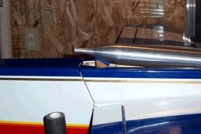

Progress update after the holidays. The wing and stab are mounted and the surfaces hinged. The belly pan pipe tunnel and pipe mount are completed but not sealed yet. The engine and Ice Point gear are mounted. The Ice Point gear gives lots of clearance with a 17" prop installed. The rear pipe mount is screwed and epoxied to the wing hold down doubler so that it can be removed when the wing is taken off. I imagine I will use an o-ring hold down ala AeroBob.
Thats it so far.
Thats it so far.

I did the pressure tap. A little tricky, but use a 90 deg on a short piece of fuel line to get it pointing forward, and it's fine.
olddogg60 - coupler material looks familiar
. Great job with the Icepoint gear. I have them, and may install if I need the clearance...also have an Icepoint PLANE coming, too....should be a fun Spring!!
Haven't flown the thing....still too dang cold/windy/freezing for me...but I will !!!!
I did set the thrust by just the spinner ring against the face of the fuse nose, and it was okay. Maybe needs a skosh more right thrust, but I don't know for sure.

) I did glass the pipe tunnel and mount today. I think that I will give them a shot of white paint to dress them up a bit then start mounting linkages and servos.
