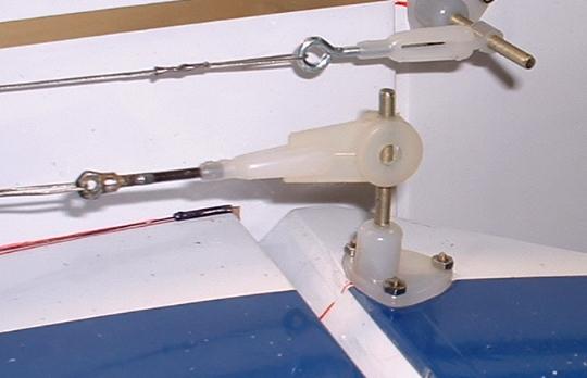

Elevator takeoff solution - maybe - ya'll look at this and tell me what you think. This was made from a steering arm, removing the 5-32" wheel collar, drilling through the plastic, and threading it on. Drilled a clevis attach hole where ever I needed it.
Anyone think of a reason this wouldn't work as well as the "high dollar" DuBro (unavailable) parts???

That is a great explanation of why the stock control horn set up on the Excelleron
works very well. My elevators move just about 1/2" up and down and that amount
of movement is more than enough for any maneuver I want to do. When fully
deflected the non pulling cable might lose a little tension but it is very little , not
enough for me to make any changes. The tension change is so slight you cannot see it
and can barely feel it. If the non pulling cable was getting tighter then I would worry.

That is exactly correct. You want the cable not being pulled to maintain the same tension or slack a little. You don't want that cable getting tighter. It all has to do with where the pivot point is in relation to the hinge line. I have read many peoples' opinion that slack in the non-pulling cable will cause control surface flutter. I don't think it can happen. For flutter to occur, the surface has to either move against the pulling cable or against the airflow over the surface.

The problem with the stock setup of the Excelleron is that it places the pivot point too far aft, and THAT results in the non-pulling cable actually increasing it's tension as the PULLING cable approaches it's max deflection. THIS produces assymetric tension on elevator halves, and believe me, guys IT IS A PROBLEM.
What it creates is assymetric elevator travels near their limits as we set them up, and that produces corkscrewing. Hard pulls like square corners, or pushes, like we have in the Vertical Square Eight DOES CREATE troubles.
What I've been searching for, and solved, with the help of others, I might add, is the "neutral" Ackerman, and that is with the control takeoff exactly over the hinge line.
I'll update with better photos after I re-string the elevator pull-pulls.

Fortunately, the LHS had the Dubro steering arms. They have the proper locating of the arm on the diameter. Drilled through easy enough, then threaded on and put new clevis attach holes ON the hinge line.
An example where the theory is correct. Thank you, Mr. Ackerman. I have all four clevis take off points exactly the same distance FROM the hinge line, and they are all OVER the hinge line. So now, the PULL side pulls, constant tension as near as I can tell, as the opposite cable slackens slightly. The travel of both elevators is now symmetrical out to the maximum, and they track together.
Can't wait to fly it now that I have this fixed.
