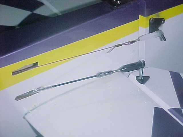

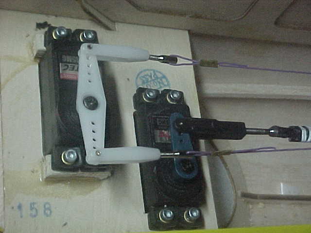

Here are a couple more pics. I ditched the wood dowel push rod and went with the D.E.P.S. system from Central Hobbies I had left over from my Epsilon. Also used the kevlar pull/pull material that I got from Matt K. it's even purple to match the bottom of the plane.
