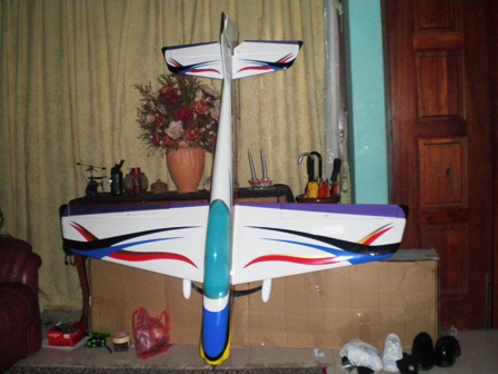

Joined: Nov 2003
Posts: 29
From: alor setar, MALAYSIA
this how my Leo look like still waiting for Digital servo (14kg) to arrive . look at the thunder tiger pro 120 and home made manifold (yet to be tested)

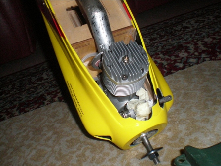

Joined: Nov 2003
Posts: 29
yesterday run in/broke in the engine bolted it on the model.. using 2/12" plastic spinner.. hand flick more than a dosen times.. at last it ran.. I had to run it rich for full tank.. no tachometer used yet.. I could feel the power already with 16X5 wooden prop.. looks like the homemade manifold is gonna work alright... tomorrow can tune the engine to optimum RPM and hope have gut to maiden the plane..
nubli
nubli

I will put an Os 140 RX , i actually have the 91 FX with OS pipe,but the power is too limitate couse i fligth at 5000 feet.
i think to move 1 servo(maybe elevator servo) ,the receiver, and the battery back to get balance.i will post some pictures when the airplane will ready.
