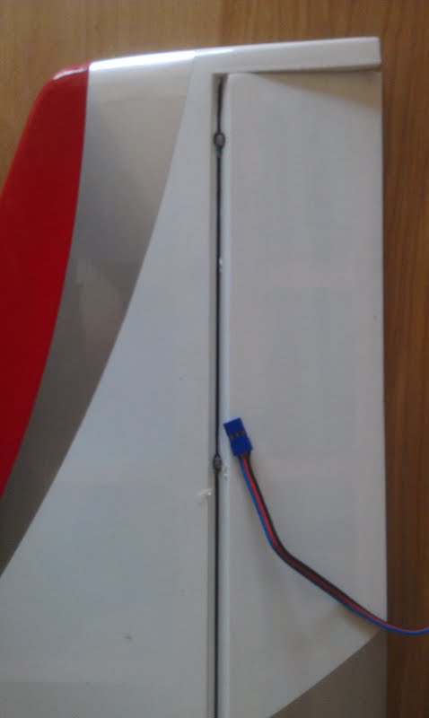

I'm reviving this thread - Like above, I am trying to seal hinge gaps with robart hinges. Truthfully, I didn't do the best job with the hinges as it was my first time ever using them (I think I've FINALLY LEARNED my lesson and am done experimenting on my contest planes). Anyway, I am looking for some advice on how to cover up, uh I mean seal, an ugly Robart hinge gap.

Here is what I am up against. I guess it doesn't look that bad, but it does bother me. I also noticed, after your comment, that the barbs on the Robart hinges are completely through the thin piece of wood at the LE of the stab. So, I've got CA hinges that broke, and you can see I have 3 robart hinges PLUS a few misses in one of the stabs. What a mess, and of course the Rudder looks just as bad [&o]
At this point, I'm thinking about a 2M plane, probably when the Osiris becomes available. I was thinking I should try not to throw too much more money into this airplane, and thus have been putting off buying a new set of tail feathers ($70). Unfortunatly I used a nice set of Atx servos in the stab which are very small, and needed a mounting plate to fit right. Of course I didn't do the best job there, either. As a result, when I consider a new set of tail feathers, I also think about a new set of servos that actually fit. Total cost is about $200. Not sure how much any of this really affects my flying - any low score I get is due to pilot error, no idea how much this would affect the flying capabilities of the plane, or even if I'd notice it. I've got 2 contests at Intermediate under my belt, and was very happy with about 3 rounds of the second contest.
Or I could put more effort into repairing and setup, and gain some more experience with that and trimming. Not sure where I'd put new (CA) hinges - probably have to put them right on the inside edge of the stab/elevator.
Use 3M Blenderm tape if your single goal is to seal the gap for aerodynamic benefits. It's available at your local drug store. Also Du-Bro offers it so it may be at you local hobby shop as well. The tape sticks extremely well plus has stretch/flexible like properties.
If the above plus cosmetic cover-up is your goal use iron on Monokote or Coverite cut to size folded in V shape to fit the hinge groove then apply iron heat to seal the edges. A trim iron works great for this task allowing you to iron down inside the hinge groove.

I'd suggest you take the surfaces off the plane, dig new pockets in the LE of ele/rud and TE stab/fin and install fresh wood. CA the wood in place and re-finish, then install new radio south hinges, Then seal properly. It won't change the flight character much probably but it would give you peace of mind.
It's a simple fix that wouldn't take long to actually do.....
OR, iron down a strip of monokote in the hing line and call it a day
