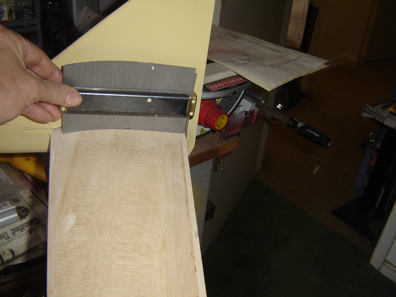

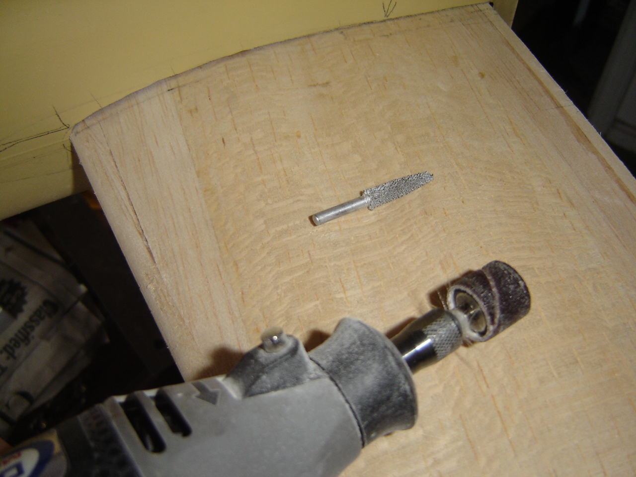

I did not pre drill as I use a Dremel tool . I was less than perfect on the cut out I used a carpenters gage to approximate the cord of the horizontal stabilizer marked it with a pencil on the left and right rear fuselage where the stab. is to be mounted.
Here are pictures of the tools I used

More pictures showing the Dremel tool and cutter and band sander I used to "CAREFULLY smooth things out after the fuselage Began to accommodate the horizontal stab. assembly

AND the Dremel and band sander attached to smooth (to CAREFULLY,)things out.

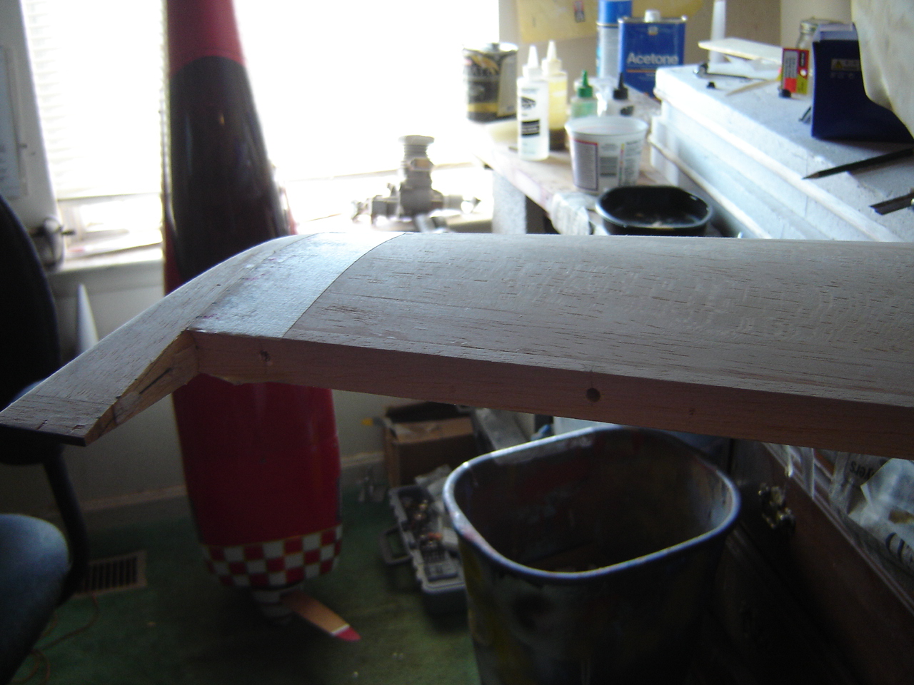

Those photos came out big at least as viewed from my P.C.
Here are a couple more pictures detailing -again-the proposed control surfaces trailing and leading edge respectively.

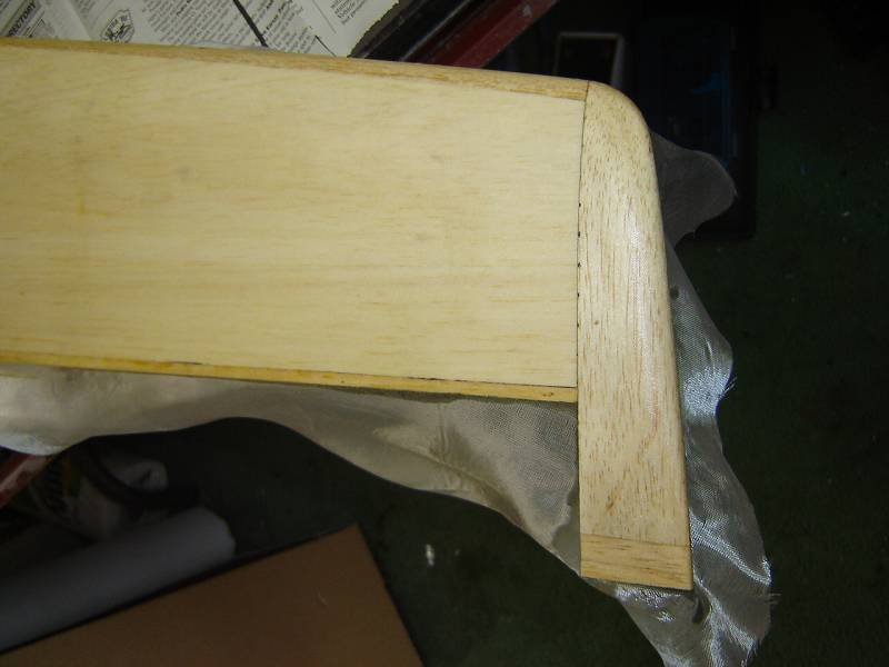

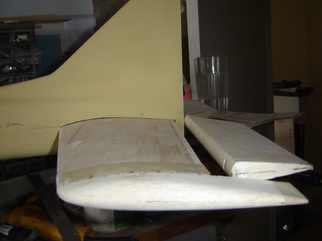

Here is the horizontal stabilizers T.E. W/the HALF round sanded in using a dowel and a piece of #80 grit having some P.E. or P.C. problems ..[:@][8D]
ID:	435905   Click image for larger version

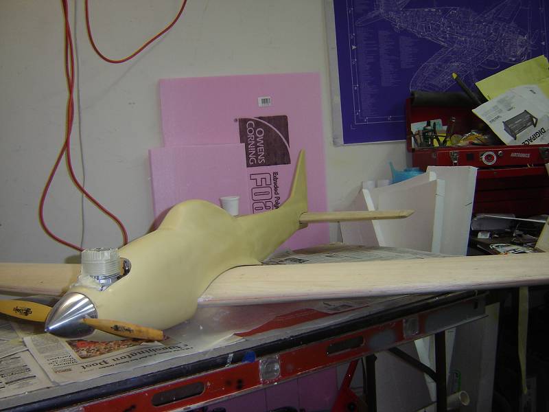

Here the stab is glassed I did a less than perfect job on it but was trying different techniques so some times no cigar I guess.
ID:	440175   Click image for larger version
ID:	440176   Click image for larger version
Old 04-06-2006 | 08:36 PM
  #83
ramcfarland's Avatar
My Feedback: (44)
Posts: 3,791
From: Waldorf , MD
Default RE: Plans or kit :Tigertail IV??

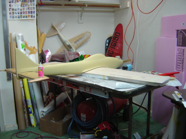

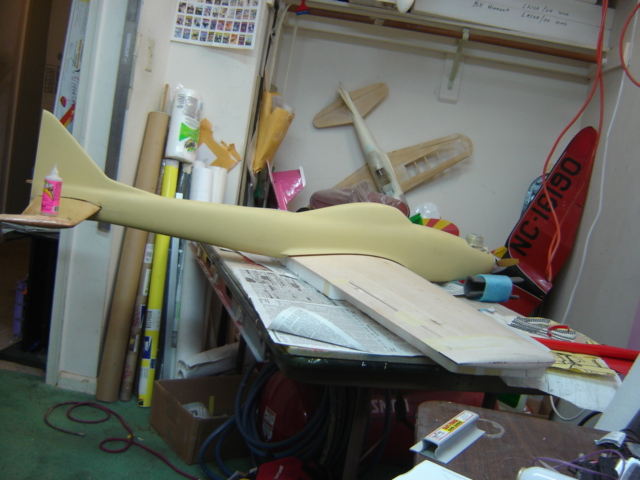

Much shimming was required as I seem to have made too large a cut out in the rear empenage in order to accommodate the horizontal stab. all is going nicely with the priming and finish sanding the stab BEFORE I align and glue in place.
The wings are to be joined next so I sat the fuselage on the wing I love the lines and simplicity of it my kind of "sport airplane."
ID:	440194   Click image for larger version
ID:	440195   Click image for larger version
ID:	440196   Click image for larger version
ID:	440197   Click image for larger version
ID:	440198   Click image for larger version

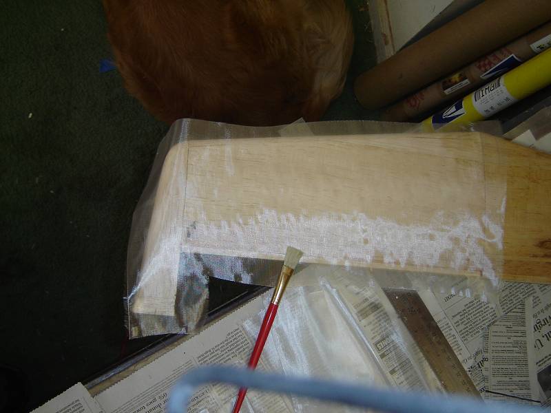

Georgia&Canada the thinned white glue pictured would it work and what about the H2Oin the thinned glue warping the outer skin..on the subject of Polyspan is it heat activated adhesive?

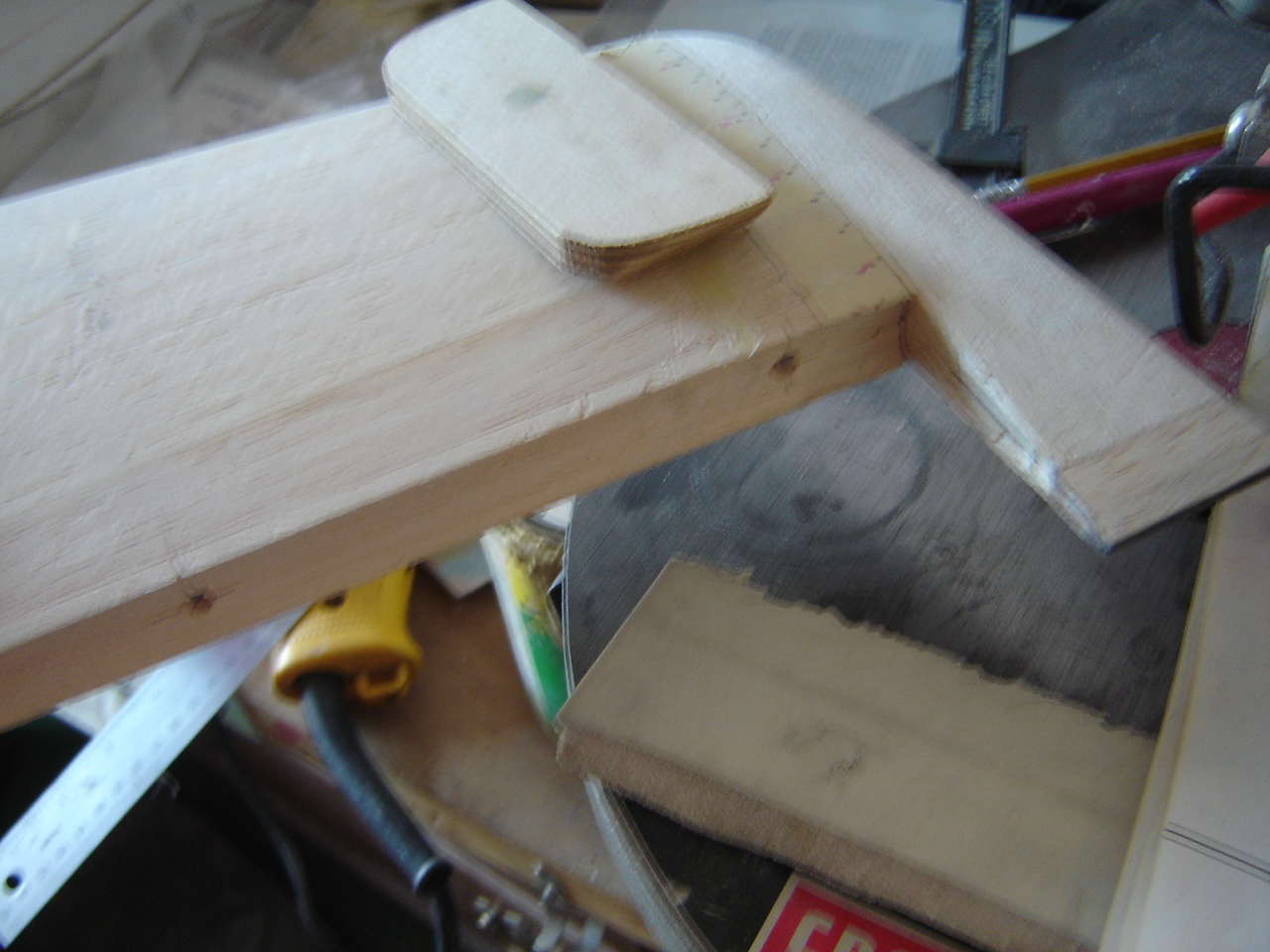

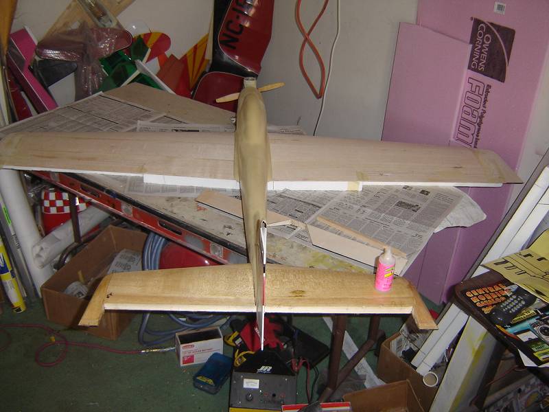

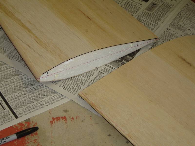

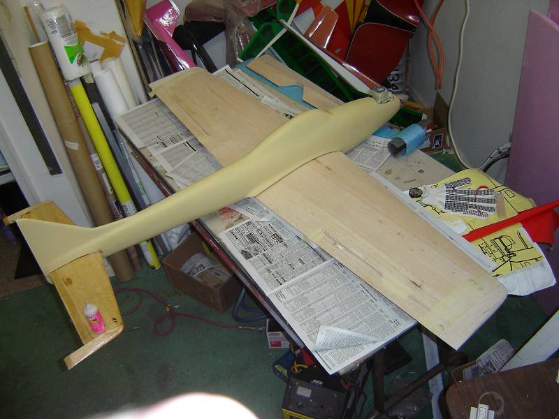

I joined the wing halves after carefully MARKING the wing bottom at the roots left and right respectivly. ..this basically allowed me to attempt"to bevel the correct angle at the root of each panel well at least I CAREFULLY blew the dust out of the foam cores before applying the 30 Min. epoxy. Once the wings were joined with the epoxy still set up I went for two canbon prods that I purcashed from Central Hobbies:the plan was to tape them in place parall with the cord line at each wing tip. but as with about half the stuff in my shop they were lost [] even a 1/16" can cause trim problems. I sure as hay hope when I re cover the alignment rods the wing will be irtually twist free (I hope[8D]
ID:	443521   Click image for larger version
ID:	443522   Click image for larger version

ORIGINAL: ramcfarland
I had a warp in the wing that I rid of with ammonia and weights. Considering the amount of deflection and how much I wetted the balsa, I am not concerned about a little thinned white glue. If so I can do it again with the weights.
Old 04-11-2006 | 04:12 PM
  #94
Joined: Apr 2005
Posts: 2,428
From: Calgary, AB, CANADA
Can't comment on the water warping the wing (I don't think it will be an issue on a foam core wing), but the polyspan can be stuck down with either Balsarite or nitrate dope. If you use the Balsarite, you put a couple of coats on the airframe and then iron it down like film. Follow that with a coat of nitrate dope around the edges to really seal it down, then shrink with a heat gun like film. When shrunk, seal with a couple coats of nitrate dope and finish with either butyrate dope or your favorite paint. If you use nitrate dope, you put it on like silkspan (except dry, not wet) with a couple coats of nitrate dope on the airframe first, then nitrate dope to stick the edges down. Then shrink and seal as above. I have used both methods and either works fine. I preferred using dope to stick it down, but it was not a big deal either way.
Mark

The wings are going fine next will glass the wing ;starting with the wing centersection,then over all wing .

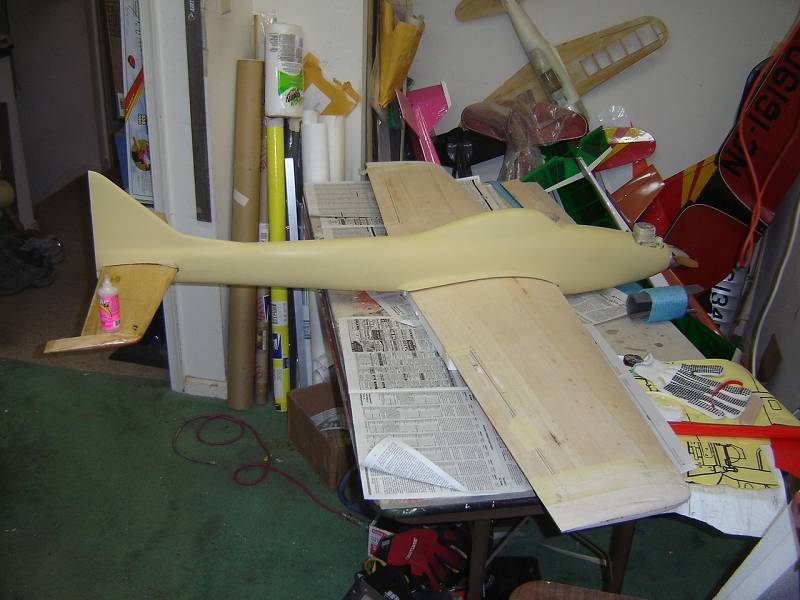

More progress will post Sunday or Monday:wings joined,with prorer dihedral of 3 1/4, rudder now constructed and wing aligned and jigged ready for drilling of bolts to retain wing. Here is a picture of it "all over the work bench
