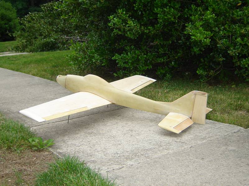

Hello 8178 here are pictures of current progress.

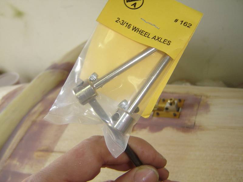

Ordered Central hobbies Carbon fiber rod with Titanium links and adjustable axles from Don's Hobby Shop for my retract struts;then just for 8178 I will do the wheel wells Geez[8D]

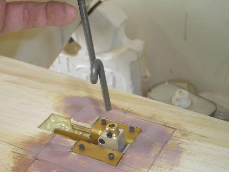

Reccd the gear strut parts and will do the retract wells ASAP[8D]

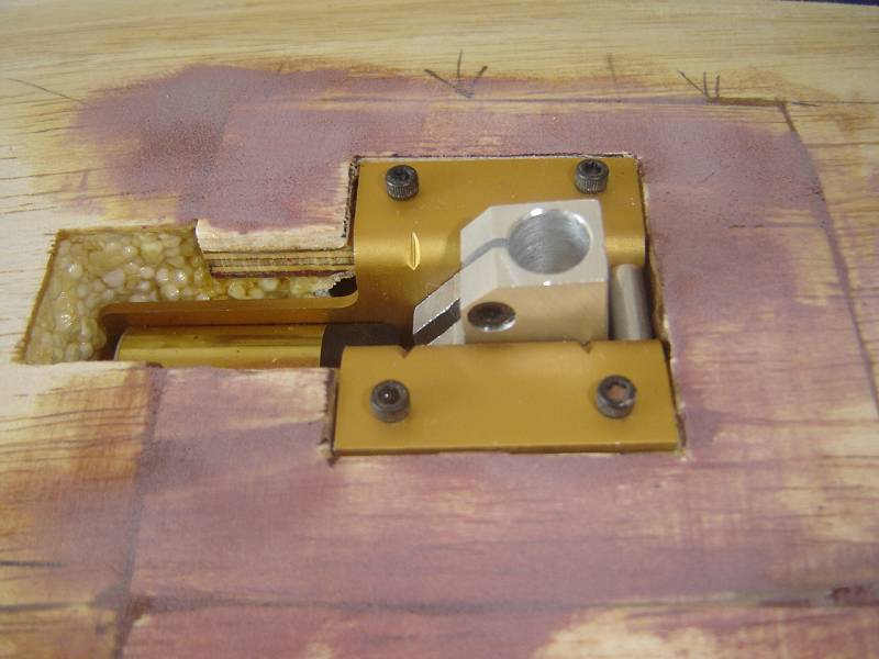

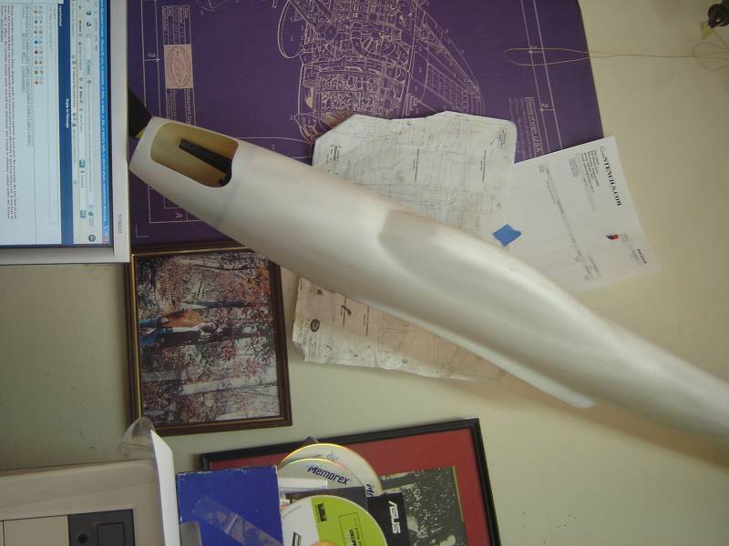

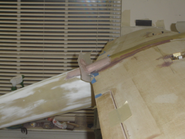

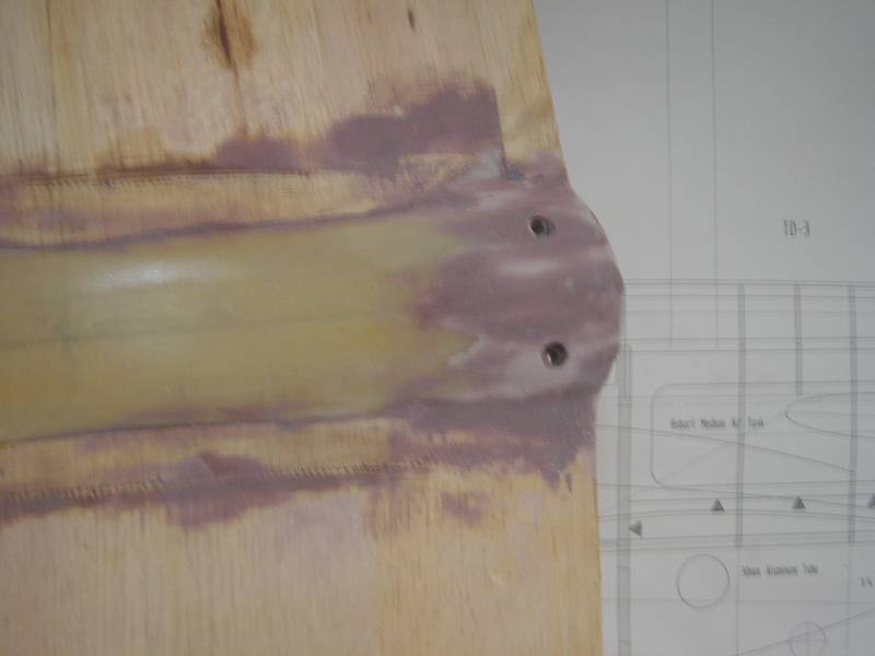

Default RE: Plans or kit :Tigertail IV??

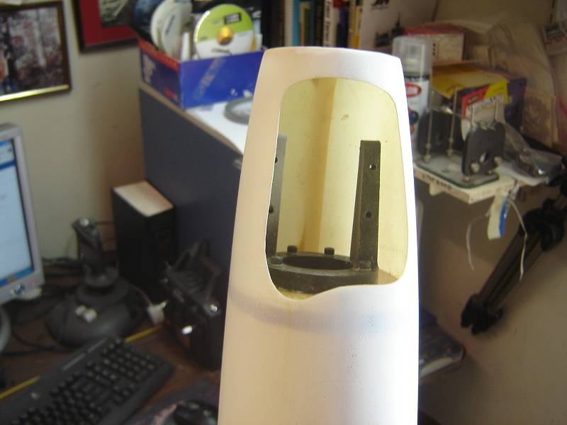

Hi every one I have an OS 120 AX on the way that I'm going to attempt to instal in the Tiger Tail !Vs' nose ,in place of the 91 FX if the 120 AX does not fit its for sale or will trade for a NEW IN BOX OS91 FX even money to you guys.
Currrently doing a bit of fitting for the aileron servo leads and the air lines. This should be fun considerind the wing is already sheeted

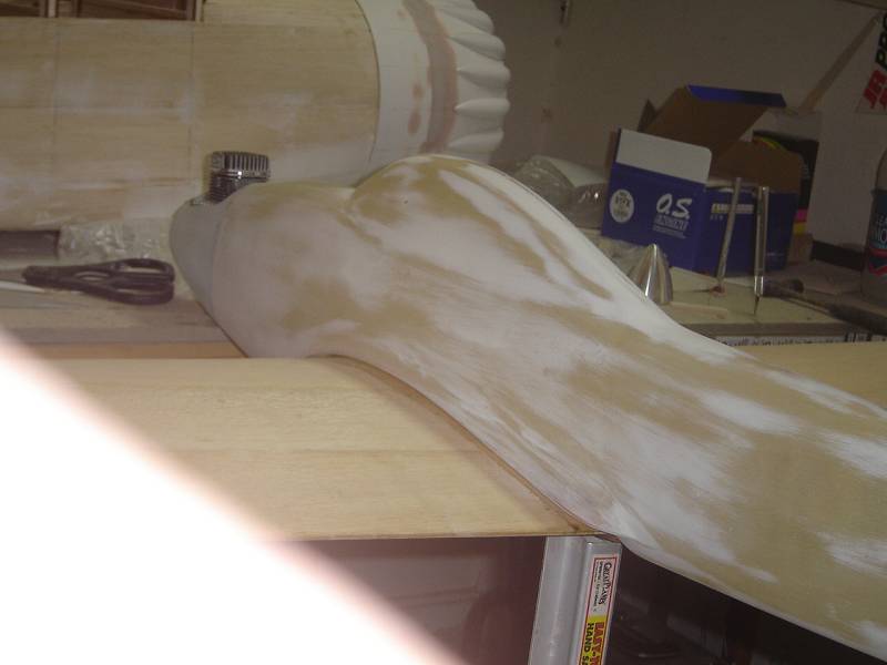

Final shaped all control surfaces now on to the belly pan ,which will require a bit of feathering with pheneloc mircro balloon filler which i have to special order these days-

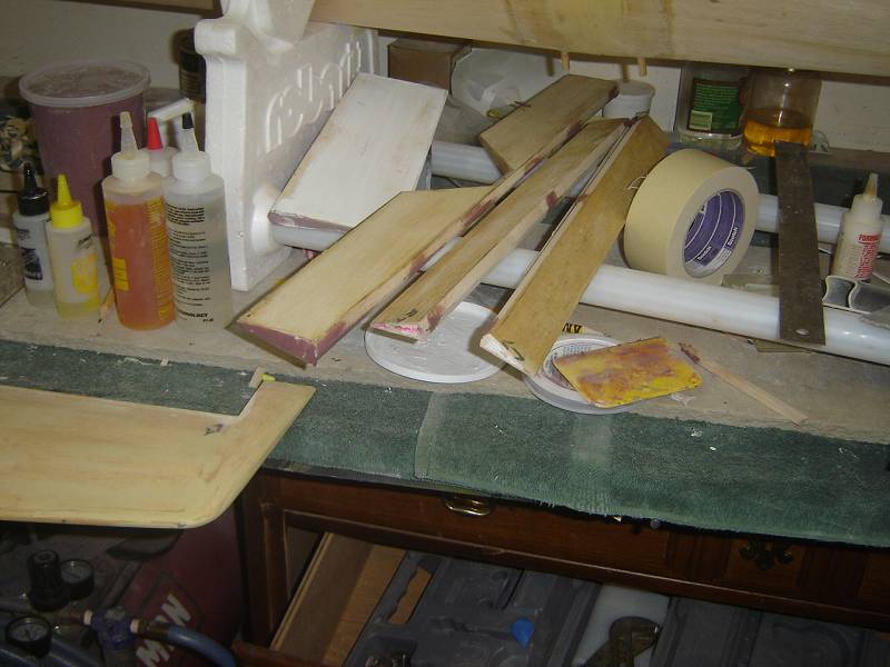

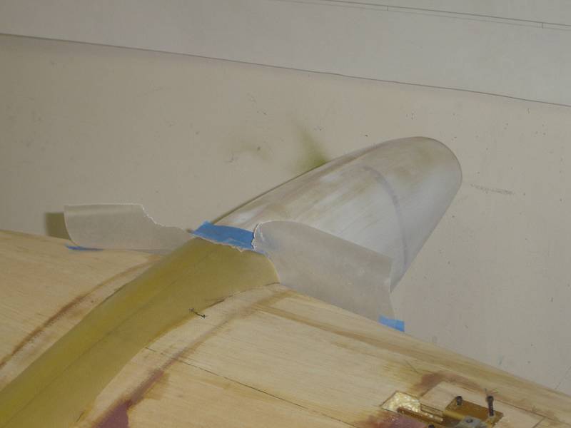

laid out the belly pan :trim and CA in position a bit of changes added "scrap" fiber glass flat sheet pieces trimmed from an earlier project (hardly ever throw any scrape out there is allways a need -
As pictured please note the 'wax paper' seperating the wing from the fuselage used when "blending in/fairing the rear fuselage wing juction. So next its out with the Zap finishing resin and (brown) fine grain Micro balloons and please note since I can not get EITHER Dave Brown or Prather Products for this quality building material I mail ordered from www.Fiberglasssupply.com

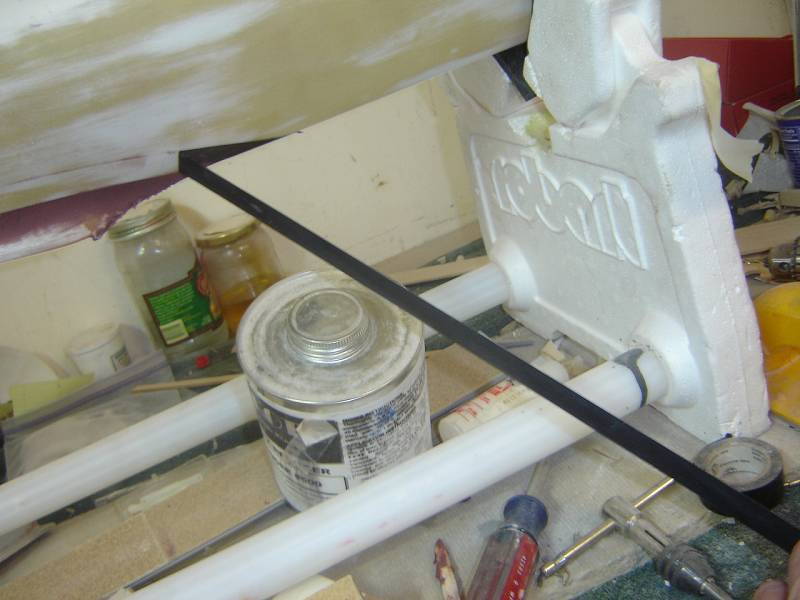

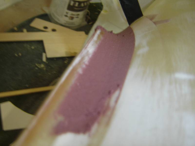

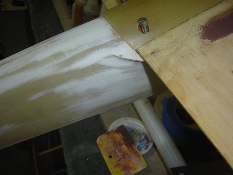

Started applying the fillet material and truth be told I could of mixed in more micro balloons but was worried about strength at this "new joint." that I'm attempting to stream line.. Love that word-

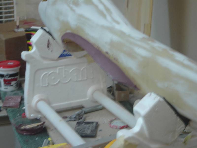

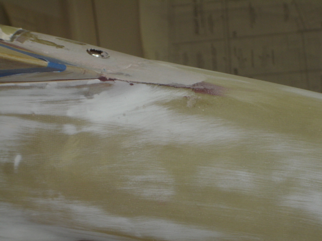

I sanded out the second skim and good thing I was on it as I had "Bondo d " the 1/4-20 SS wing bolts in place I managed to get them out as the Bondo was not FULLY CURED[X(][8D]
Well It is close one more skim coat sanding that and I will flip the bird over and work the upper fillet a bit.

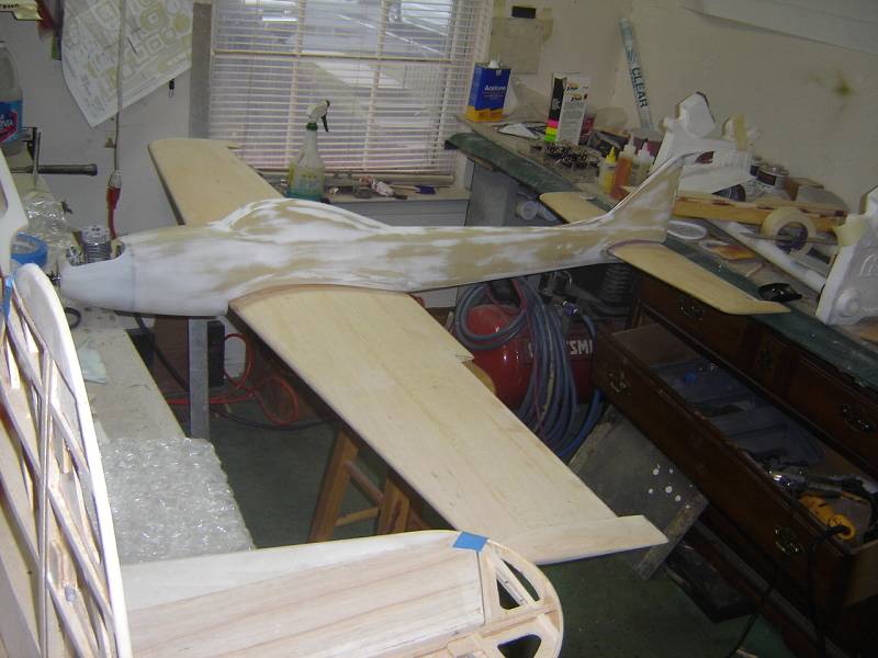

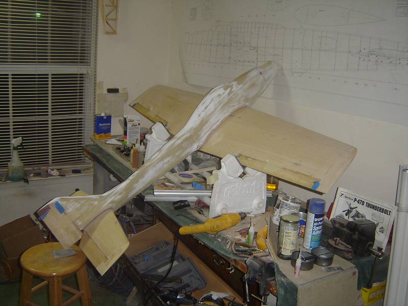

Repetition has been the order of the day: its been fill and sand with both my current projects-On this Tiger Tail getting the airframe smoothed out and ready for the next coats seems to be an end less cycle. 8D]
[/quoteSEE whada mean-

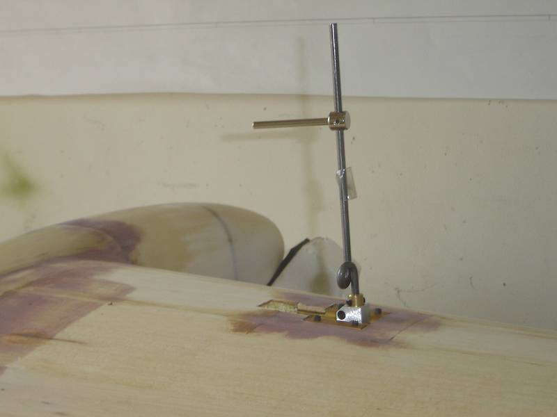

Airframe nears completion retracts and finish left to do and I'm serious about having it out this spring...it has been too long since I had the pleasure flying this semi vintage pattern ship. Semi vintage you say well-it is too young for SPA

More progress, with the wing and horizontal stabilizer fairing. Now it is time to install in wing aileron servos and I'm un decieded on which JR servos to use to get the most bang for the buck- The last Tiger Tail IV that I flew was equipt with Airtronics coreless dual BB servos and before the TTIVs demise I had added JR's then new 8611 servos on elevator and rudder and wow what a change to rudder authority and stabilization of pitch...
ID:	889256   Click image for larger version
ID:	889257   Click image for larger version
ID:	889258   Click image for larger version
Old 03-14-2008 | 05:28 PM
  #149
ramcfarland's Avatar
My Feedback: (44)
Posts: 3,791
From: Waldorf , MD
Today I recieved my set of Spring Air's 100 Series 116 85 degree 3/16" strut mains and was not disapointed. I noticed a (new to me) Control valve/Filler valve and posted a picture here along with the retracts as recieved from Spring Air.
I was all ready to bolt them new Spring Airs in place and deceided to first "have another look for any flaws on the Tiger Tails glass,foam and Balsa air frame prior to final sanding / finishing>>> and was not disapointed--
ID:	903391   Click image for larger version
Old 03-15-2008 | 02:09 PM
  #150
My Feedback: (44)
Posts: 3,791
From: Waldorf , MD
Well Spring has sprug in these parts and here I'm building and not at the field going to have to change my R/C activities, I just know the smart members of my club would be at the field- Well, I see nearly two years later(there have been other projects...)we have retracts but this time the 85 degree Spring Air units and again they are well engineered and built-] now I need 2-1/2" wheels any suggestions for this application thanks-
ID:	903976   Click image for larger version
ID:	903977   Click image for larger version
ID:	903978   Click image for larger version
ID:	903979   Click image for larger version
