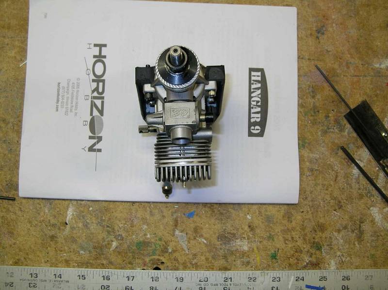

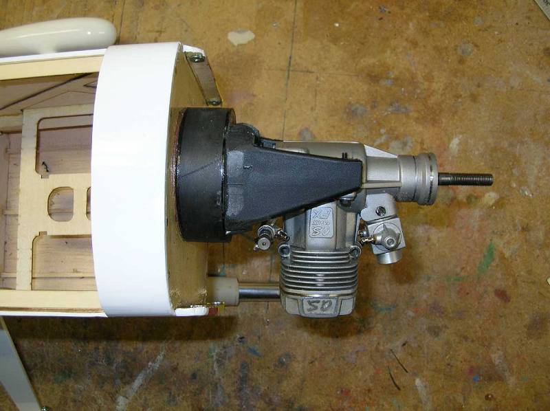

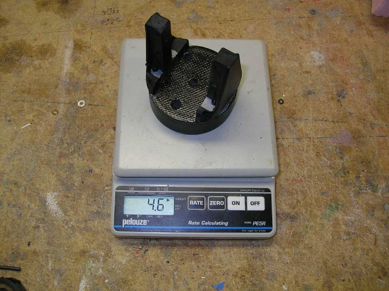

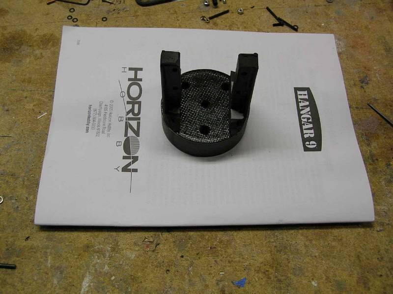

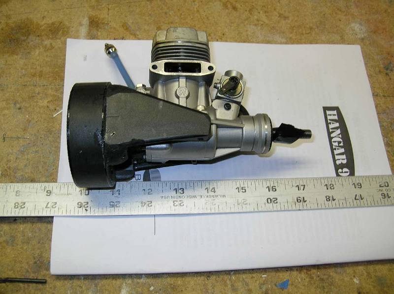

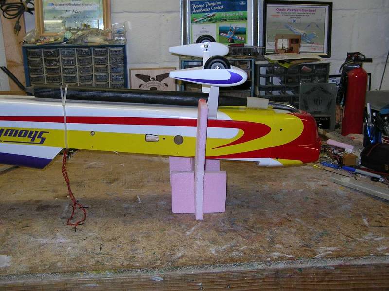

I couldn't bring myself to hard mount the engine, so here's a few pics of how I modified a Hyde A mount to fit the OS .91 going in the nose. I just used what I had, so this was originally a mount that fit an OS 1.40 RX. I cut the beam mounts supplied with the kit. Overall weight of the mount is 4.4 oz, which is acceptable I think. So this added about 2 oz from the stock beam mount weight, but I'm basically getting some of that back since this is going to have a 3 oz CF pipe to replace the 6.5 oz OS muffler Header weight is unknown, probably going to be under 2 oz and since I will use a teflon coupler system, that doesn't add enough weight to really worry about. Hopefully this will be a good setup. Thanks to Nat in La for a good deal on the ES pipe!

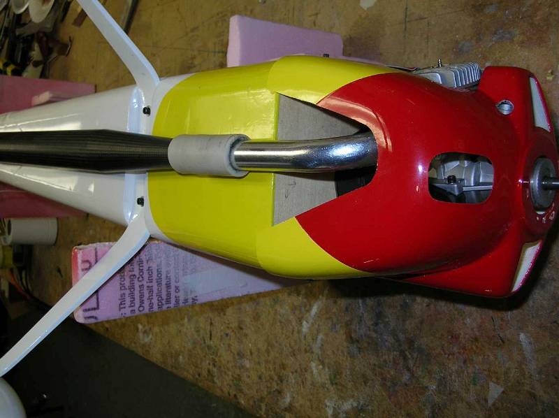

can you post a pic of the pipe installation ie.. Fuselage mod when you get a chance?

Will do. Just brought the header home tonight, will probably have it all done Sat AM.
Old 10-23-2005 | 01:33 PM

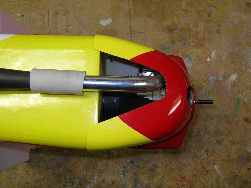

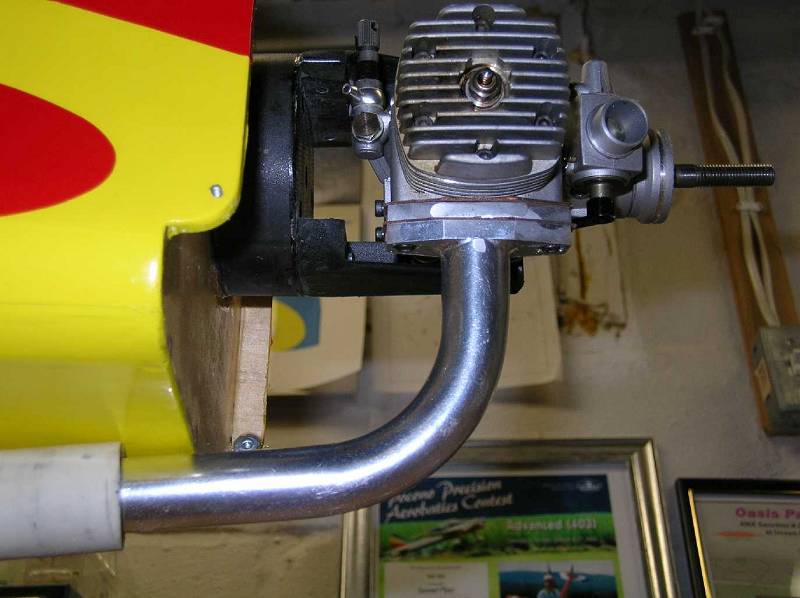

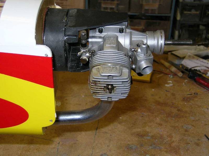

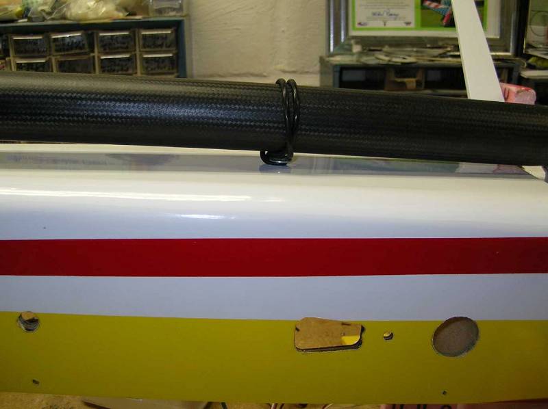

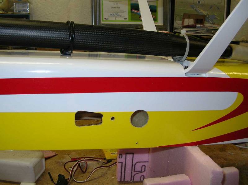

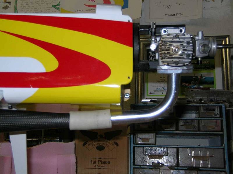

OK, I hit a snag with the header drop being short about 1/4" and got hung up making an aluminum spacer. This is why we save bent landing gear, for just such occasions when materials stock is needed. The engine ended up being rotated about 80 deg to make the header exit line up properly. Unfortunately, the head now pokes through the side, but I can live with that. Had to do a little bit of shimming behind the Hyde mount to eliminate some up and left thrust that snuck in with the new beam mounts. Must have not got the hole alignment just right. Anyway, it looks like it will work out well. Have not done the pipe mounts to the fuselage yet, that should be fairly easy. The plan is to just hang them from O-rings like I usually do, so just a few small hardpoints have to be added with a isolating spacer somewhere along the way.
This might be more trouble than it's worth, but what the heck, we'll see how it flies when the weather clears.

Did some more setting up and checked a few CG locations. With the CG just at or slightly forward of the leading edge at the tip, seemed to be just fine, or maybe just a little nose heavy, but it flew well. The other one I flew did not have a cowl and it had a light muffler setup. It felt tail heavy. This one had the balance at about 1/3 of the chord at the tip. Great for 3 D with high rate but a more optimum place is closer to the first one. .

You might run into that header breaking with the muffler that far from the rotational point of the Hyde. Even though you are after saving weight, I would insert a soft silcone coupler just after the bend before the connetion to the pipe.
Regards,

Eirc, it's a concern to be sure. I'm hoping that it may not move as much as is typical since it is using a 1.40 mount, so it won't have the same torque to bang with as what the mount is built for. Nevertheless, I may just take that precaution. It's looking like it may tend to be a little tailheavy anyway, so it would work out favorably.

Ended up doing a different type of O-ring hangar on this, mainly because there just isn't alot of structural "meat" at the fuselage bottom to make hard points for the O-rings the way I usually do. Normally, It would be using a pair of screws and washers on either side of each "hanging station", then the O-ring just goes around the pipe, with a twist or two on either side, then under the washers and snugged up. Here, I ended up making centered hard points. The aft one is designed to both suspend the pipe and to maintain some "tug" forward to keep it from sliding aft. That one is just a little eye hook to grab the ring. The other one is a screw/washer (silver soldered together) and the O-ring is double looped under it to stay put and then the pipe is slid through. Looks like it will work, but I will be grinding the head of the screws down to give more clearance and avoid wearing a hole through the pipe. This isn't exactly what I thought I would do when I started the project, but should work. I would like to see other solutions to this.
