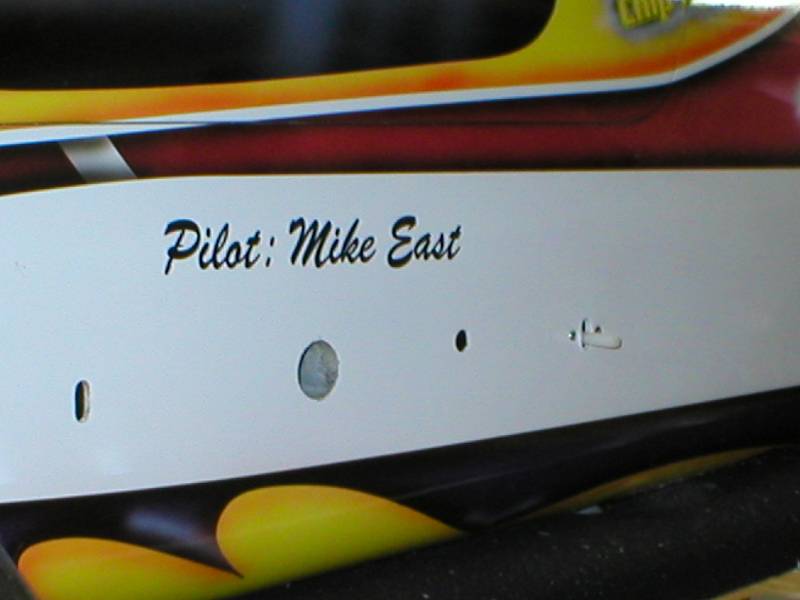

OK, today I added some insurance to the paint and about 1 ounce to the plane.
I clearcoated the lower portion of the plane with PPG DC3000.. I actually sprayed it myself and it went on thick but I had no problems. Only thing is, the "expert" at the paint store said that it could not be thinned or it would lose its shine, so we didnt thin it. It went on like molasses so there was no fear of a run whatsoever and it looks nice. Due to the thickness there is a very slight overspray that I can buff out tomorrow and it will look totally like glass,
Then we played,,,, We tested the clearcoat and thinned it with almost half DT885 thinner. We sprayed an old chin cowl and WOW it flowed beautifully and went on like glass. There was no blushing effect whatsoever, so yes,,, it can be thinned to get a lighter coat and less weight gain and it will actaully flow a lot better. I gained just under 1ounce with what I did to the chin cowl and belly of the plane. Big deal, Im still under 10lbs 4oz. [8D]

Looking good Mike, I'll bet you’re anxious to get that baby in the air!
One more thing I thought I'd mention. Did you fuel proof the inside of the pipe tunnel and the engine compartment, or does it come already fuel proofed?
The reason I ask is that sometimes the fuel can soak through the fiberglass and start eating the paint from the backside, depending on the type of paint. If they used a fuel proof paint this isn't a concern, however, I've heard people mention the paint becoming damaged around the pipe tunnel cutouts which suggests that the paint may not be fuel proof, but the clear coat over the paint is fuel proof.
If the pipe tunnel and engine compartment are not fuel proofed this can be done very weight economically by using 30-minute epoxy and cutting it 50/50 with acetone or denatured alcohol. This thins the epoxy significantly and makes it very runny. You can then brush the mixture on and the alcohol or acetone will evaporate off and you're left with a very very thin layer of epoxy that will fuel proof your fiberglass.
To get down the pipe tunnel I use a dowel with an epoxy brush taped to the end.
Keith Black

By the way, Keith I took your advice and fuelproofed the inside of the pipe tunnel, chin cowl and cowl. Probably didnt add another 1/2 oz. Looks nice too...
Thanks friend for your helpful input, you probably have saved the paint job.
