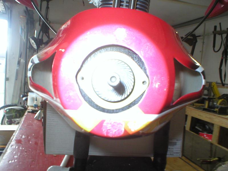

Old 11-14-2005 | 02:52 PM
  #80
MikeEast's Avatar
Joined: Oct 2003
Posts: 3,246
From: Nederland, TX
Default RE: Genesis ARF build, its here.
My proudest moment as a new builder.
I realize this is the way it SHOULD be, but it really intimidated me. I was able to get the nose ring and motor mount in dead on center. The motor is sitting flush on the mount without the motor screws tightened, and fits perfectly through the nose ring with zero bind on the nose ring. I just knew I would end up needing to tweek the engine into the nose ring just a little. As it is if the firewall was installed on the right angle I should have the right angle of thrust. [8D]
Also just a reminder, this was all fit up with a 1.40 Sport. I have been told by everyone that has handled a 1.60DZ that it is a drop in replacement for the 1.40s. Im still not suposed to be getting the 1.60 in for about 2 weeks. I could go ahead and fly it with my sport but I think Im going to be patient and wait on it...

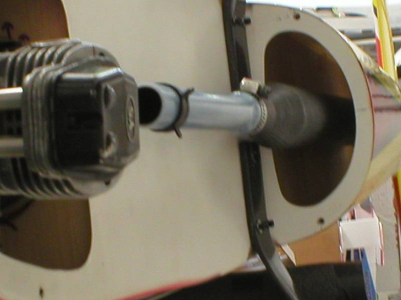

Old 11-14-2005 | 04:31 PM
  #81
MikeEast's Avatar
Joined: Oct 2003
Posts: 3,246
From: Nederland, TX
OK, here we go. The epoxy needs to cure but the motor mount and nose ring assembly are ready to go and fit great.
Here are some decent pics from the yard this afternoon.
Heres what is left.
Install the header, muffler and throttle servo.
Install the fuel tank, switch, and receiver.
Set the indicence in the stabs and wings.
Oh yeah, and install the retaining screws to hold the stabs on. I will not be entrusting the incidence adjustment screws to hold the stabs on.
One point of interest I thought I would mention. The fuselage is VERY thin and VREY soft. This plane wont be able to take much hangar rash. The balsa for the wings and stabs and the fuselage will dent easily. Im going to have to become like my friend Glen Watson and only allow folks to carry out my plane with their rings on their fingers off...
