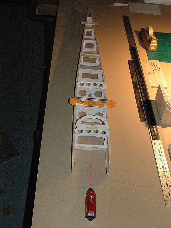

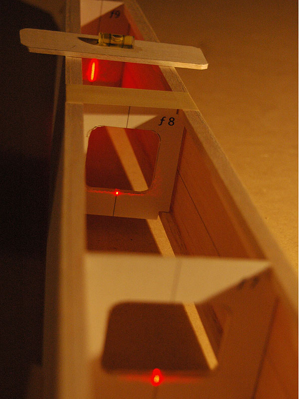

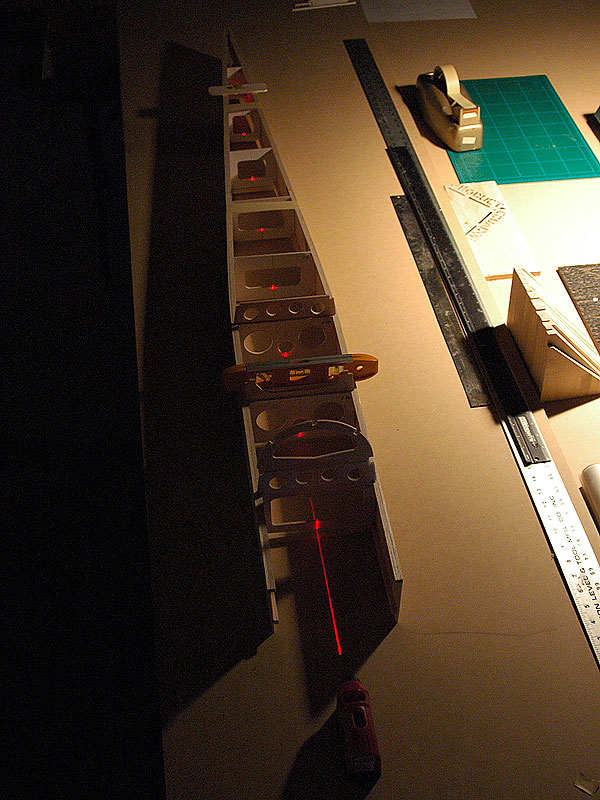

Taped Fuse Mockup ---- On the final jig setup there will be a top laser
It was real easy to tape this fuse together, and make it very straight ; ) I think I may knock out at least one more fuse box while I am waiting on my Radio South order, I don't have my wing tubes yet, they have been backordered fro 2 weeks.... So I can't do much with the wings, my sheeting is already edge glued and waiting in the press - thanks to Jim I.
I've got a pile of really nice light wood, I am going to build a real light one next, this fuse is at 7.5 oz and the fire wall is at 3 oz. untrimed -- so this fuse box hits 10.25+-
This is my heaver wood, I've got lighter 1/8 sheet and lighter stringers. we will see....
The former fit is ahhh, really nice, and it's only taped .. : )

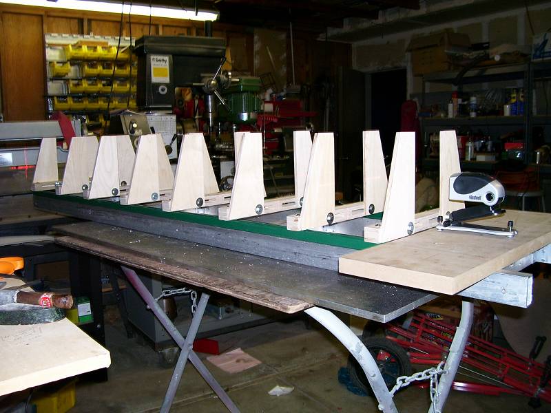

<snip>. . it's a Bushnell PivotPoint laser level #82897 available at your local Radio Shack just like Hangglider said, for $15.00., . . <snip>. .
Oh come on. . . how straight can a laser line be for $15.00?? Buy cheap buy twice!!!

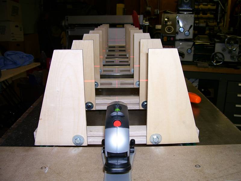

Oh Keith of little faith.
That's what's cool about this little cheapo laser, it's perfectly suitalble for this application. The lines it shoots are perfectly straight, once the photons are emited they have to go straight unless they are refracted or reflected. First you build a straight and square jig on a perfectly flat surface, then align the laser to the jig (that's what the adjusment knobs are for), locate your fuse formers with the vertical target lines in the jig and turn on the laser. When your targets line up with the laser- you're good to go. Simple, fast, accurate and cheap! Go to Radio Shack and check em out.
Believe my brother.

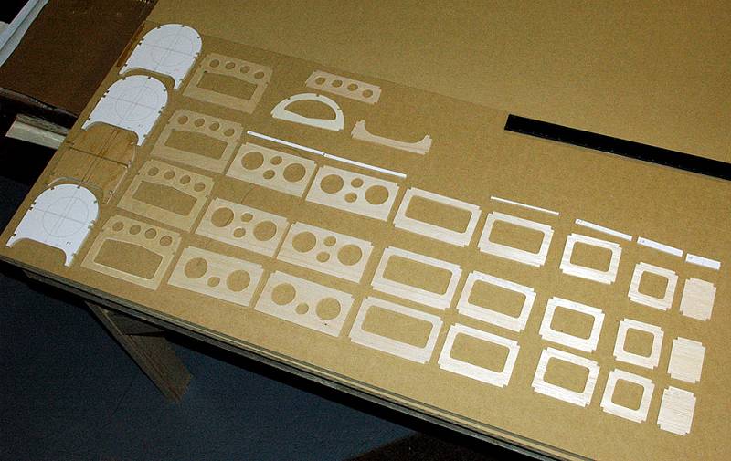

Hi All,
Been busy hand cutting 4 former sets, I've decided that I am going to build 4 fuses right off the bat....
One for each power plant option, I am going to build a 4C glow for my YS DZ 140, a gas version for the ZDZ 40, a 2C version for either the OS 140 or 160, and a super light electric fuse.
So what I am doing is cutting FOUR fuse "kits", then once I get weights on all the parts, I'll put all the lightest parts in the electric fuse. I have been playing around with different firewall options and F2 options. So I am hoping to be able to have one super light fuse.
I will be building fuse sides and tail blocks tonight.
