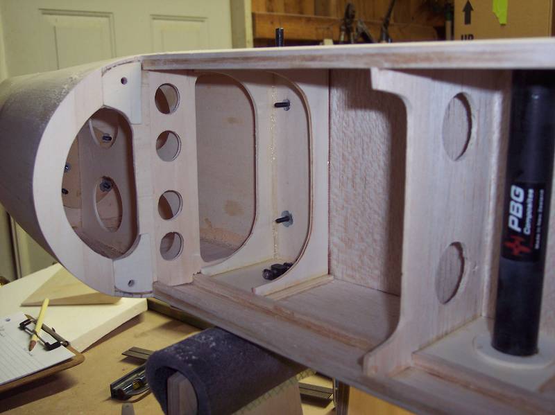

Critical Update: Gear block
Ok, this one is bugging me. I flew my own V2 well over 1000 flights before the infamous regulator failure, with no noticable wear and tear on the gear block. I DID tear mine out at Tangerine last December, but after seeing what I hit turning off the runway, it didn't strike me as an issue.
This year after seeing all of the Black Magics belonging to others, it's easier to count the ones that have NOT torn out the gear block. I believe that's evidence enough to classify this one as a weakness that needs to be addressed.
The VF3s already incorporated more structure for this, and are being updated to tie into the gear block and D1 doubler as a slotted fit.
I don't have a V2 to demonstrate, but what needs to be done is make a small half former at the rear of the gear plate, tying into the D1 doubler. This does not have to be large, ony about 1/4" tall at the middle, flaring up the sides to about an inch tall at the sides. Also it may be a good idea to make a triangular gusset piece at the front further anchoring the front of the gear plate to F2. This is critical if you plan to fly off grass.
I will try to make adrawing later to make it clear.

I concur with what Mike says about bracing the gear plate if you're flying off of grass. I tore mine out in my first airplane and since I braced it there hasn't been any problems.
Below is a pic of the inside of the fuse just for orientation purposes the nose of the airplane is to the left. The gear brace is just fore and aft of the wing adjusters. If anyone needs more detailed pics let me know and I'll get what you need.

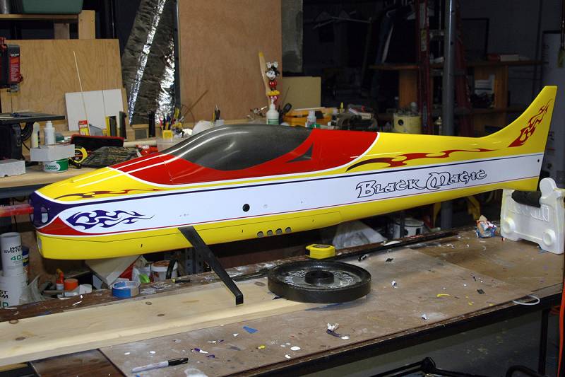

Just had to post a pic of my v2.2 that I started over a year ago. I think my first post of this plane was on page 6 of this thread. I finished all the base coats, I'll be airbrushing some more color and clear coat. The plane is coming out really light, the fully finished fuse with the bolly L/G is at 51 1/4 oz. My finished wing cores are 10 1/4 each. I might be converting this plane to electric, it's now set up for a DZ. It should be under 10 lbs with DZ.

It's DCC True Red, it's been sanded and will be getting clear. I've got med plum, yellow, true red and white on her so far. I have orange, black, gray, and silver to go on next.

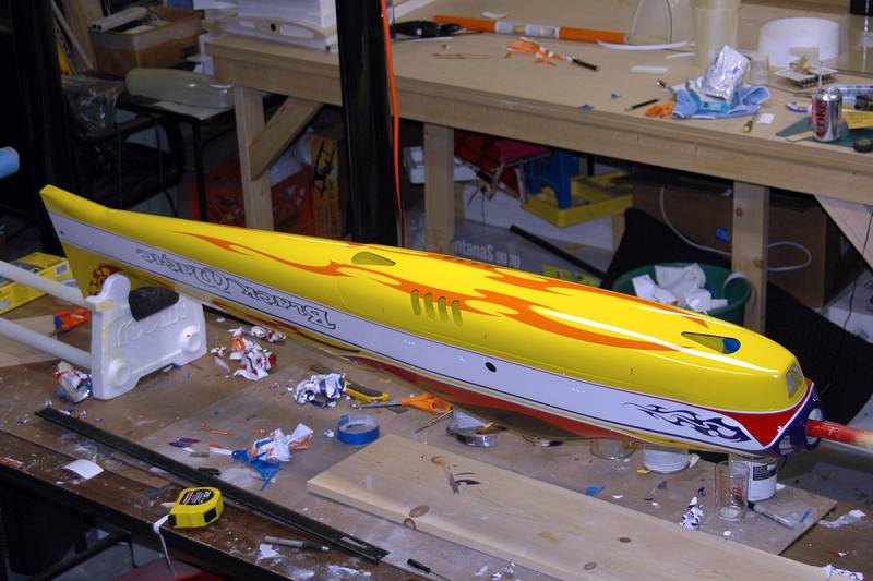

Default RE: Black Magic v2 builder's thread! *Updated*
A few peeks
Got some trim color on the plane. Still have to trim the canopy and clear. Been enjoying my custom iwata airbrush. I'll be doing more color, I guess I am not in to big of a rush anyhow.
the hummers are right out side my shop.
enjoy!

wow, I just looked at the photos I uploaded, it really seems like RCU uses a lot of image compression on their server. the orange and reds looks bad on these pages.

Dean,
Did you use paint mask cut on your vinyl cutter for that or was it a few rolls of fineline and freehand?
I like the way the red shows up in the pics; has a translucent quality.

Wow thanks all, glad you guys are as crazy about this stuff as I am. Thanks for all the nice comments ALL!
I've got the second level of trim kinda designed in my head for the plane and the canopy trim to do. I am shooting silver met. and more color and more shading next.
I am just glad you all like the work I am doing. It's all about practice, practice, practice - flying or painting.
I did all the tribal flame work with cut spray masks, the rest 3m blue tape. The Iwata Custom brush is amazing and the Sata minjet just freaking rocks. The amazing thing about all this is - with the right tools it's super easy, just time consuming. It's all about prep. This is all solid DCC color. I haven't shot my pearls on her yet.
The next big step for me is to cut all the monokote for the wings and stabs on my cutter, so far all my test prove my machine does it well. I'll be able to do all the color curvy wing designs and cut it so it overlaps only at the edges. It will be nice because I'll be able to design the entire wing and stab schemes on my computer and just hit "CUT"
Just glad I am getting this kind of feedback, thanks!

what I noticed with the clear is you have to reduce it a lot ( i do 50% with reducer) and then shot it with the lowest pressure - to minimize overspray. It it's smooth but not shinny it could be because of overspray.
and thanks.....
