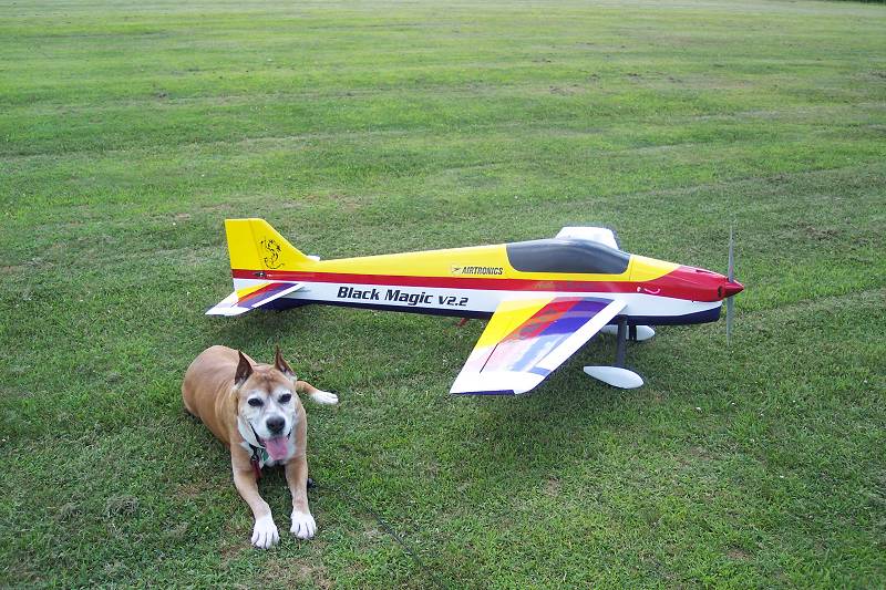

Finally, done! A month late and 3 oz over my goal but I am very happy. I have a lot to learn about 'glassing and finishing but it looks good at a couple of steps.
OS 1.40
APC 18.1*10
Airtronics Radio gear
PPG Deltron and Monokote
10lbs 3 oz (w/ a big Nicad, tall gear, 3" wheels, etc could knock about 6oz out with out a lot of trouble)
Flies very light! Nice pace and very smooth. Only two flights today and I have a little trimming ahead of me but boy is nice to have something that flies so light. Rudder is very effective. Good stall turns. No real roll couple but pulls a little to the gear. I will tune that out very soon. Pulls a little to the canopy on down lines. CG is just at the leading edge of the tube and still playing with it.

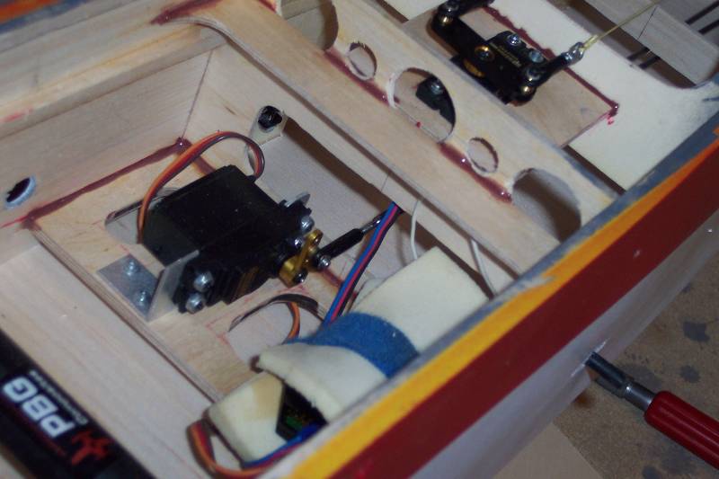

Different approach to elevator mounting. Added a half former on the gear plate to help with the velcro that grows at my field. Also, got a neat tank idea from Jim Quinn. Will have to get some pics of that.

DAMN that's a good looking airplane, Anthony!!!

Hi Anthony
that looks very good
I hope you get plenty flights before the Nats ,
either way your going to look good

Sweet Anthony!!! That looks really good!

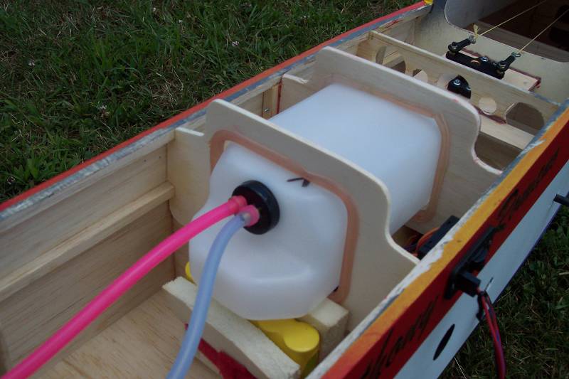

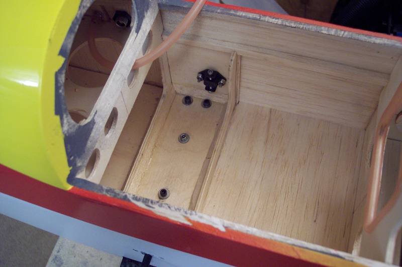

Moved the Cg forward and everything is getting better! My first real KE loop today without a lot of effort. Mix will be small. Snaps and spins stop very well. Better feel inverted. All the effort was definately worth it! Thanks Mike!
Pics of tank mount. Second former is removable for access. Needs a little more thought because there is a small amout of fore and aft movement.

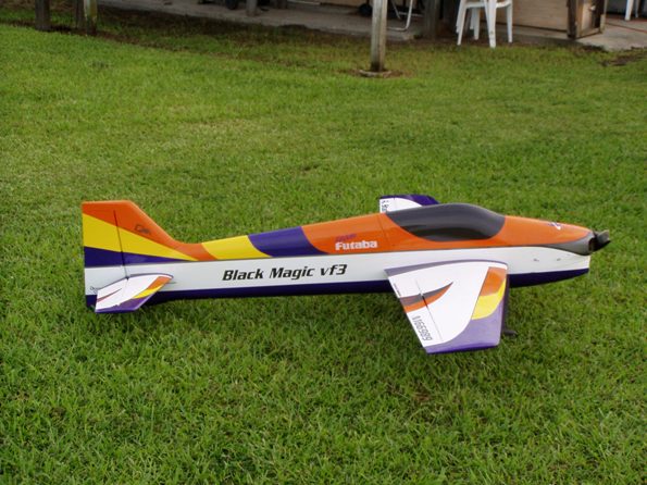

Guys..there are some new pics of the first glassed and painted VF3 in the new VF3 forum. Flight reports on Tuesday..here's a sneak peek...

excuse me Arch, I did the first, you got the second glassed and painted vf3

Arch's flew first though

Its not officially an airplane til it leaves the ground Right now it is a really cool looking paper weight

Anthony's BM v2.2 has left the ground quite a few times now. Got some photos of his beautiful machine when he was practicing his routines last week. Wow, what a great design, Mike!

Looks great, I can't wait to see it in action next week!
