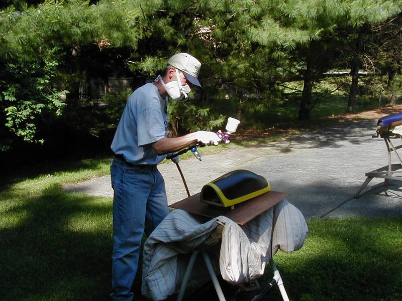

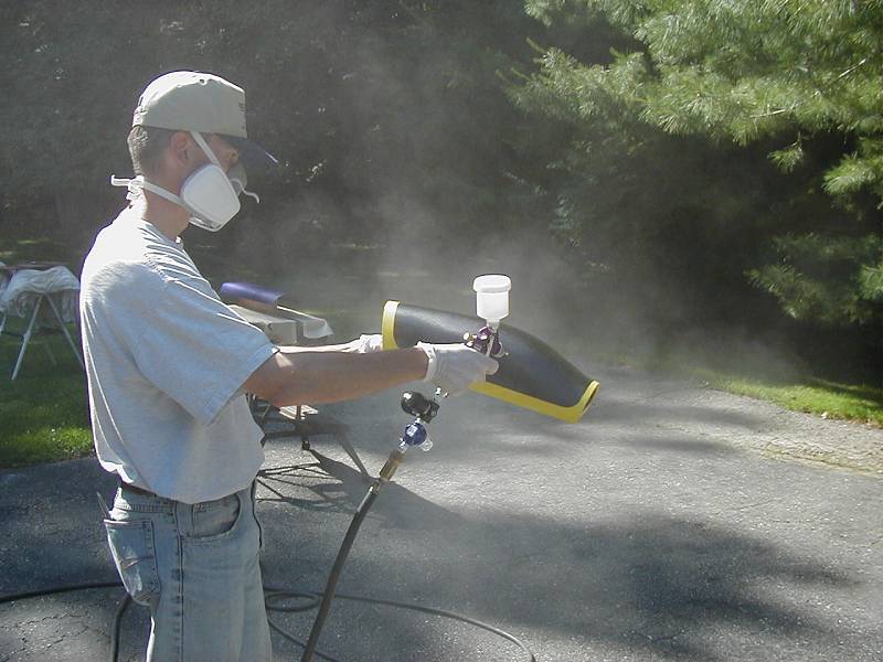

Finally, some progress still tons to do. How many weeks untill the Nats? Checksix volunteered his spray gear and yard. Now that is a friend.

Old 06-16-2007 | 07:46 PM
  #1196
Joined: Mar 2006
Posts: 217
From: Guntersville, AL
Default RE: Black Magic v2 builder's thread! *Updated*
Just don't let the E.P.A. see the third piture. They would have a feild day with someone, HAHA.
