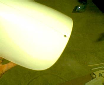

As someone suggested in an earlier forum, I drilled four holes in the bottom of the fuselage so one can get in and tighten up the landing gear (or check them while at the field with the plane assembled) simply by inserting the ball driver up fromt the bottom of the fuselage (if you look at the previous pictures, you can see the four small holes.
As you notice there are only four holes. I took the inside hole off of the metal landing gear leg, so I'm only using two screws per leg. Basically its a diagonal cut which between the metal removed and one less screw and blind nut, took about .4 oz off of each leg. Blind nuts will go in on the top part of the 1/4 inch ply landing gear plate.

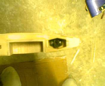

Here are the pictures of the engine mount setup. Note that the Hyde mount is off set so that the top of the cylinder is rotated 1/2 inch away from the exhaust port. If you are running YS, this provides the extra clearance so you don't have to put an opening on the side of the chin cowl for header clearance.

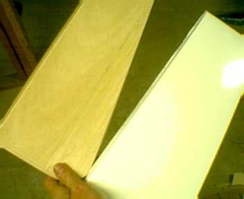

After looking at how clean and beautiful the rudder was, I had second thoughts about the build-up rudder. I though about if for a few more seconds and then the 2 or so ounces in weight savings came to mind. The exacto knife took the rudder off with one cut. I carved the fuselage sides back to the balsa vertical piece and then sanded it straight with a block and some 80 grit sandpaper. Pictures so the remains and the new tailpost.

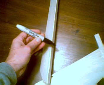

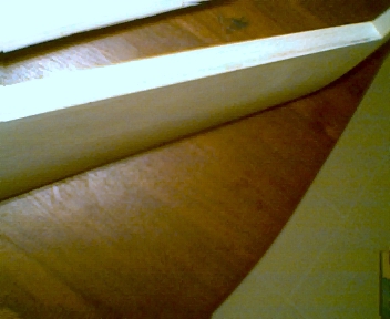

Scott, if you are considering electric, I would recommend the Carbon/Kevlar version. Danny took a lot of weight out of the plane and his in electric form.

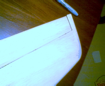

Hinging control surfaces. There has been some written on this already, but here are the steps.
First, sand about a 1/8 inch top bevel on the aileron and elevator leading edges. See photo. This gives a little extra bite on the hinge and also provides a nice looking hinge line.

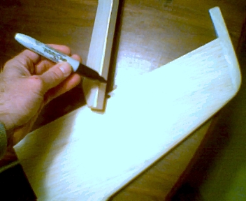

Next use a marker and mark where the hinges will be. I put them basically 4 inches apart on both the ailerons and the elevators. Next use the marker and blacken the sharp corner of the bevel, then carefully position the elevator or aileron up against the stab or wing, and press the surface against the stab or wing. This leave little lines which tell you exactly where to put the hinge slot.

Old 01-16-2006 | 11:38 PM
Don Szczur's Avatar
Posts: 2,177
Received 16 Likes on 15 Posts
From: Chantilly, VA
Default RE: BRIO Construction by the numbers

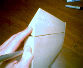

The marks that transfer over are just a little more than an eighth of an inch down from the top. Use an exacto knife to cut the hinge slit, and then slip in the CA hinges. Done!

Old 01-16-2006 | 11:42 PM
Don Szczur's Avatar
Posts: 2,177
From: Chantilly, VA
Final step is to sand the control surfaces so they blend in with the wing surface, trailing edge of the wing and wing tip to get a perfect match. Mark down where the slots are so after its covered, it will be easy finding the slots to glue on the control surfaces. I make mine 1 inch in from each end of the surface and then spaced 4 inches between hinges. This puts 6 in each aileron and 4 in each elevator.

From: Chantilly, VA
Next cut a slot in the front part of the fusleage where the canopy fits on, and notch a place for the canopy front. Glue in 1/8 ply piece on the canopy. Make sure you go just a little past the center fiberglass tape on either side. This will prevent the canopy (paint) from cracking at the corner of the cutout.
ID:	390559   Click image for larger version

Drill a hole through the center, and then mark where the hole/screw meets the tab. Make sure the tab is long enough/positioned right so you have enough material for the blind nut on the tab. Drill though, then drill a little larger hole so the blind nut fits in. Put the blind nut in just a little, put the canopy on and tighten half way to make sure the threads catch. Take the canopy off, put three little drops of CA on the blind nut tabs, put the canopy back on and tighten the canopy screw all the way.
The Ply tab on the fuselage side should be mounted parallell to the outside surface of the canopy, so that the blind nut generally is perpendicular to the canopy mounting screw.
Finally, drill through the top (countersink) the canopy hole so it fits the head of the nut flush with the canopy surface. Push in a small #4 lock washer, and a drop of thin CA to secure it. This will prevent the screw head from pulling its way all the way through the canopy over time.
ID:	390562   Click image for larger version
ID:	390563   Click image for larger version
ID:	390564   Click image for larger version

If you find that when you tighten the canopy, it distorts slightly, then just add a thin (1/32 or less is normally all that is needed) shim on the canopy side so that the two mating surfaces are flush when the screw is tightened.
