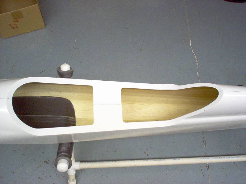

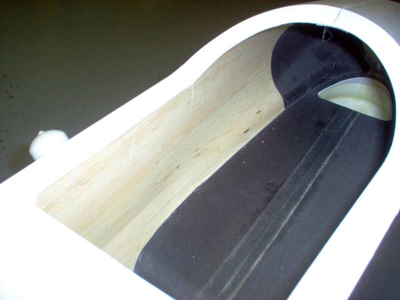

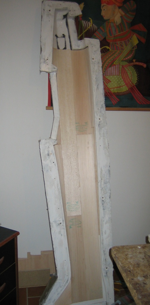

The layup consists of the following.
Primer sprayed in the mold is PPG epoxy primer
1st: 2oz glass cloth from tail post to nose ring. (this may be a little heavy and is why my weights are what they are)
4oz around the canpy hatch flange area to back up the 2oz
3.5oz carbon from in front of the canopy to the nose ring
2nd layer of 3.5oz carbon from where the balsa ends to the nose ring (the balsa overlapse the 2nd layer an inch or two)
2nd: lay the wood (1/32nd balsa) in that has been bagged and preformed in the mold prior to layup.
3rd: 1.4oz glass over the balsa (another area that may be a little heavy)
4th: cover all with peel ply and release film, then breather cloth.
5th: get it in the bag and "hope for the best"
Layup time is about 2.5 hours fuse side...
These materials produce a fuselage stiff enough a interior crutch isn't needed. If anyone has any input on what other glass/balsa laminates are made from, it would be great to know. I'm always looking for ways to improve!!
John Konnecker has asked that I write an article with pictures for the Kfactor. I wanted to get my weights and technique down before I do this. It's getting closer, hopefully I can do this for John soon!
Todd

The quality and workmanship shown in the interior shots of the fuse is as fine as I have ever seen.

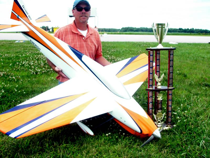

For folks that aren't aware of it Todd's Defiant won the Concours D'Elegance at the 2008 Nationals.

Gosh, thanks for comments, the concours was a cool experience and was a lot of fun. Mike Hester does a great job on the event. Check out the trophy he had made. It was fun watching Steve Ford try and figure out how to get it home with all the rest of the stuff.

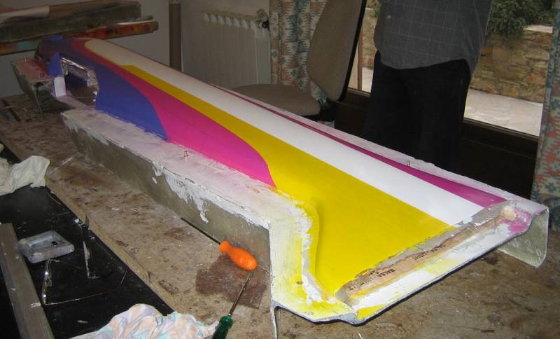

"If anyone has any input on what other glass/balsa laminates are made from, it would be great to know. I'm always looking for ways to improve!! "
I asked friend of mine Yves Gabelli who does his own planes with glass/balsa laminates (fuses, wings and stab).
He wrote me his method :

Your friend Yves does a beautifull job too. Do you know how he masks in the mold? Tape will not stick to good releases like Zyvax or it will pull off PVA.

I asked Yves.
He uses masking tapes fronm STDS
http://www.stds.fr/boutique/liste_pr...g=lg_fr&num=10
He uses polyurethan paints. For masking he uses 3M or Edge tapes. Just before painting, he presses on tapes.
It's better to be two guys to do that.
Claude

Hi Todd
I'm building a new one. Building is a mix of traditional (balsa) and modern (composite) technical.
Wings and stab are made in balsa. Fuse is made of light balsa sheets 2mm and glasscloth with epoxy resin.
Glasscloth is put on the internal balsa pieces then pieces are glued together. When fuse is totally assembled, it is covered with 50 g glasscloth. Somes pics of my new one. I'm waiting good wheather to do the first flight.
Claude
I will post pics this evening because there is problem to upload files
