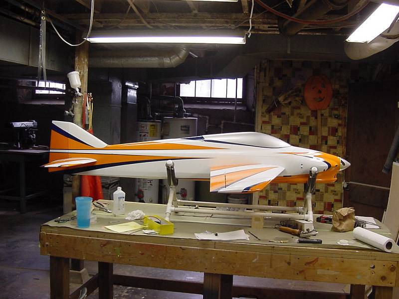

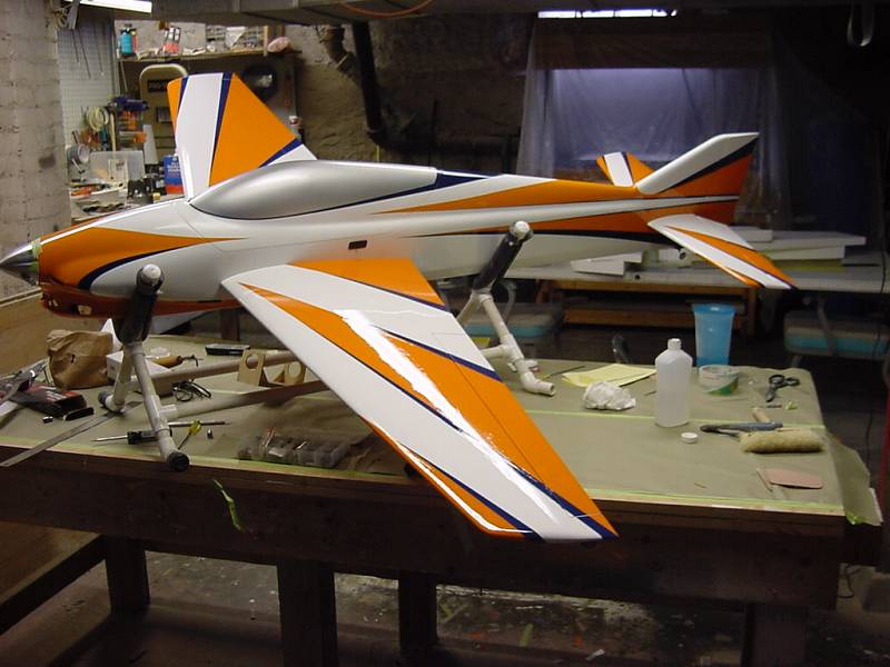

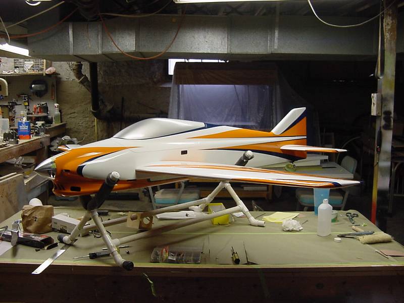

Old 12-02-2006 | 11:39 AM
  #104
Joined: Dec 2002
Posts: 376
From: Fort Scott, KS,
Default RE: Defiant MKII
Hello Claude!
I've been busy putting a few kits together for some friends. I'm planning to build another myself after these kits are delivered. My friends should take delivery before Christmas (I hope!) .
Todd

Todd,
From what I can see, that is some absoultely immaculate work! What are the weights of the fuses including canopy and chin cowl now?
Old 12-02-2006 | 05:20 PM
  #106
Julius-Alexander's Avatar
Joined: Oct 2006
Posts: 18
From: Apopka, FL
What do we have to do to be your friend?
Great design and amazing handcrafted job.
Old 12-02-2006 | 05:55 PM
  #107
Joined: Dec 2002
Posts: 376
Hello Ryan,
The total fuse in the picture comes to 32oz. Heavier than I'd like, but still should be able to be built to around 10.5 pounds. I believe a lot of the weight I'm getting is from the PPG primer I'm using. I made a chin cowl, same layup, one primed in the mold and one unprimed. Difference in weight is about .75oz. While building my first fuse, I found blocking out the fuse saved about 2oz, and more primer could have come off.

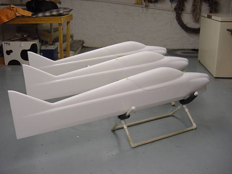

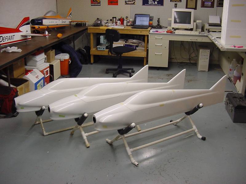

Old 12-20-2006 | 08:43 PM
  #111
Joined: Dec 2002
Posts: 376
Three hatchlings ready to go to their new homes this week. Hopefully they'll be full grown birds by season start!
Merry Christmas Joe, Jerry, and Chris!!!!

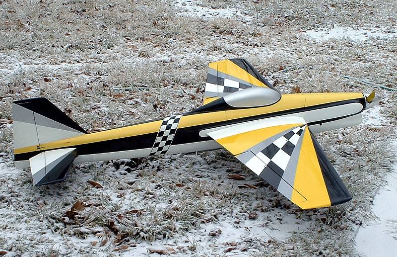

Old 01-06-2007 | 12:28 PM
  #116
DMUCOP's Avatar
Posts: 224
From: KANSAS CITY, MO
Hey Todd do you know any one who would like to buy one of your Defiants?

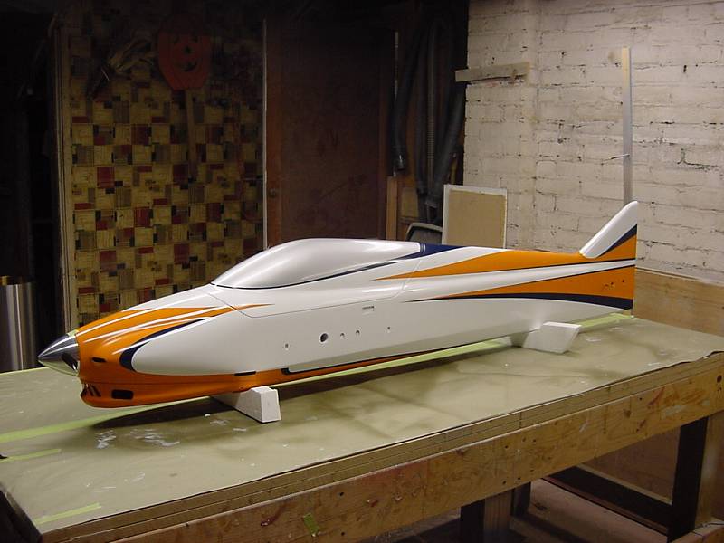

Old 08-30-2007 | 12:07 AM
  #117
Joined: Dec 2002
Posts: 376
Here's a new fuselage I've just finished painting. It's amazing how a paint scheme can change the looks of an airplane. Hopefully this will be in the air before season end.
Todd
ID:	752941   Click image for larger version

Hi Todd
Awesome pattern. You're right. I like very much design of your Défiant II
Claude

wow Todd nice paint job!

Very nice shape. I particularly like the thiner appearance in the nose especially in comparison to many of todays pattern ships that look like pregnant goldfish. I do have a question, how do you join the two halves of the fuslage? Do you do the layups of each half and then after they have mostly set lay in the final layer of glass joining the two halves? If so how do you get all along the seam to make sure it is even and complete? Would there be an advantage of laying one up entirely in carbon? Would it be cost prohibitive to do so? Most of my experience in fiberglass involves rifle stocks and i know the lightest and stiffest ones i can get are layed up in carbon.[:@]
Old 08-31-2007 | 08:39 AM
  #121
Joined: Dec 2002
Posts: 376
Thanks Claude and Robert for your comments. I went back to my old colors in hopes I can see this one in the air better than the red plane I'm flying now.
Kaos2,
Seaming the fuselage involves bolting the molds together then laying seam tape over the seams. I wet out the tape first, then drag it through the fuselage, position it, then press it down. Works real good and makes the seam job go pretty fast.
Laying a whole fuselage in carbon would be really expensive. Carbon is about $90 a yard for the weights we use in modeling. So, we find ways to make laminates that are strong, light, and cost effective. There are several option being used, one just needs to find what works for them.
Todd
