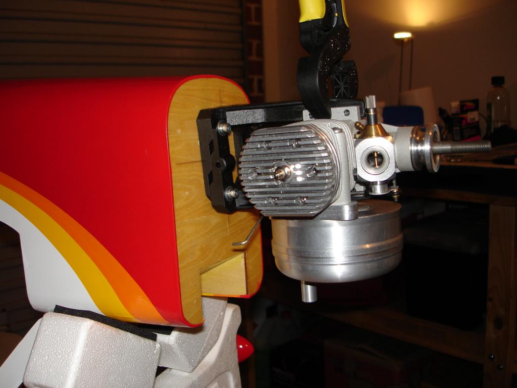

ytell,
Can you please post a pic of motor with cowl from the right side please.
I am just starting my build with the same motor and Q Series muffler.
Regards
Gil

I thought i'd post some pictures of the Turbo-Jett muffler in a Venus II so you can see how well it fits.
These pics are of my Venus II which is slowly progressing. The engine is a Webra .91 and the muffler is the 91-1.20 sized Turbo-Jett.
Dubb can supply the muffler with adapter plates for different engines. This muffler also fits the 1.20AX.
The engine is angled approx 4 degrees down by rotating the supplied firewall drilling template 3mm (1/8") anti-clockwise.
