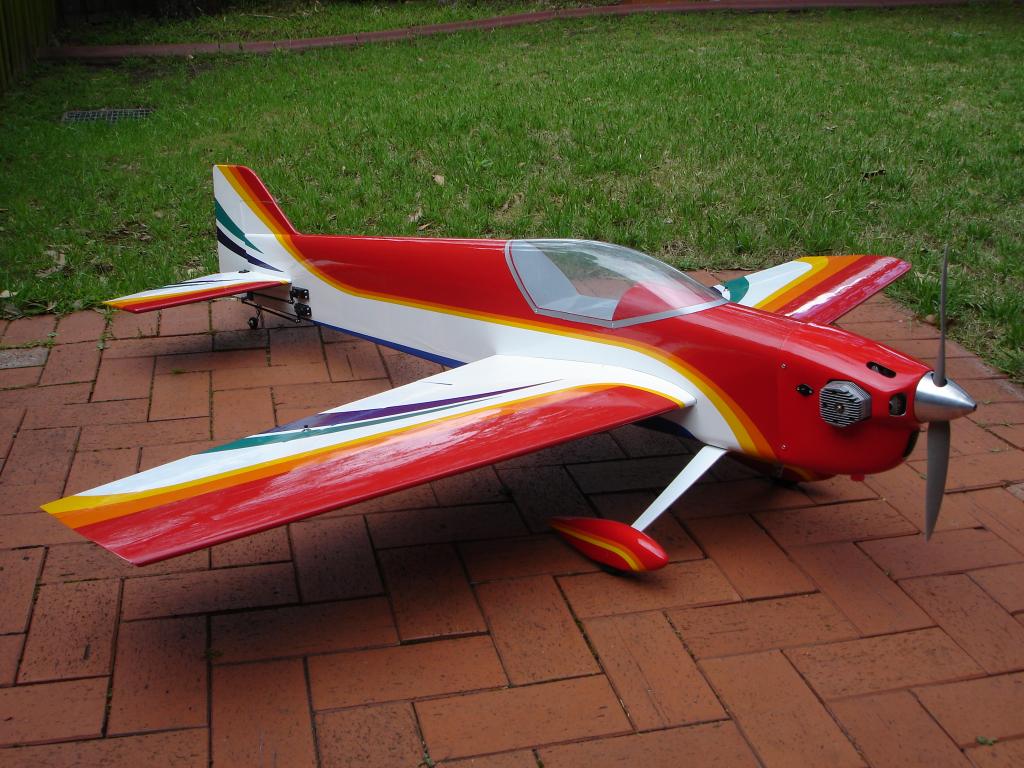

After over 6 months on the building board i have finally found the time to finish my Venus II and plan to maiden her tommorrow, weather permitting.
I was planning to use my Webra .91 but decided to go with the 1.20AX instead. I'm using a Turbo-Jett muffler which fits completely within the cowl. I used Dubro ball links on all control links and made my own pseudo carbon push rods by using some carbon tube over 4-40 threaded rod glued in with a small amount of gorilla glue. These are much stiffer than the metal rods and only add a few grams of weight.
Servos are Futaba 9255's on the Ailerons and Elevators, 9151 on the Rudder. Power is provided by a PowerBox DigiSwitch and Fromeco 2600mAh LiOn pack.
The dry weight is 3,900gm (8.59lb)
The balance came out almost perfect. I only needed 15gm (1/2oz) of lead weight near the tail wheel to get it on the reccomended CofG.
one thing that concerns me is that the landing gear has quite a bit of toe-out and i'm wondering if this will effect the taxiing at all?

Old 10-10-2009 | 07:23 AM
  #1294
Joined: Mar 2003
Posts: 1,249
From: Mt. Pleasant, OH
Default RE: Venus II
Mine has that toe out, too, and it taxis fine. The holes in the LG are a little larger than the bolts and it tends to creep back, you may be able to bush the holes to elimnate some of the toe out, but it hasn't been a problem for me.
Old 10-10-2009 | 11:19 PM
  #1295
Jetdesign's Avatar
My Feedback: (8)
Joined: May 2008
Posts: 7,056
From: Honolulu, HI
Mine looks like it has toe-out, too, but I wonder if it's just an illusion from the wheel pants. And I'm not even using the stock gear.
Even if it did have the toe-out, the thing is a piece of cake to drive on the ground; I can't imagine a little toe-out affecting it too adversely.
Old 10-10-2009 | 11:35 PM
  #1296
KLXMASTER14's Avatar
Joined: Jun 2007
Posts: 973
From: Simi Valley, CA
ORIGINAL: gaRCfield
Gentlemen,
It's no illusion, the main gear out of the box has a bit of toe-out. I flew mine this way for a year and a half. Aside from wearing out some wheels, it was ok. Then I took the gear off, did some creative bending, and got everything pointing the right way. Bottom line, minor improvement in ground handling, no difference in the air. Looks better for sure. No more duck-foot!
-Robert
