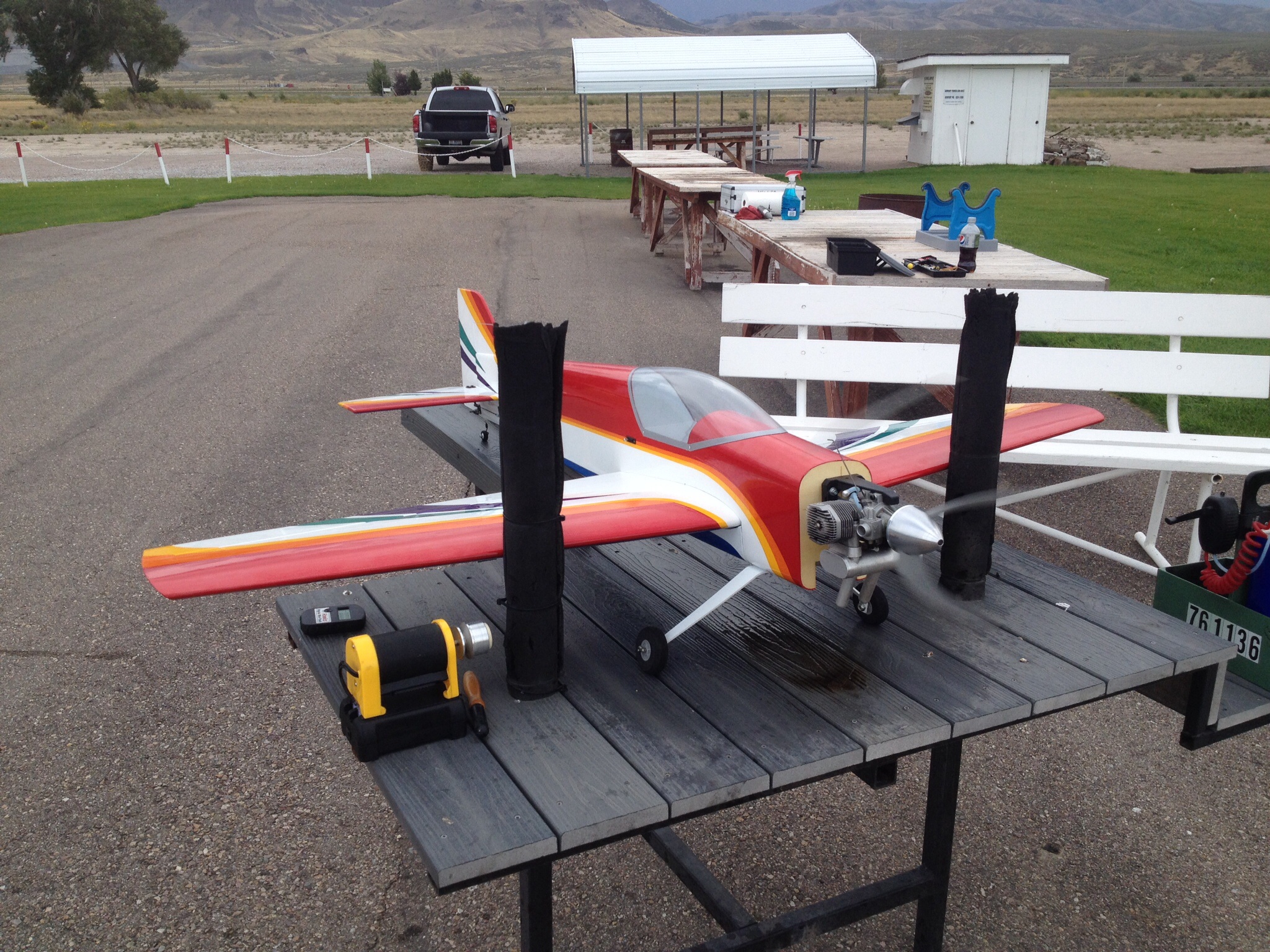

Well...got my Venus II in the air today. Went with a basic setup now with the tank up front. Plan to move it back soon and add a perry pump, which I've had sitting around for several years. Saw a lot of bubbles in the line at anything above half throttle, so kept it fairly mellow. Could only find an APC 16-10 at the local shop and need to get a 16-8 or 15-10. Got about 7500 rpm with the 16-10 using 10% powermaster fuel.
basic setup is:
OS 120AX with Bisson muffler (previously used engine)
Ailerons - S3152 digitals
Elevators - S3152 digitals
Rudder - Hitec 605BB analog
Throttle - S5101 analog
Futaba 7C transmitter and 617 receiver
Weight: 8 lb 1 oz without cowl or wheel pants. Needed 3/4 oz lead on the tail with the battery right under the wing bolts.
Plan to upgrade the battery and rudder servo at some point. Trying to use what I have for now.
Still have a lot to learn, so I'm starting basic for now. I'll be focused on basic trimming when I can get a calm day before winter sets in. Nice plane so far.

16x8 is money with that engine. It's really nice having the tank on the CG, although not if it causes you engine grief like it did with me. I liked the 15x10 with the YS but that was a short lived experience. Mostly I flew 16x8 with the OS.
Be careful with the Perry Pump - they have diaphragms inside that don't stay good forever. I called Perry at one point with an issue I was having; when I described my unit they told me to throw it out immediately because there was no way the diaphragm would not have dried out by that time.
If the Perry pump is bad I would look into a Cline regulator, or some kind of actual regulated system instead of just a pump. That carb isn't designed to handle pump pressure. You basically have to close the needles and find a tiny sweet spot.

If you slide the fuel tank back, but keep it level with the carb, you shouldn't need a perry pump. I used a cheapy Sears laser level. Had to install a lite ply shelf and then a sheet of foam. When velcro'd tight the dot was right on the fuel stopper.

I am inclined to stick with the KISS principle and go without the pump, but move the tank back to the cavity just in front of the CG (under the wing leading edge). That will give me a little room to properly pad the tank from vibration. I'm not sure if it is just my setup, but it definitely is not going to work in the stock location being hard mounted in the former. I'll see how the fuel feeds from there and decide if I need to try the pump or a regulator. Not sure I'll even notice the minor CG shift at this point since I'm just getting back into things after 10 years of not flying RC. Reliable and easy to tune are probably more important, just need to get the bubble issue solved.

The other issue I had with the stock position was that vibration with the tank and the formers were slowly scraping away the sides of the fuel tank. Only a matter of time before it would''ve worn through. I also bought a slightly larger fuel tank. I'll take some pictures of my set up tonight and post them for you. I'm a KISS person too. Detroit Rock City!

Everyone told me to keep it simple when I started with the Venus. I didn't listen and paid the price of lots of lost flight time, missed practice sessions, etc.
I wonder if there is a long, flat fuel tank that would help? The idea being the CG of the tank would be closer to the CG of the plane.
The change in feel (which I seem to recall clearly) is noticeable but not drastic. Choosing a reliable power system far outweighs the benefit of a constant CG in the Venus. Obviously it would be ideal to have both.

Here's a possible solution that I have used back in the '90s when I was running ST2300s in pattern ships just using pipe pressure:
It requires two fuel tanks; a small 2-4oz 'header' tank located just behind the firewall and a larger 12-16 oz tank (depending on engine size and desired flight time) located on the CG. The fuel feed line from the header tank goes to the engine; the fuel feed line from the larger tank goes into the 'vent' line of the header tank. The pressure line goes to the vent line of the larger tank.
This system worked flawlessly for me and eliminates the need for an external pump -KISS!
Good luck and happy flying!
PS If you don't fly the header tank dry the CG will remain virtually unchanged.

Made some mods to my Venus this weekend and flew it this evening. Moved the fuel tank to the compartment under the forward part of the wing and added a couple fuel valves off the firewall. I turned the tank on its side and it is well padded now. No bubbles and it seems to run fine in the vertical with the longer fuel lines. Slight RPM drop after 4-5 seconds, but good enough for me at this point. It flew great and I'm happy the simplicity. Just need to spend some time learning to get it balanced and trimmed well.
Thanks to all the posts in this thread with great information.
