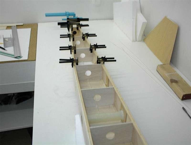

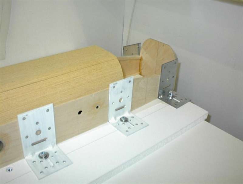

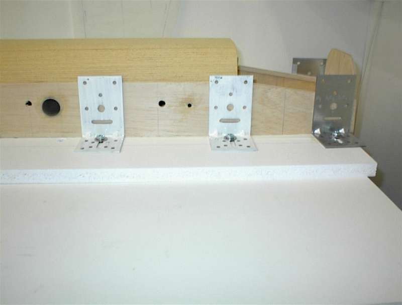

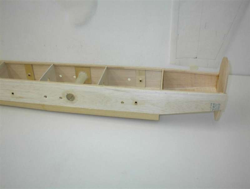

The tube for the antenna is in place and the floor under the fin has been added to the fuselage.
To help align the foam top, scrap balsa was glued to the fuselage sides.

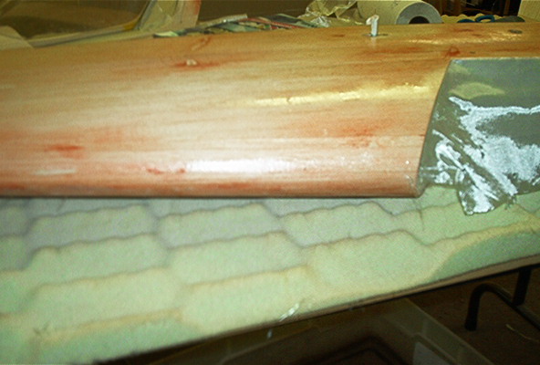

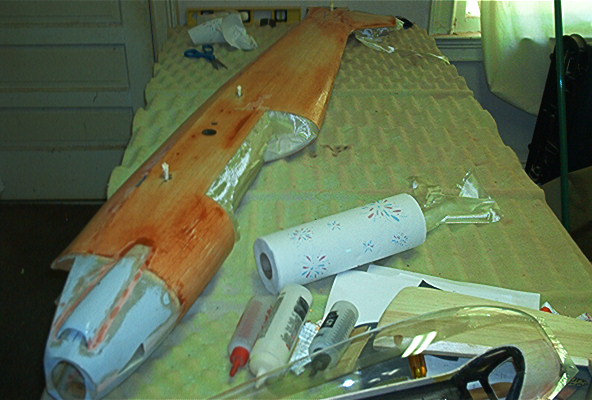

Ok, it's time for a lesson in glassing for you who have never done it. I'll show you just how easy it really is.
First, prep the surface. Sand and fill everything until it's as smooth as glass. I use bondo ultra (lightweight), glazing putty and light weight spackling paste for the pinholes and very small stuff. The bondo is used only around the cowl and tail fillets, where a lot of filling and shaping is required. Always use balsa wherever possible, sand it down, then putty and sand the rest. Don't just throw bondo at it or it will weigh a ton.
Next seal the balsa. You can either brush on balsarite and sand with 600 grit, or use hair spray (aqua net works well). Eitehr way, sand lightly until it's as smooth as glass.
Now you're ready to glass this thing. Cut pieces to fit the detail areas first, such as the pipe tunnel and the tail post. The fuselage itself is done with only 2 pieces, but the details need to be done first. The pipe tunnel is done with 2 oz cloth, and the rest of the plane is done with .6 or .75 oz cloth.
Mix some finishing resin and thin mixture with straight acetone. I use anywhere from 2-1 epoxy to acetone, to 1-1. It just depends. The resin should be slightly thicker than water.
Put your glass pieces in place, then using an acid brush, apply the resin through the cloth. It should become transparent, looking like wet wood. Spread it thin, but make sure there are no dry spots.
Leave an edge extending about 1/4" to 1/2". Overlap pieces if necessary to get all of it covered, then let it cure overnight.

After the resin has cured, trim the excess cloth from the edges with a sharp razor blade. Sand edge lightly with about 320 grit.
Next lay the fuse on it's side and cut a piece of cloth a couple of inches larger all the way around. Mix about 2 ozs (total) resin and cut with acetone as before. Begin in the center and work outward, this pulls the cloth tight and removes wrinkles. As you get to the edges and center lines, cut the cloth so it overlaps the centerline about 1/4". Now lay the resin to it and again, let it cure overnight.
After the resin cures, sand the centerlines and overlap with 320 grit paper. Be careful not to sand through the glass or you'll have to patch it.
Now repeat the proceedure for the other side, but this time cut a nice edge down the centerlines and lay it down with resin.
Walk away and let this whole thing cure for at LEAST 2 days before sanding again. I let mine sit for a week if I'm not pressed for time (but I usually am).
After the resin has fully cured, sand the whole thing with 400 or 600 grit paper. You want to break the glaze, but not sand through. You should barely hit the cloth. Now you're ready for primer.
There are other methods and tricks, such as talc as filler, massaging in micro balloons, you name it, it's been tried. But this way is teh standard, easiest way to get a wood fuselage ready for paint.
Next step: Primer and paint! And since it's not here yet, that part will have to wait. Oh well, it gives me time to cover my wings and stabs.

The acetone allows the resin to go on very thin, much thinner than squeegeeing with something. As a result, the difference is a couple of ounces on a wide body fuse (I've done it both ways). But either way works fine, and west systems is the BEST resin out there. But it is pricey.
I used to use alcohol as well, but acetone works better. Alcohol works fine too, but doesn't quite go into solution with the epoxy as well. Plus acetone is actually marketed as epoxy thinner. At first I was afraid it might attack the glue joints, but it doesn't.
-Mike

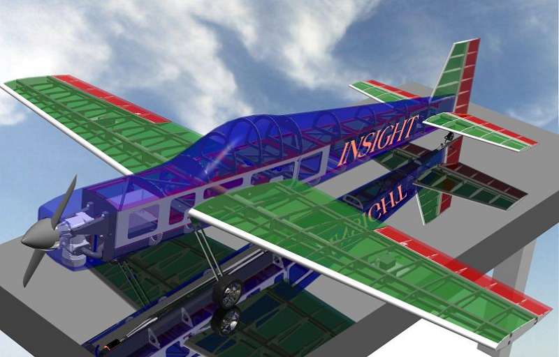

This thread is fantastic...keep it going guys....wonderful, useful information.
Sigk - Thank you for all the foam core pics...I just completed my first set of faom wings. Thank you for all the help your pics provided.
MHester - I will be glassing my next fuse......thanks to you. BTW, I used Solid Edge to design my 2M.
Thanks again for a great thread,
Mark

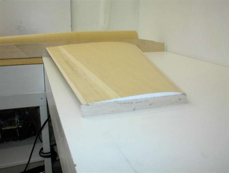

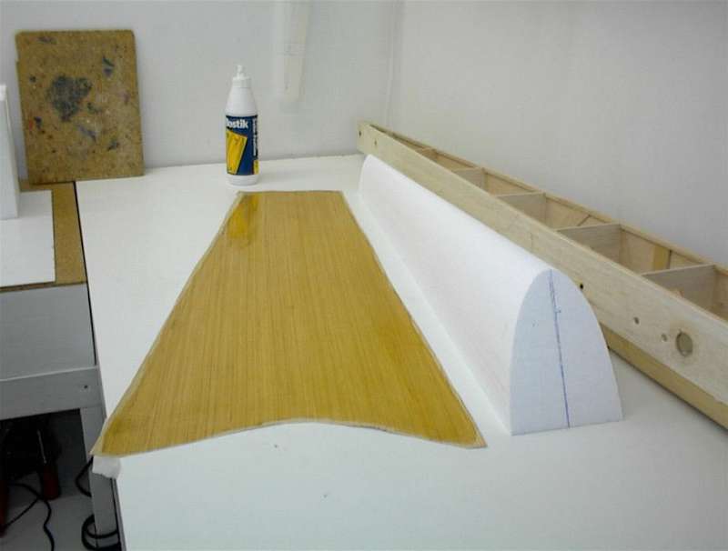

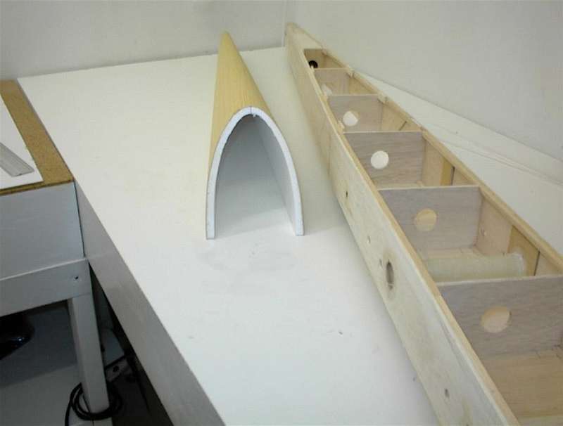

The foam top is ready and it fits just fine. But it will not be glued on to the fuselage until later.

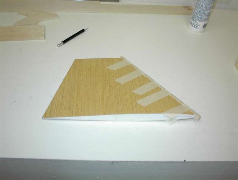

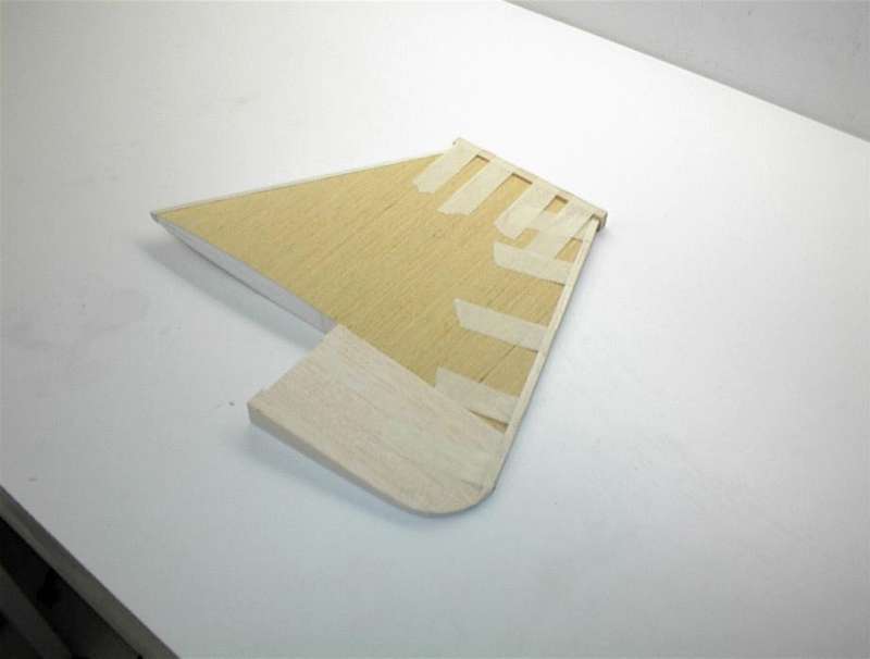

And now some pictures of the fin-rudder in progress.
