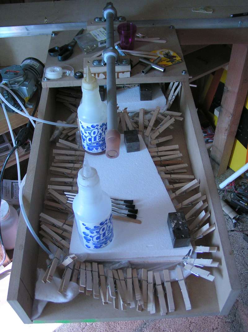

Slightly off topic pictures.
I am building a couple of Hydeouts for a friend to finance my wood plane. The pics are of bonding balsa skins to stabs. I use a vacuum pump. Works well, but it can be a pain when the bags don't seal well.
That tube thingie is a hole saw I made for punching the wing tube hole. It's bolted to a jig I built last week. I plan to use it for aligning the wings too.

Nice pictures guys, tph1 this is a interesting press you have there.
This must be really strong profiles you have if you only need two of them. Just be careful because if they bend while you are tightening, you will get much more pressure on the wingtip and the root.Then there is a danger the wingskin will not be properly glued in the middle of the wing. It might be useful here to have a third clamp for the middle just in case. Also in my experience a press like that needs to be fastened to something solid otherwise the lower half can lift from the table.
I have not used a vacuum pump like dreadnaut but it seems to be the best way to go.

You may be right Sigk I may add another piece of unistrut perpendicular to the other 2 to keep out any flexing. The boards are 3/4" MDF so the are plenty strong, it's all I can do to pick it up.

Best to do some experiments with the press before actually pressing on a new wing.
But I must say, your press is so much neater than mine.

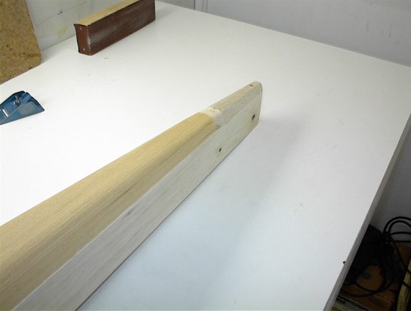

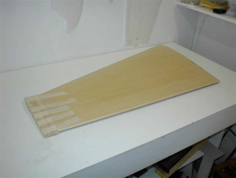

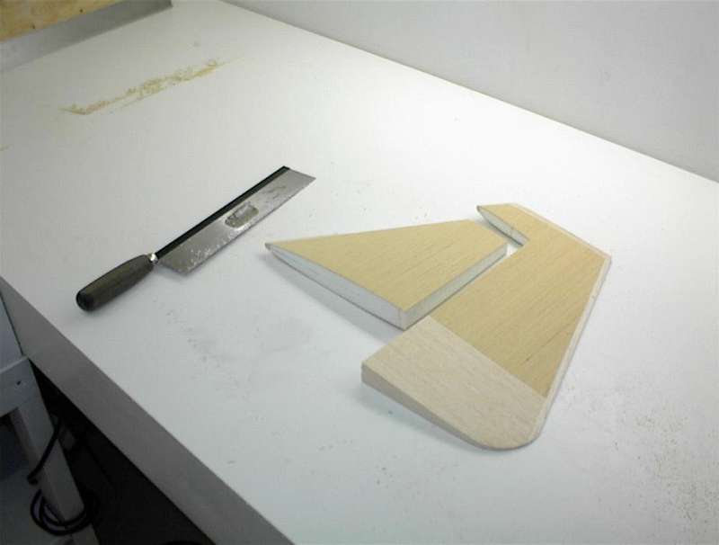

After the tip had been glued on to the stab and sanded to shape, the elevators were cut free from the stab.
The same process will be used for the wing.

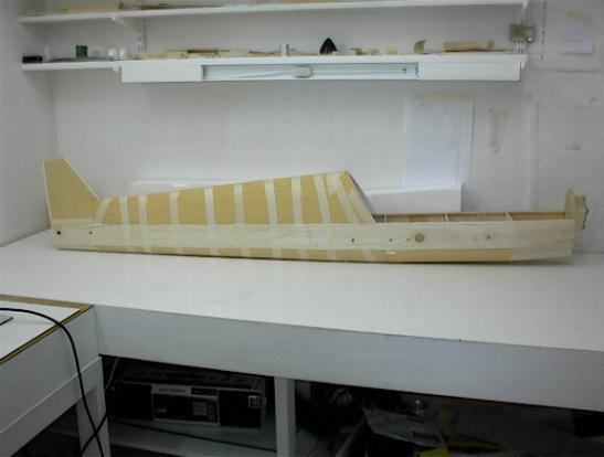

At last there was some building to do. Not been doing much lately except lining up foam cores.

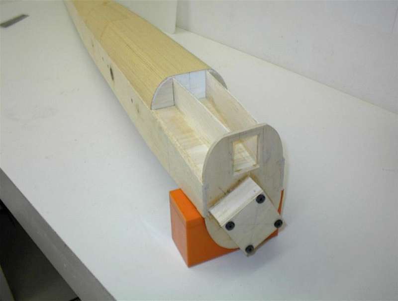

The rest of the bottom was finished with scrap balsa.
The next thing to do would be to open up the pipe tunnel, but I kind of liked how the three foam pieces lined up so I'm going to enjoy it a little longer.

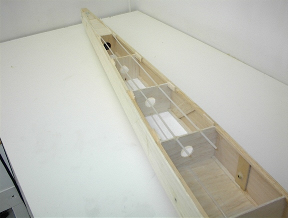

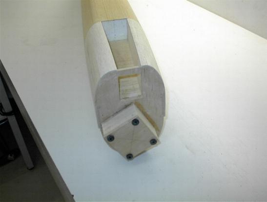

Tubes for the rudder cables have been glued to the formers so the fuselage is now ready for the foam top and fin.

SigK, Looks very neat and well thought out. I took your advise and added another brace to my wing press, it is much less likely to bow in the middle now.

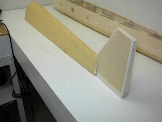

Thanks tph1 and good luck with your press
It is a good idea to get a good fit between top and fin before gluing on to the fuselage, much easier.

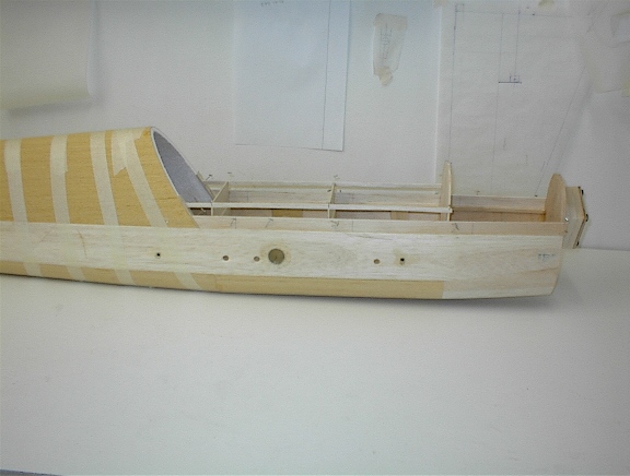

And now the fun part. Building up the fuselage sides and the canopy frame.

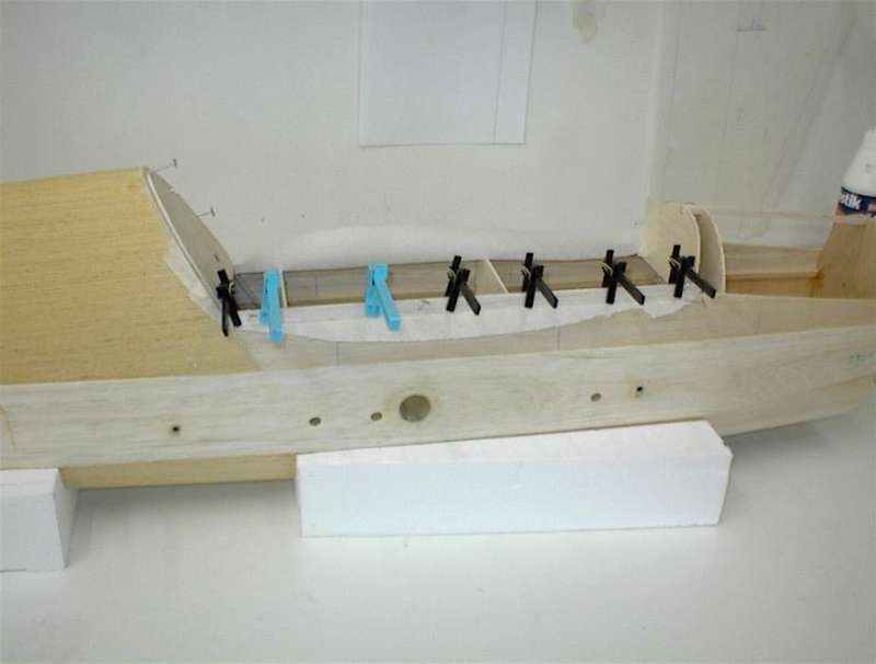

The canopy frame is next.
Putting wax paper between the fuselage and frame should make it easy to separate the frame later. I am very impressed with this design and how well it goes together and this is without doubt the best plan I have built from, the formers are very accurate and that makes this project so much more enjoyable. No wasting time here trying to make things fit.

More pictures.
I'm using allot of pins here.[8D]
