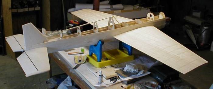

Obviously, progress has been slow lately. Work has been inerfering. I'm off this week and should make good progress as long as our terrible New England weather continues.
I've mounted the LG and tailwheel bracket, the vertical stab and completed the linkage for the elevator and rudder. Next will be planking the turtledeck, then mount the tank and plumbing, then plank the forward fusealage.
I have not sheeted the lower sides of the wings yet. I'm procrastinating on that because I know it will be difficult and critical.

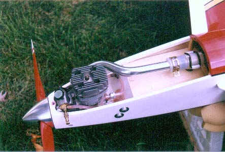

[B]I have an S.T. 2300 with Perry carb and Johnson rear/centerline header/Macs quiet pipe I can use - comments? I know the 2300 is not the best, but I got it and it'll have to do for now until I can afford something better/B]
THis photo is Karls USA Star w/S.T.2300 and his header.
Wayne

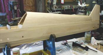

Making pretty good progress now. Completed sheeting the turtle deck last night. This shows it pre-filling/sanding and before adding the fillets at the vertical stab.
I found it easier and quicker to use sheeting on the sides of the turtle deck rather than 1/4" strips as specified in the book, "How to Build a Pattern Plane." I used 4" wide sheets for this, then used strips on the top part where the curvature is more severe. It could have been done with sheeting too, I suppose, but even with the sheet wetted on the outside, it might have cracked with the small radius at the top of the deck.

This is what I've done so far today. I need a break!
I "sculpted" and added the fillets at the back of the turtle deck at the verical stab. This shows one with body filler added to make smooth transitions between the parts. I used Bondo, which may be a little heavy, but very little will remain after it is sanded. I was worried that other types of filler might crumble in this application.
This was a little bit of a chore. To shape the fillets to the stab shape, I laid the fuse on its side on a towel, put 100 grit sandpaper on the stab and rubbed the fillets up and down on that so they would fit the stab. I then rough shaped the outside of the fillets with a razor plane and sandpaper. Then I attached them in place and sanded some more.
This picture looks pretty messy, but this is how the job gets done.
