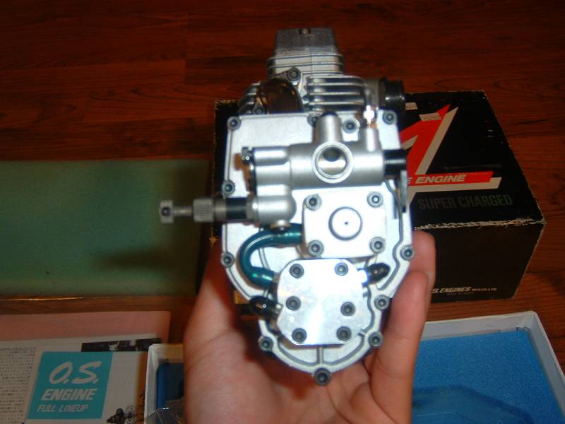

Okay...I have a Excelleron 90 with a OS 120 Surpass III w/pump installed. Well it lacks power to complete a pattern well. Now I was thinking of engine options to change it to. I thought of YS 110 but the thing is, I don't like YS Engines. No offence to the YS fans but they use too much high nitro fuels, you can tell the amount they throw away by the amount of white smoke that it spits out. Well one day, I was talking to a friend of mine on the airfield I was flying at and he told me of this one hobby shop that had a OS 120 Surpass SuperCharged engine O_O! well I found out that he did and he was selling it for $567 and that was too expensive for me at the moment. Well after a month of flying, I got frustrated and decided to buy it then didn't because it was so expensive. Well I came home today and my parents had bought it for me for my birthday present O_O!!!!! They got it for about $480 after I dealed it with the guy before-hand. Now I have a brand new Supercharged engine that my dad said worked incredibly well on a 90 size pattern plane when he flew pattern back in the day. So I'm waiting for the day I get to fly with it but until then, heres some pictures. I'll put more pictures up next time. I'll also tell you guys how if flew.

Well for one thing, I just don't like YS engines no offense. And the SuperCharged engine that I bought, I have 100% confidence in because my dad had it before. The power also makes up for the weight. I remember Naruke using this engine in the 1999 F3A championships. I just love this engine for one thing is that it was the very first model airplane engine equipped with a Supercharger and probably the last.

Power doesn't make up for weight, heavy is heavy is heavy, sure your uplines might be fine, but it will be faster in the downlines.
Why don't you like YS? Have you ever owned and ran a YS? I've ran the 140FZ, 140L, 120AC, 91AC, 61R's, 120SC, and the 120FZ. Outside of the 61's, I have run all of them on 15% nitro or the powermaster YS20/20 blend.
I've also owned the OS 120 surpass with supercharger, it is heavy, vibrates like mad, uses more fuel than the YS140FZ did, has less power than any of the 120's YS has made, costs more, and was probably one of the most finicky engine's I've ever owned. In fact, the only way my supercharged OS would run consistently was on 30% nitro.
Also, to coin a phrase, "no offense" but the 120 Surpass III should be MORE than enough power to complete any of the patterns with an Excelleron 90. Either your airplane is VERY heavy, or you're not using throttle the way you need to use it with a 4 stroke in a pattern plane. My guess is, with the extra weight of the supercharged engine the extra power isn't going to help you much in the uplines over the surpass III. A YS110 or 120FZ would have been a better choice IMO.
Yes, it might have been the first (that doesn't necessarily qualify it as best though), and it may well be the last blower-equipped model engine produced.
Now ask yourself WHY that is. Why did it disappear off the market so quickly? Why didn't all the top guys immediately switch to it to try and gain a competitive edge over the YS's?
Weight, complexity, vibration, and expense do not a better engine make. If a heavy gear driven supercharged model engine were fundamentally a world-beating concept in pattern, OS (and everybody else) would be making them and people would still be flying them, most likely.
