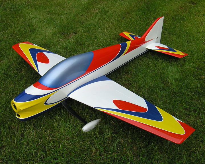

Finally I have mine ready to go. Thanks to all the posts on this thread it really helped me with the build. Mike

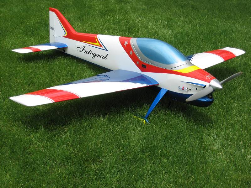

My friend Mickey's new Integral. Custom wing YS 160. Mike
