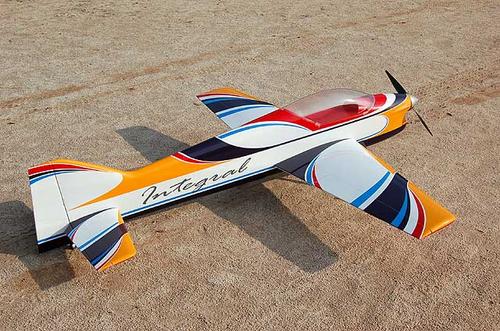

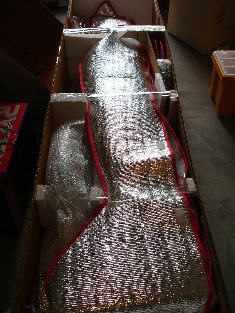

Well... it's finally arrived. After over a week of trying to get it out of the airport, it's here.

and in 6 minutes it went from this...

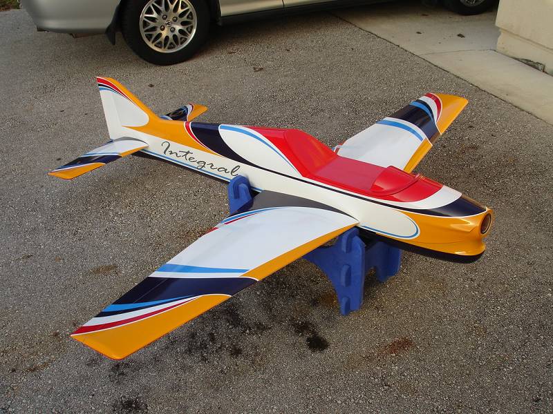

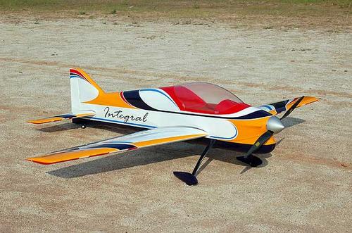

to this... BTW, this is, as of now, the "competition" scheme. The "standard" scheme I haven't seen yet, but as soon as I do I'll post what it looks like. This is not the $1190 scheme.

Vince and others. I was debating to even start this thread because there is one of 2 ways all of this will take place.
1- I sit here and answer all questions all weekend long.
2- I work on the plane and get it ready to fly for Monday (latest I hope) and then answer all questions then.
I'm gonna choose #2. Only cause, I really want to fly it. I can assure you it is super light... and somethings will have to/already are being changed. So my weights are probably gonna be a few grams lighter than final production. Sorry I won't answer questions right away.
A few notes:
Construction is like that of the Angels Shadow. There is wood instead of foam between the layers of glass.
The rudder is removable and pre-mounted.
The wings and stabs are pre-mounted and alligned.
The servos mount like a traditional foam wing, not on their sides like the Impact.
The landing gear is pre-mounted.
The rear former/tail wedge and fuselage "brace" are a pre-installed.
The hatch and chin are NOT pre-mounted, but hardware is included.
The firewall (for glow) is included but NOT pre-installed. There will be electric firewalls made, but not sure if included.
The hatch is the canopy floor.
Canopy must be cut and glued to hatch.
There will be a floor for a pipe included if you are not using electric or a short 4-stroke muffler.
This is all I can think of right now. Time to go to work. Cleaning the shop first, then starting to work on it.
Jason

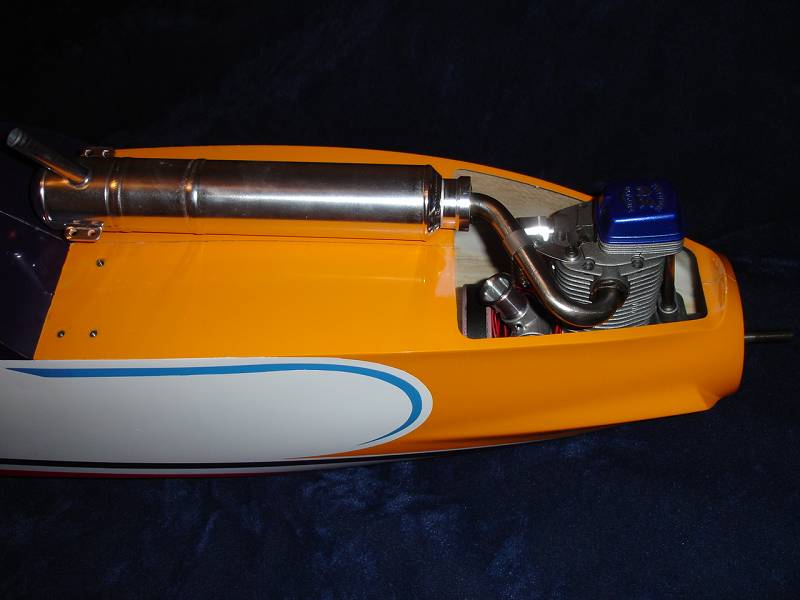

Here are some of the goodies going in the Integral.
I will keep track of everything, and post it all later

Looks like an OS engine but I can not read the brand. Correct?
Vicente "Vince" Bortone

Jason, have you had the chance to run that OS 200 yet? Is that a new hyde mount?

That is the OS-200 in the CR MKII mount. I have to dig out a nose ring when I mount it up. I haven't run it yet.
Aileron servos are in. Each panel with servos, 16ozs even. Whatever pushrods and horns weigh are the only things left. Gonna take a break, but I have been takin weights. 14oz panels before servos.

What's that big silver thing on the top right?
Where's the ESC and the batteries?
Chris
