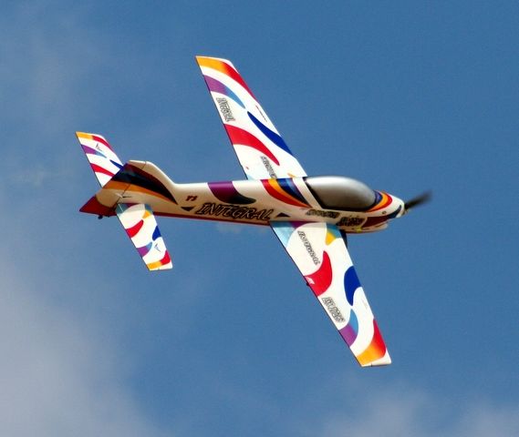

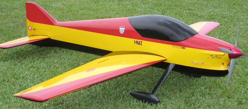

ORIGINAL: Jeff Boyd 2
Yes, I like it . . OR then there is these . .
All a personal choice . . and I think they will all look good on the finished model
Which font is the middle one? I like that one the best.
Thanks!
