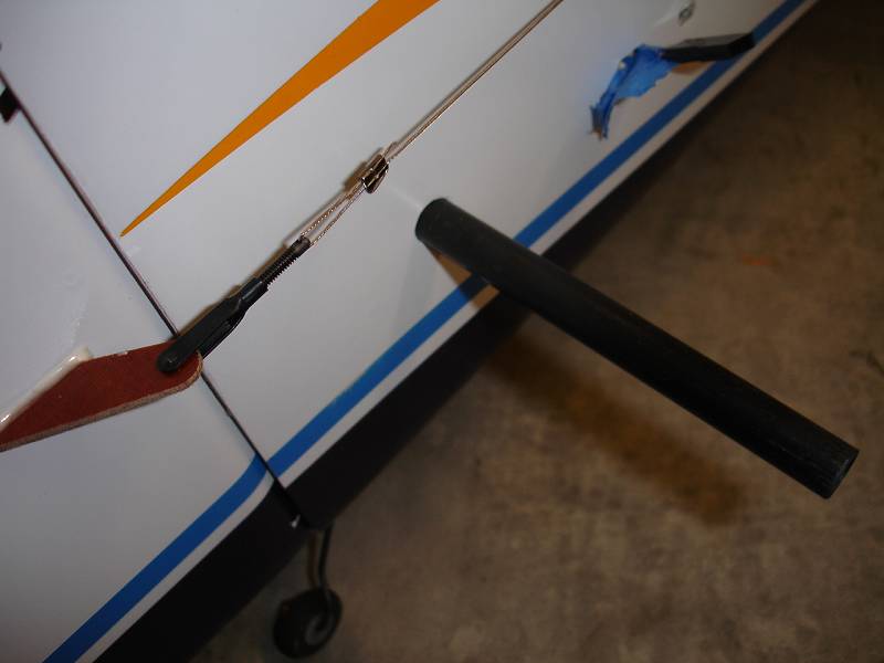

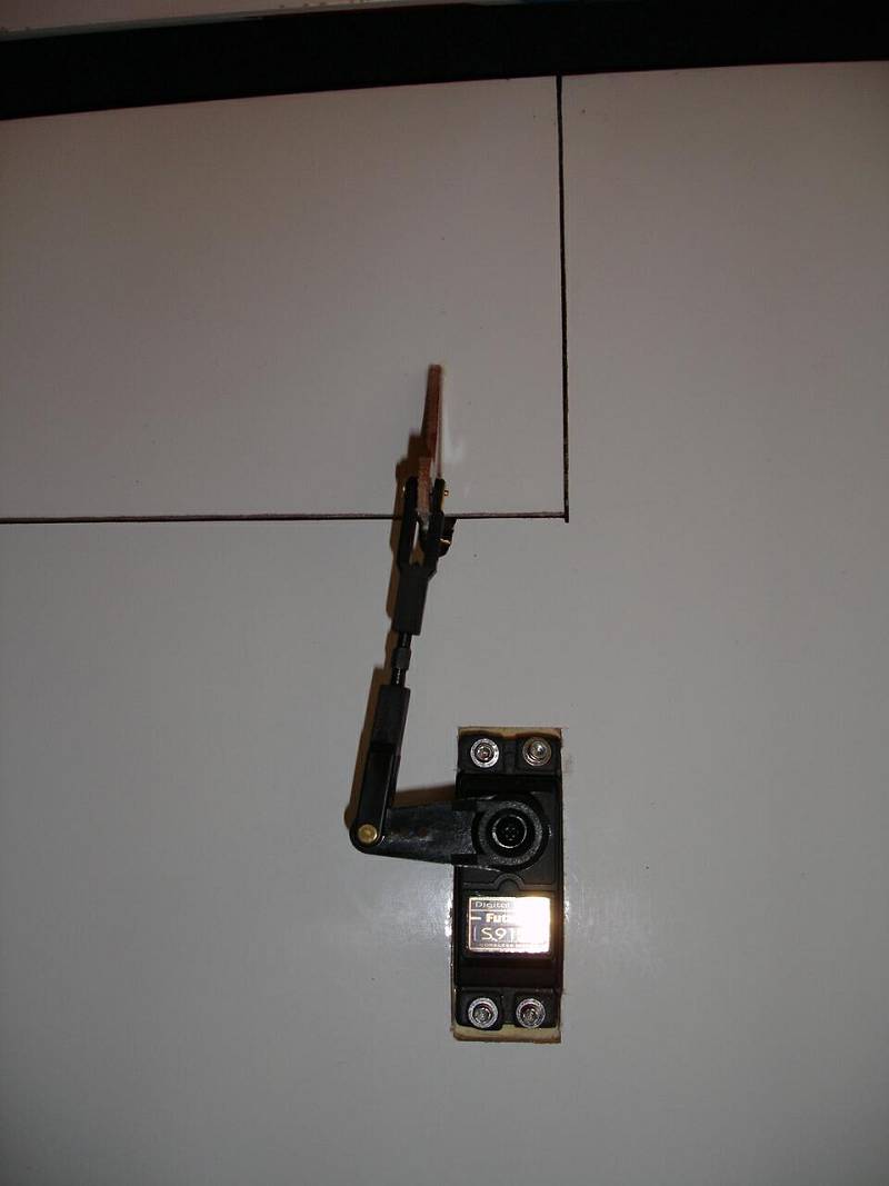

Here's how I have the linkages on the Integral.
Unless someone has a video camera....
Glow/Electric... it's all in how the individual sets-up/flies the plane.

Not sure if you agree but I would be telling comp-ARF to move the horn locations on wing and stab to get everything as close to 90 degrees as possible on the production versions. Those arms sure look long on your servos?

There are no slots cut for the horns in case one chooses not to use them, I cut them there. I, however, will continue to mount mine like this. The reason- at full deflection, the pushrod is straight there-by not loosing any “mechanical advantage†(might not the right choice of words here). Personal preference. Although after I figure out what throws I want on the surfaces, I will try and move the pushrods in on the arms and down on the surface to achieve the same thing. Currently this is the identical set-up from my Impacts.

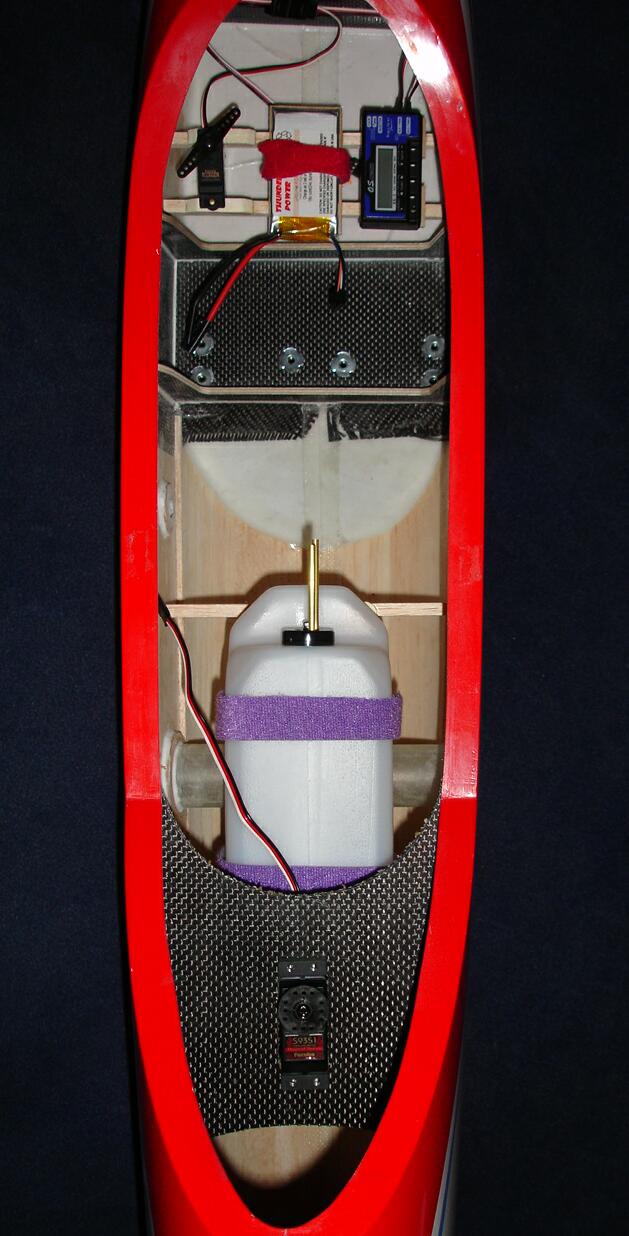

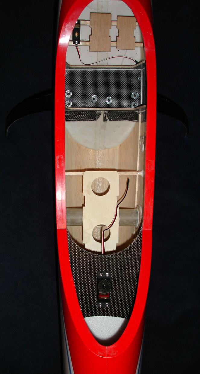

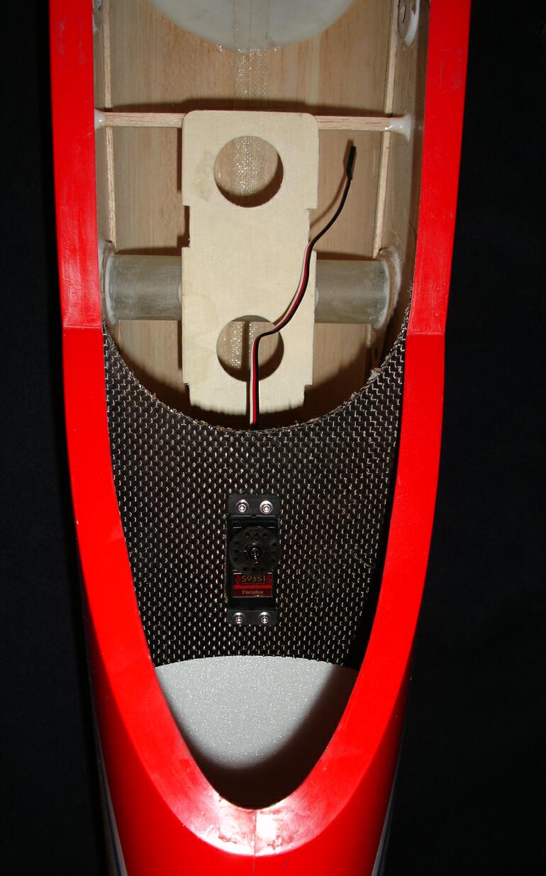

Here's some pics of my installation in the canopy area
