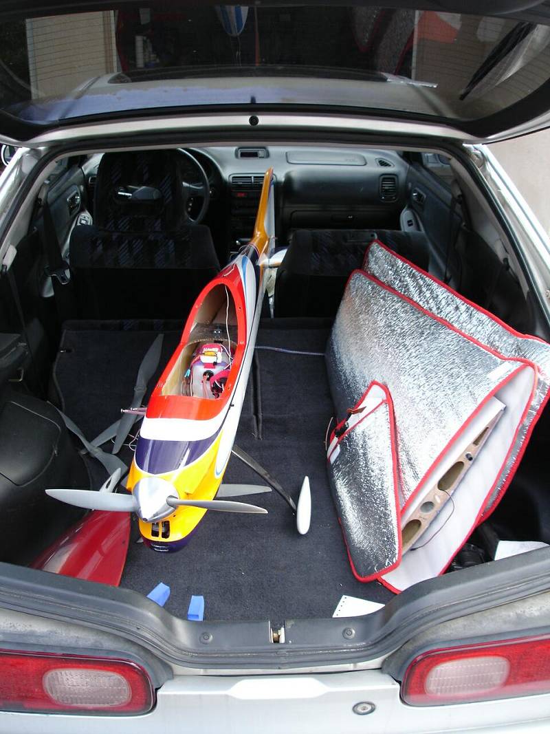

See Derek, it does fit in my little car... now time to go fly

Really? I don't see you in there? Can you fit in there with the plane?

C'mon now, it doesn't matter how we get to the contest as long as we get there, right???
I remember a time, actually several times, that I went to the contest with the Zen 140 and either the Ariel, or another 2m ship in my 95 eagle talon (same as an eclipse). Plus two foamies, all my gear, two radio's, and a big easy up. LOL
Jason, the plane looks great. Can't wait to get one!!

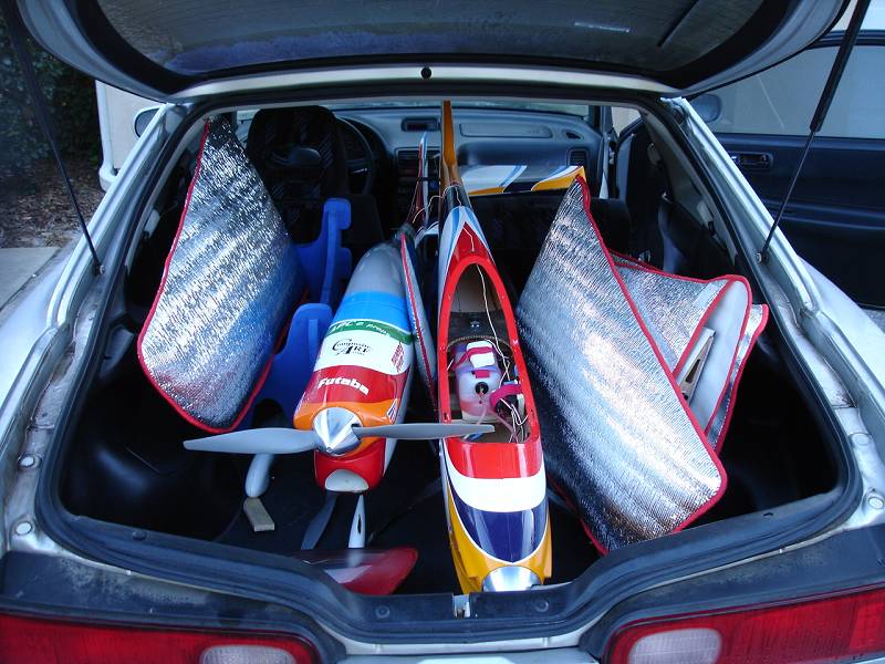

hehehe... Impact AND Integral in my Integra. I'm nicknaming my Integral... Integra L. This way I drive my Integra LS to fly my Integra L

Are you going to be owning multiple Integrals in the future Jason? If so, you can say that you use your Integra LS to haul both of your Integra LS to the field.

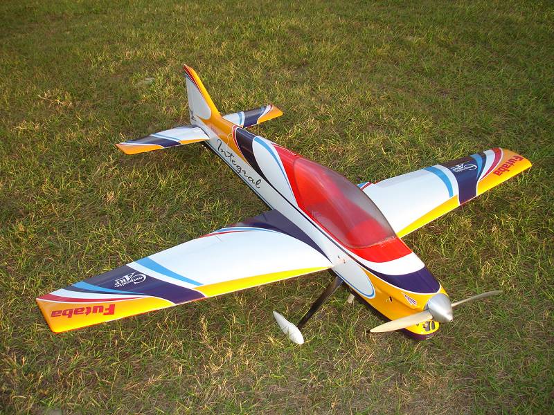

Here's some pics I snapped of the plane this weekend.

Airplane looks awesome Jason.
Now I need to figure out how you can fit two 2 meter airplanes in a Sports Car and I can only fit one in my Explorer...
Congratulations on your win at Tangerine as well.

Can you please tell me what prop and fuel you run with the YZ-140 FZ on the Integral? From the photos it seems to be a narrow blade prop.

I was running an APC 15x12 with the 140FZ. In the pics, that's actually a 160DZ with an APC 16.5x12. 30% heli fuel in both motors. Way over-powered, but I don't want to load the motor too much as it's brand new. The planes leave the factory, at least for the States, next week. Not sure about when the planes leave for Europe.

Man that plane certainly wasn't hurting for power with that new DZ up front
FWIW, my personal impression of this plane is this: winner, it's for real boys. It's easily the best F design I've seen yet. It snaps pretty well, and carves through the rollers and S very well. It's still in it's infancy but it looks like it is the real deal. It's constructed very well and is light. I REALLY think this is "the one".
It does have a ton of side area, and the only place this really seems to have any adverse effect at all is on T/O and landing in a heavy crosswind (which we had in spades this weekend). As soon as the plane gets anywhere close to air speed, it tracks out nicely. In the air, the clean design lets it cut pretty well. That's unusual for such a tall plane (and it is TALL!!!)
