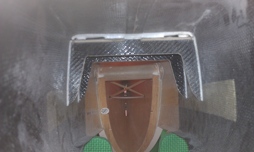

Mounting the gear noticed the sheeting is about 1/8 in away (floating) from the horizontal part of the gear plate. Leaving it alone would bend the skin of the airplane. I wonder if that contributed to the cracks people found in the side of their plane? I will probably recess the gear almost flush with the skin and mount directly to the block.

The delam happens on the sides just above the landing gear. I added some carbon cloth in that area just above the gear plate and also mounted support crutches above the landing gear plate. In addition, I "joined" the two halves of the landing gear with a carbon strap similar to what Najary shows in his Axitra build (he used aluminum). My landing gear plate was 1/8" 5-ply laminated on both sides with carbon cloth. I ground/sanded the seam you mentioned as low as I could and then mounted the plate with a real thick, pasty mixture of cabosil and resin. I don't recommend sanding down the center of the plate because that's the area of the plate that sees the greatest stress. Every time you land, the force is trying to break the plate in half. The joiner and crutches help in that regard, but I still wouldn't do anything to weaken it.

I've found the stock LG really stiff and the curved shape promotes transfering a lot of landing shock and load directly to the fuselage. Even a simi-hard landing will cause damage to the fuselage skin and LG support structure. A somewhat expensive fix is to replace the stock gear with a Bolly or similar shape gear that has a lot more flex than the stock gear. It will absorbe most ot the normal landing shock rather than transfer all the load directly to the fuselage.

So this plane had the gear block installed at the factory. The gear is supposed to bolt to the outside/bottom side of sheeting, in the chin cowl. I noticed the sheeting felt a little soft and took a closer look. You can see there is *some adhesive in there, but also some voids. So I opened up the sheeting and found the adhesive is not even contacting the sheeting in most places.
I don't have a pic of the gear installed yet, but it will be mounted directly to the bottom of the pre-installed landing gear block, which I sanded smooth and will fillet in the corners w/microballoons.
The gear is Graphtech F3A gear, customized with more sweep (just slightly more than stock integral, less than Bolly gear). It is definitely more flexible than the Integral stock gear, but I also will reinforce the sides of the fuse, once I really understand where the cracks are happening.

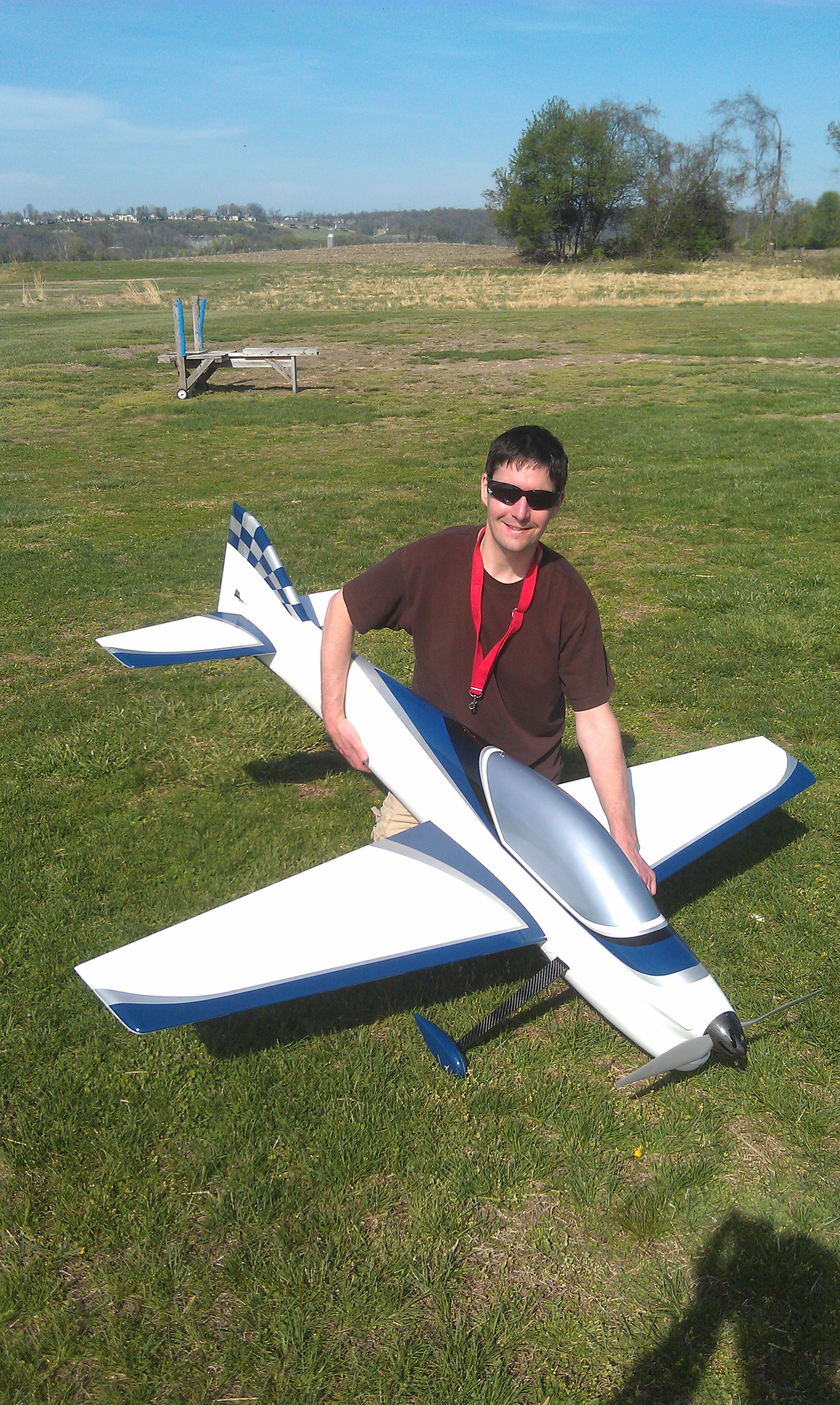

I started it just about a year ago - right after last year's Toledo show. I ended up building it at a friend's house an hour away, so work was limited to weekends. I had some major issues with the stock white paint pulling off the fiberglass which really killed a lot of my motivation. It took a long time but I think it came out well. I did end up repainting all the white - which while unfortunate, gives me a little more confidence in the durability of the finish I guess. It came out pretty light despite the extra paint, and a few strategically placed reinforcements.
I'm actually even more excited to sheet up the foam wing cores I have
That probably won't happen for a while but we'll see...
I am hoping to fly it this weekend. I have a few finishing touches to do, set throws, etc.

I had my first two flights today. It took the first flight to sweep out the cobwebs and to get the expo and throttle curve dialed in, and the second flight felt great. It is really predictable; it kind of feels like it just hangs there waiting for me to tell it what to do. I don't know if it's because of how long it took to get it built
but I felt like I was getting acquainted with an old friend. It's the biggest plane I've ever flown so maybe that had something to do with it.
