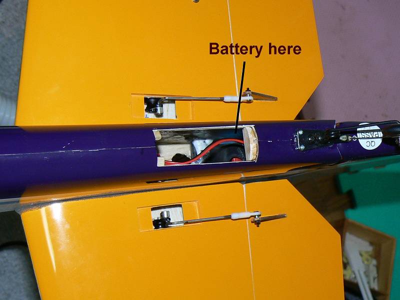

Old 12-30-2008 | 08:03 PM
  #812
Posts: 195
From: IwakiFukushima, JAPAN
Default RE: Composite-ARF Integral, kinda build thread
Hi there
See my Integral.
The first Integral ran it by YS160DZ.
But, This photo is 2nd plane that is runs by gasoline engine ZDZ40F3A.
A fuel fee is cheap, and this has the huge power, and I am very much satisfied.
This noise is equal to the 2 cycle glow engine.
A throttle response is a finer feeling than 2 cycle glow engine.
But, the smell of the gasoline is a fault when an airplane is brought into the room.
Weight 4.95 kg
20x12 / 6400rpm
A happy new year (may be false start?)
kobago
ID:	1099871   Click image for larger version
ID:	1099872   Click image for larger version
Old 01-02-2009 | 12:43 AM
  #813
Joined: Jul 2007
Posts: 806
Received 12 Likes on 11 Posts
From: Bridgman, MI
Hey Kobago,
Did you put the battery in the tail because the engine was heavier than the YS-160DZ, and what was the complete weight of the engine including the ignition system, and exhaust system? Also, did you have a seperate battery for the ignition system, or did you plug the ignition system into the receiver?
How does the vibration compare to the YS 160DZ? I'm thinking that your solution has the potential to save considerable money on fuel cost over the life of the airplane. Have you done any calculations to compare the cost per flight of the ZDZ40F3A as compared to the YS 160DZ?
Old 01-02-2009 | 09:04 PM
  #814
Posts: 195
Hi brenner
A happy new year.
Yes, a ZDZ40 gasoline engine is heavier by 150g than YSDZ160.
And it became a little heavy because it and a soft_mount were manufactured by my hand.
Besides, it is heavy with CDI(120g), and the fireproof cover of a long muffler(150g).
It is distributed from one battery(AA, 2000mAH Sanyo eneloop) to the receiver and CDI.
Therefore, electric current of 250mAH is consumed with 1 flight (12 minutes).
I think that the vibration of this engine is bigger than DZ160 a little bit.
The comparison of the price is as the following.
- - - - - - - - - - - - - - - ZDZ40F3A - - - - - - - YS DZ160
Fuel consumption rate - - 250cc/ 30yen($0.3) - - 500cc/ 600yen($6)
(P09x2, 12 minutes)
kobago

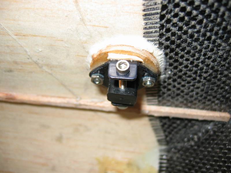

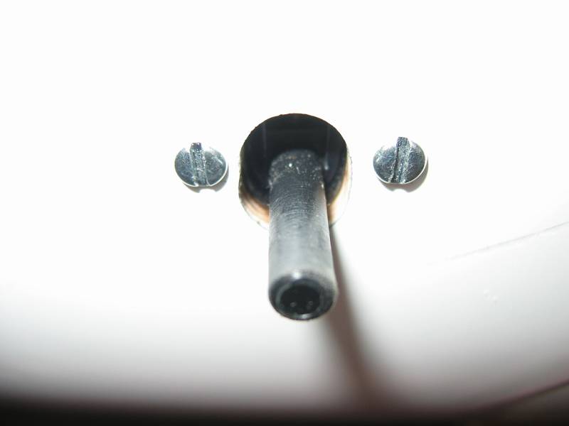

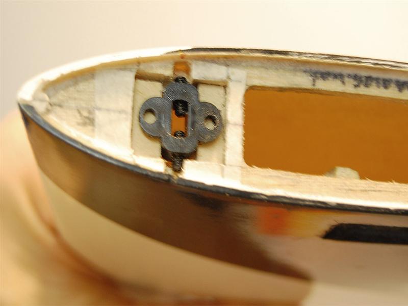

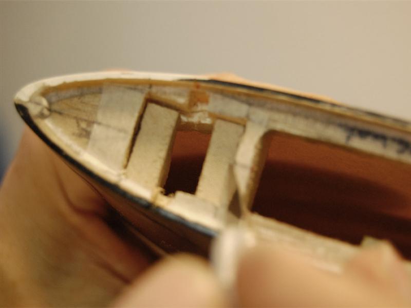

Old 02-05-2009 | 01:53 PM
  #824
crazyf3a's Avatar
Joined: Oct 2004
Posts: 90
From: AUSTRIA
Hi to All
The stab of my Integral had a difference of 0.5 deg. So I had to do something. Not the first time, I'm not the only. I know all know about the errors or the quality of the kit. I want nothing to say more about this. An old saying says: Speech is silver, silence is golden. For any builders Helps or Tipps. I have built stab adjustors. So I made it.
First, I carefully drilled the Carbon bolt out from the stab. Then I took my Dremel. Next step, I fitted plywood 2,5 mm and and adjusted everything. The last step i make Plywood 2,0 mm filling. So that the adjustor has fit exactly. Here are some photos about the work. The stab now I can adjust exactly. The next step is to take wing adjustors. But this is other story.

Old 02-07-2009 | 02:06 PM
  #825
Astropattern's Avatar
Joined: Jun 2007
Posts: 42
From: Kansas City, MO
Very good Andreas,
I have also done the Stab adjuster Modification, but this week completed the wing adjuster modification as well. I was pretty straightforward. Very little work required to the plane. The front adjusters are placed so the male portion is in the fuselage, and the rear adjusters are place with male portion in the wing. The female sockets are easiest to install in the original front wing pin, and the rear fuselage sockets.
To place the front sockets, I wrapped them with a few turns of paper so they would friction fit in the wing pins (that I cut off), then applied a small amopunt of thin CA to soak the paper/socket. The rear sockets I left until the last, so that they would be positioned naturally. Some epoxy on the socket froze the location and position of the rear sockets...then I was able to fill the empty space with balsa and filler.
I set the adjusters so the wing would be at +0.25 degrees to the motor with full "bottom" adjustment. This allows me to put the wing anywhere from +0.25 degrees to +2 degrees. Currently, my plane is set at engine=0 degrees, wing= 0.5 degrees, and stab at zero degrees. This close to all other planes I have owned and in the same ball park of other Integrals that do not fly the stock settings. Trimming procedure continues...
