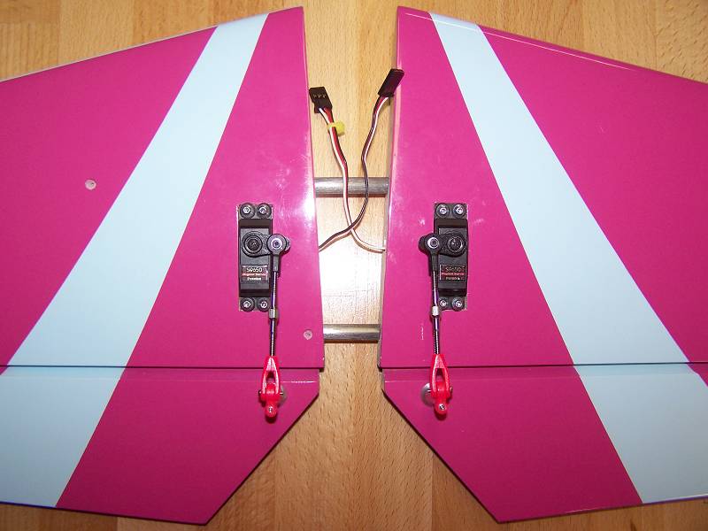

Hmm. I tested 6 pairs of 2.5 mm BB adjusters with the 2.5 mm titanium rod end threads. Dead positive that the thread size is 2.5 mm. These were brand new adjusters with no wear and no previous threading. In each case, after fully threading the adjuster to the max depth, I could separate the the adjuster from the rod end by pulling with my fingers.
In his case, there was a sudden gross elevator trim change(Loads of extra down trim).
He managed to get it down safely, and the linkage pulled apart by hand on investigation.
I think I'll stay with two separate elevator servos at the back!

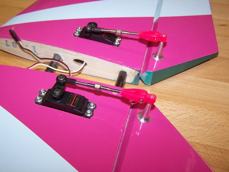

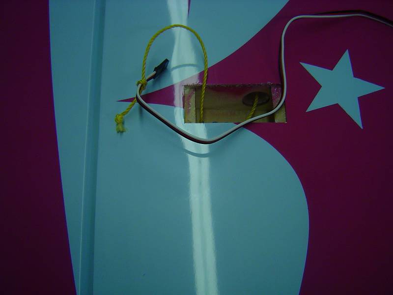

Here is how I "fish" the servo wire from the servo opening to the center opening. The Zeque has a simple paper tube inside of the foam tunnel cut prior to the wings being sheeted.
First I use a piece of the yellow inner nyrod (sullivan brand) with a 1/4" hardware store screw eye on one end. I fish the nyrod from the servo to the center. I attach a piece of string, yellow, in this case and pull the servo wire through. See picture.

The next photos show blue 1" painters tape perpendicular to the aileron centerline AND centered on the plywood plate installed at the factory to mount the MK offset control horns with medium horns installed. I originally was going to use the long horns but it just did not look correct. I have drawn a line continuing from the edge of the servo case on to the tape with a clear drafting triangle. The dotted line is about 3/16 inside of the line which is the centerline of the horn based on the hole in the servo wheel I expect to use.
The other picture shows the servo wheel just before I dropped it onto the wing (see previous post). The hardware installed on the wheel is NOT going to be used, rather the NMP 2.5mm dual axis ends will be used. I understand the NMP ends to be designed for 24/7 operation in highly precision applications... The installed control horn is visible in the background ready for the custom made pushrods.
Once again, it should be noted that the use of these nifty little hardware components are as interesting to me as the airplane. I am intrigued by their precision and ingenuity.

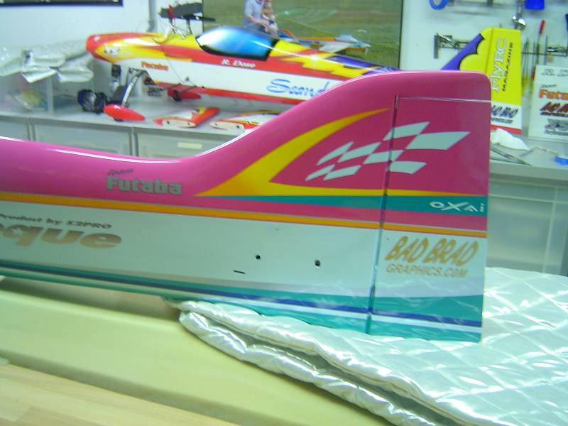

Graphics...
$3,650 airplane
$2,000 of stuff to make it fly
Looking at the custom graphics after they are applied...PRICELESS!
Ever since I saw Chip Hyde's "Dr. Jeckyll" in the magazine after the first time he flew it at the NATS, I began to understand and appreciate the impact of well executed graphics. No, I will never be on the US F3A Team and I recognize the fact that not everyone likes graphics, especially if they are for ADVERTISING. I like them and will continue to apply them on my stuff.
I get all of my graphics at BadBrad Graphics. Yes, BadBrad lives 15 minutes from me which is helpful. Yes, BadBrad treats me very right on price. But, that is NOT why I call BadBrad. It turns out that I used the same font, in the same colors for the last 15 years and Brad has helped me by being very creative and responsive in a variety of applications. Additionally, BadBrad has helped me with my trailer, my RV, contest signs, NSRCA banners, NSRCA stickers, custom logos, painting masks and is currently designing some graphics for my wife's KitchenAid countertop mixer (her idea)! I am told that he is typically 1/3 to 1/2 the cost of other fine graphics firms and usually ships within a week.
The Zeque graphics package required multi-layer custom cuts to be consistent with the quality of the over-all model. I have determined that my photo skills are poor and/or I need to upgrade my 3 year old camera to improve the quailty of the images.
The pictures are in no particular order. The little boy holding the wing is my 4 year old son-Chip. No, my wife came up with the nickname and it has nothing to do with the Chip you know but my Chip absolutely knows who the other Chip is. Please take a few moments to visit my RCU home page for other photos.

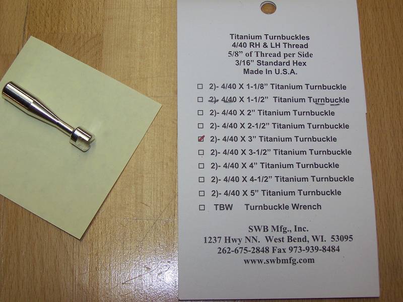

4. The aileron pushrod will be the SWB titanium turn-buckle, with hexagonal center and 4-40 left and right hand threads. This is very fast, very simple, light and strong.

Rusty why not stick with the two servos in the stab. Offers double protection, and it much easier to set up than the DEPS. 2 servo may be a little heavier, but still is a good set up.

It not so much the extra weight of dual elevator servos, because the difference is miniscule, as the location of the weight. If the model is designed to balance with the elevator servo in the fuse, taking that weight and adding it to the tail of the model is going to have to be compensated for elsewhere. I like to stick with the design of the plane when first assembling, then you know what flexibilty you have for later changes.
Additionally, building the plane as designed means you don't have to start cutting holes in the stabs of a $3000 airframe. I have a little adversion to that, but maybe it's just me.

Good Info Mike, i was looking at rusty pictures above and noticed that he already had the two servos installed, so for me Mr. Lazy I would just sitck with that set up
. The DEPS system is not the easiest to install, it takes time and patience, two things I seem to lose the older I get LOL

My bad; I had missed the picture of the stab with the two servos installed. I must be getting real old because I was sure the Zeque was designed for the servo in the fuse / pushrod elevator system and didn't have servo locations in the stab. I wonder what the chances are that somebody has posted a picture of the Beryll stab in the Zeque forum???
