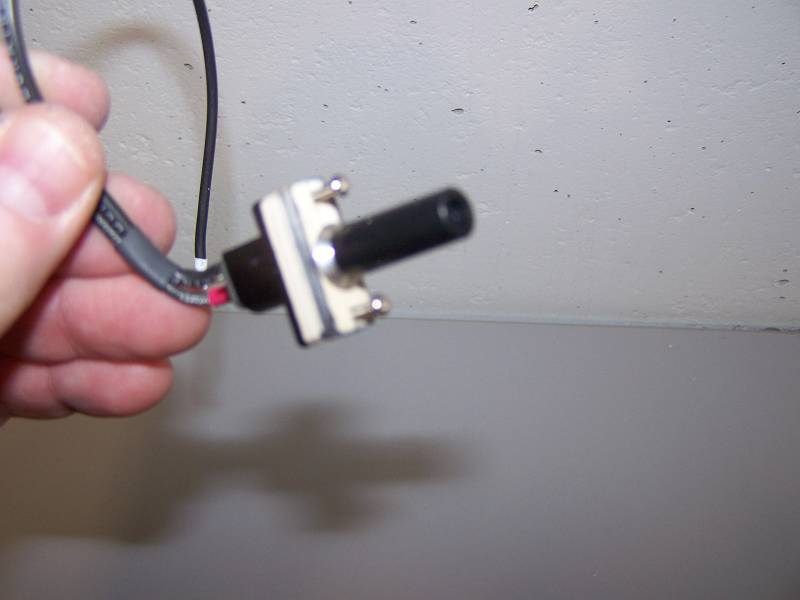

Throttle servo. I like to use a small, fast and precise servo for the throttle rather than suddenly become fiscally responsible..cheap and use the Futaba 9650 digital. The servo comes with mounting lugs on the body to allow for a variety of mounting methods...but you have to cut them off without cutting the servo wires. Yes, I have cut them "clean" off...very proud moment.
The photos show me scribing the case, breaking with a pair of needle nose pliers and final pass of a mini file completes the task in less than (5) minutes.

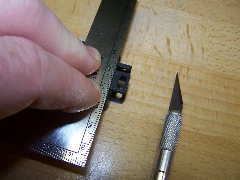

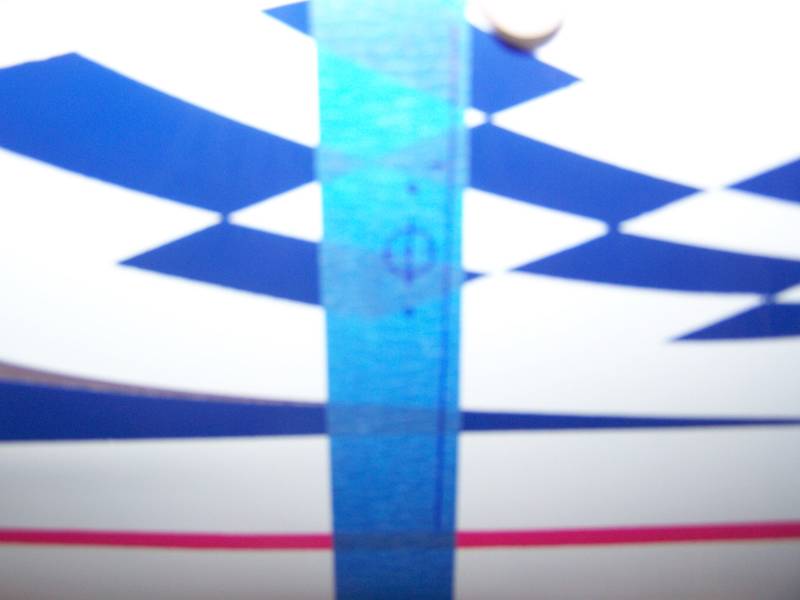

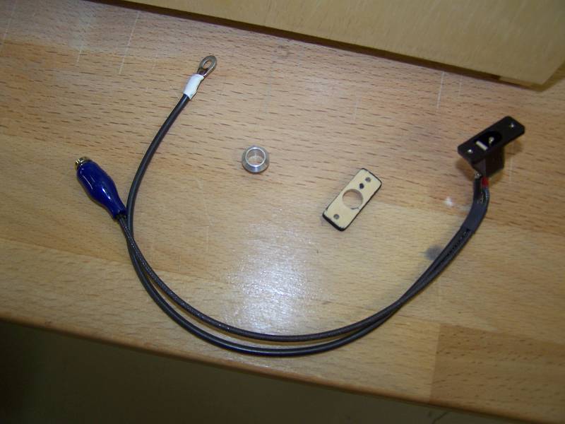

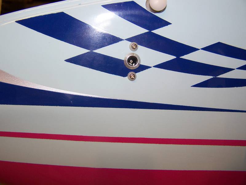

Mounting the MK remote glow plug system. The Zeque has a very tall or deep fuselage profile. How do you access the glow plug? MK makes a product to resolve the problem. The unit features a plastic bodied receptacle mounted with (2) tiny bolts into captured nuts, an aluminum trim ring and a male plug to be connected to a voltage source. Per many MK products, the modeler is left to figure out "how" to make it work.
The real challenge is mounting the recepticle securly while "centering" the trim ring for proper function. The trim ring has a tiny lip to grab. My experience with the unit is that the wires WILL break off. I suggest you replace the ground wire with a silicone wire used for R/C cars and purchase the Tettra silicone wire with protective shield and more robust glow plug attachment clip. Like many special parts, it is not required, adds weight (about (1) ounce) and installation complexity and the potential for maintenance. If you make the modifications that I am suggesting there is NO maintenance.
I make a (2) 1/8" craft plywood mounting plate/spacer first. A note regarding tools to build toy airplanes. Drill bits, drill bits and more drill bits. When I was a kid, I had a sharpened nail to bore all of the holes I needed. I suggest you go to a Northern Tool and Supply and purchase a complete set of lettered, numbered and fractional drill bits for about $80.00. You will save time, produce better parts and wonder how you ever modeled without them.
Accurately determine where you will mount it, triple check considering fuel lines, excess exposure to the elements. I prefer to use blue painters tape to mark lines and bore holes in fragile surfaces. The photos should make sense. I used a black Sharpie for color, green ZAP for fuel proofing and ZAP A DAPPA GOO for mounting to the airplane and the little aluminum trim ring. The white washers are from the back of the EZ connectors (PLEASE NEVER USE EZ-CONNECTORS ON PRIMARY CONTROL SURFACES!!!!!).

Hey Rusty I am also using the MK remote start for my Genisis. I removed the blue housing, and the heat shrink, applied JB weld to the connection and the added another heat shrink tube to the connector. Then I also added a 1/16 inch piece of medium fuel tubing over the tip of the glow plug, that way once you push down the tip, it will be somewhat soft mounted and should hopefully last longer. By the way I got this information from a thread on RCU a while back, so it is not my info, but figured I should pass it along. See you tommorrow.

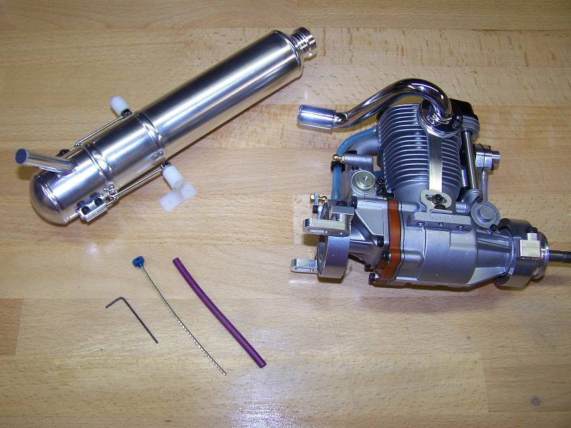

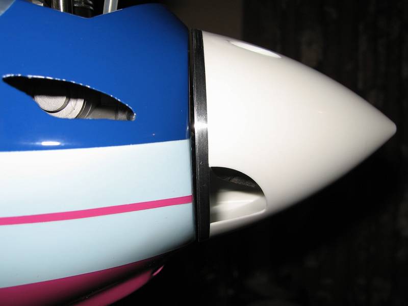

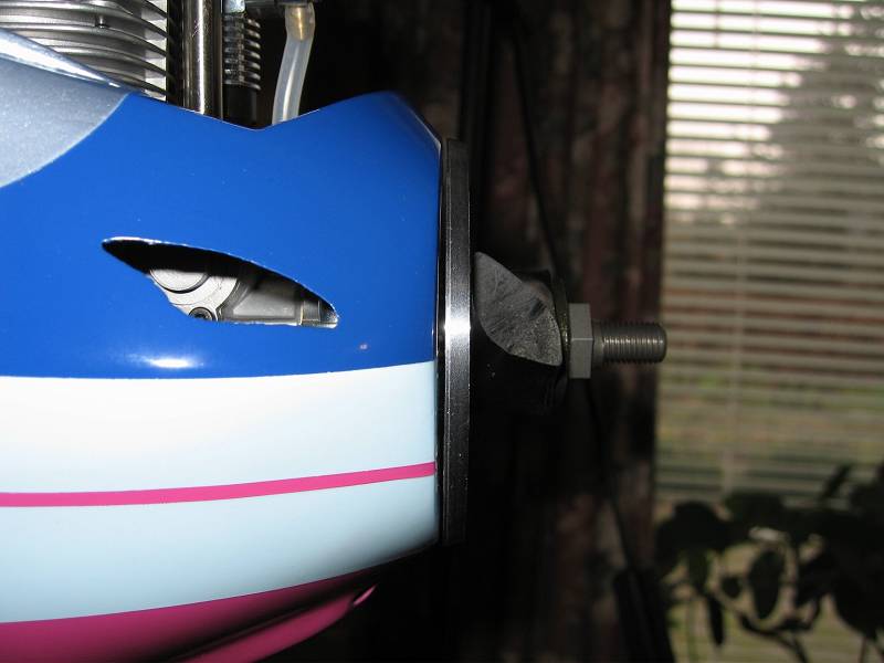

Engine installation...The Zeque is designed to use the YS soft mount with the available stand-offs. It is the lightest of the mounts I have used (see previous posts on this thread) and offers a large amount of adjustability. My assumption is that this model will require little to zero adjustments from stock...the engine rotates exactly about the centerline of the crank shaft which mnakes sense. (I am not an engineer or claim to be an expert about physics).
Additionally, I am using the (new to USA) Hatori header support which is yet another fine piece of not modestly priced accessory which one may not need, adds installation complexity which IS and I EXPECT to reduce my header maintenance to zero.
I am leaving for Phoenix (see Phoenix thread) in the morning (2/15/2007) with this COMPLETED model and hope to continue to post all of the details prior to my departure (returning 2/28/07), although I may simply run out of time. To this point I have covered many of the components and installation techniques of potential interest.
The thread will feature all relevant details until completetion including a detailed flight report! As Derek Koopowitz (NSRCA President)often writes...exiting the box.
(Some of my photos still seem to be out of focus.)[&o]

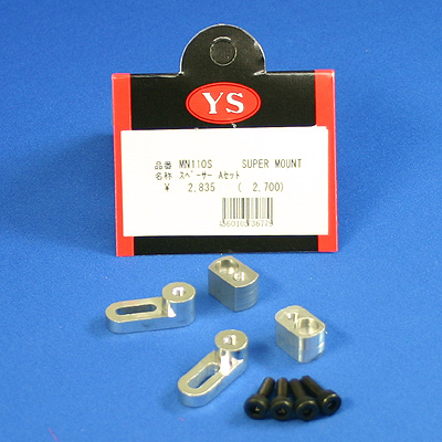

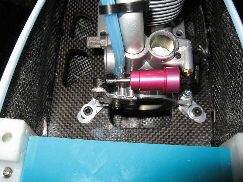

Rusty be warned when mounting your motor with the YS mount to your Zeque. It appears the rails were not jigged properly and there is a slight offset. You're going to have to make different spacer washers to offset the misalignment on your Zeque. Appears to be a manufacture error by Oxai. Mickey spent an entire evening analyzing and correcting this problem on my plane.

The YS-mount fits perfectly in the Zeque, you just have to make sure you use the Super Mount brackets, which the model was designed for. Picture attached.

No Mola your wrong I just talked to Mickey. They have the super mount that you show in the picture. The problem is the rails are not set right on Doc's plane and others who have the plane are experiencing the same problem. Except Chris who placed the Axi in his. (Good move Chris)!
Mickey had to shim the YS mount to bring the spinner backplate in line with the nose. It required a .100 shimm on the back of the mount and a .062 shim on the front. Oxai made a mistake. The manufacturer is going to be notified of the problem. It's fairly easy to fix but surprising when 1st discovered.

This change could be by design. I have Rusty Dose's Zeque in my shop right now. When I get home from flying tonight I will look at this issue. I think perhaps there could have been a chnage in the amount of down thrust needed after the protype was made. Oxai then lowered the beams to allow shims to adjust this. If they put the rails to high (looking from the bottom) in the fuse then you can't adjust anything without grinding the YS Super Mount spacers. But by lowering the beams in the engine area now you can add shims to get the downthrust correct.
I have a spare engine and YS mount and will stick it in Rusty Dose's model tonight.

I did my installation this past weekend, and I needed nowhere near 0.1" of a shim to get it aligned. As Troy says I think Oxai deliberately sets the plate a little too high in the fuselage so that you have to shim the mount very slightly to get everything to line up, this is much easier than if you had to grind off some material from the YS-mount brackets.
I installed 1mm (0.04" ) shims on the rear brackets of mine to get things to line up like shown in the attached photos. I'm using a 75mm spinner in the photo, and as you can see it is actually a tiny bit too large in diameter, 74mm would probably have been perfect.
I don't know from which batch my Zeque was, but it was delivered to Oxai Europe just after New Years. Maybe Oxai has modified this part of the model along the way.

DOC: regarding the use of the cool pipe mount...the primary feature to me is that it pushes the mounting point forward, in front of the landing gear where as my experience with the included mount requires mounting part of the unit on top of the landing gear (Scandalous).
