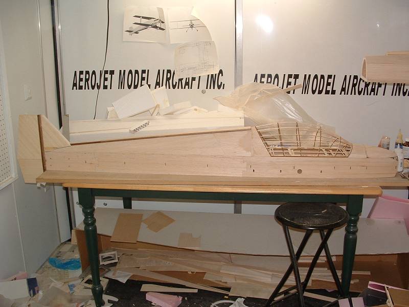

OK, had to set the beauty up to get a shot as she is coming together!!!
Man i am getting excited, bottom turtle decks and some filling and a lot of final sanding should work out nicely!
Enjoy...

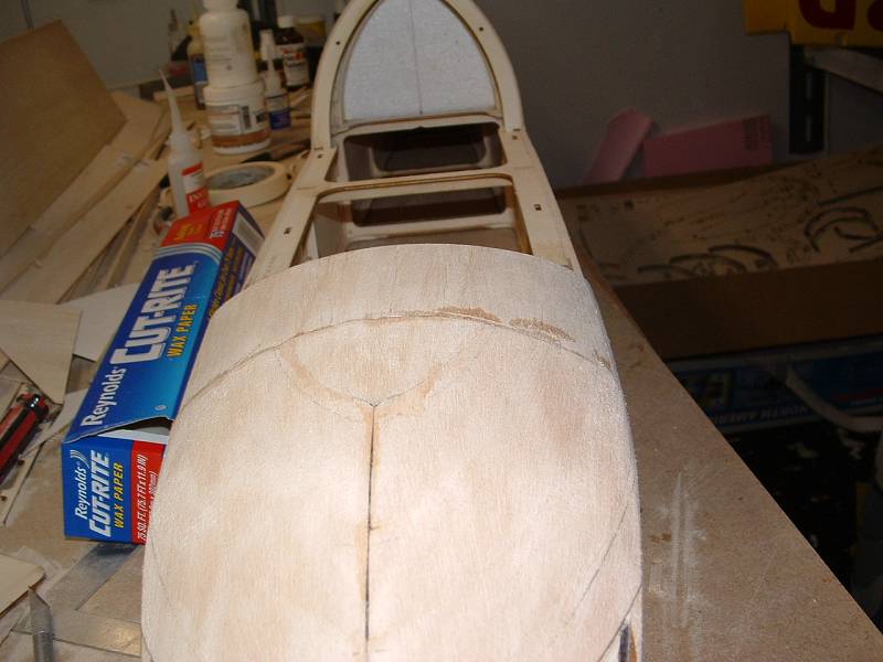

Old 03-11-2007 | 09:14 PM
  #31
RC_Pattern_Flyer's Avatar
Joined: Aug 2004
Posts: 1,119
From: San Antonio, TX
Default RE: Pentathlon Build Thread
Did some sanding on the "spine" of the rear turtle deck.. lots of dust here, was making good time but it started rainng and need to get to the house so here you go... bitmore progress.
here are the children at rest.... Top- Insight ala me... next to the wall hidden is the biplane fuse.... then the new pentathlon...
enjoy

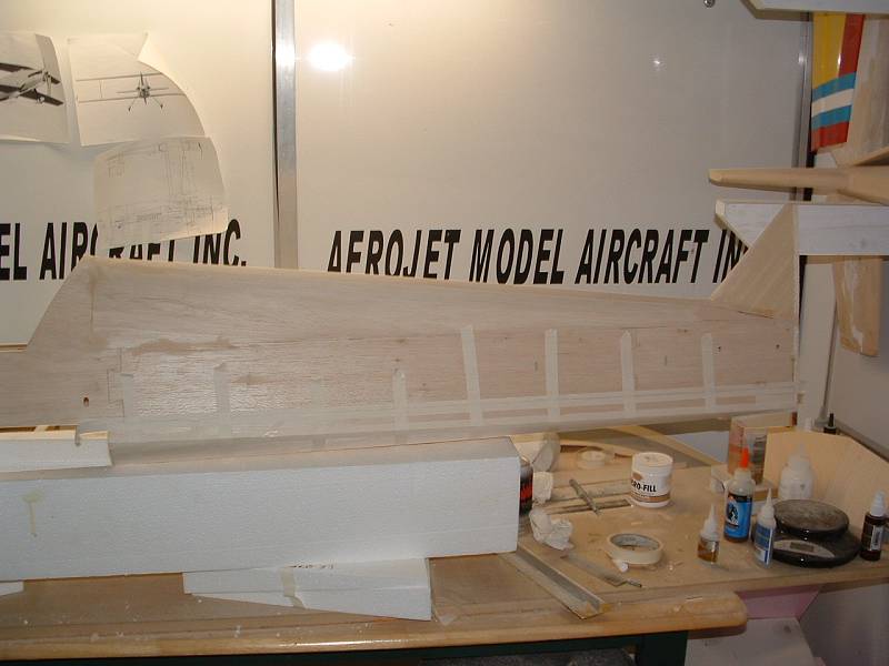

OK, got some more sanding done.. things are going quite well actually, quicker than the insight of last year... i could go on and on about how this plane magically goes together with the parts interlocking but i think most of the pictures can speak for me.
Here are some pics of the recent progress.
Also had a chance to flip it over and afix the lower portion of the rudder.
Enjoy

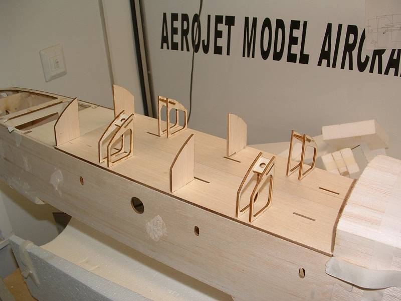

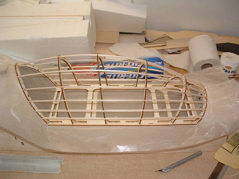

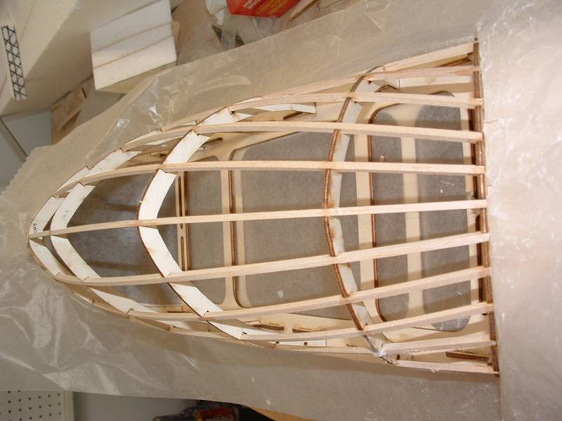

ok made a bit more progress this evening.... got the lower rear deck on, and started assembling the "pipe tunnel" area.. here are some pics.

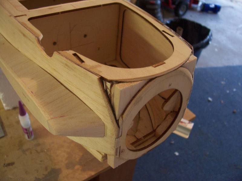

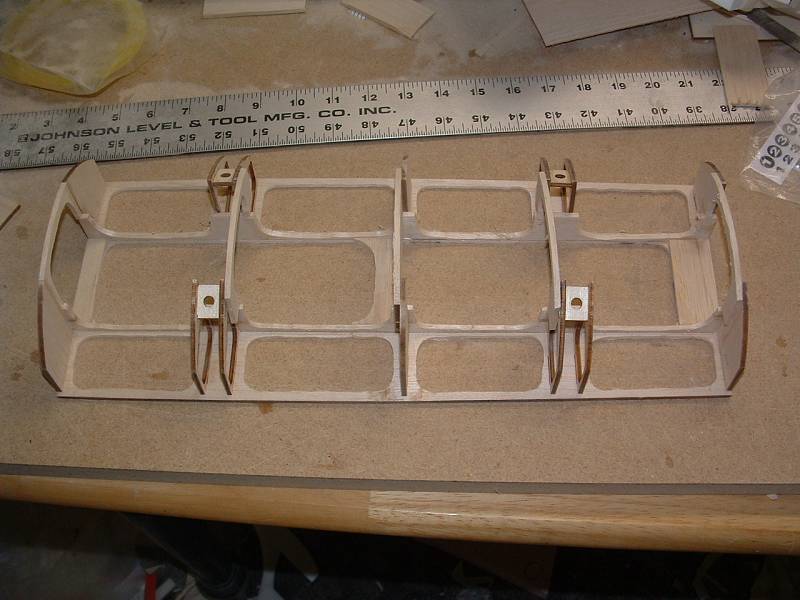

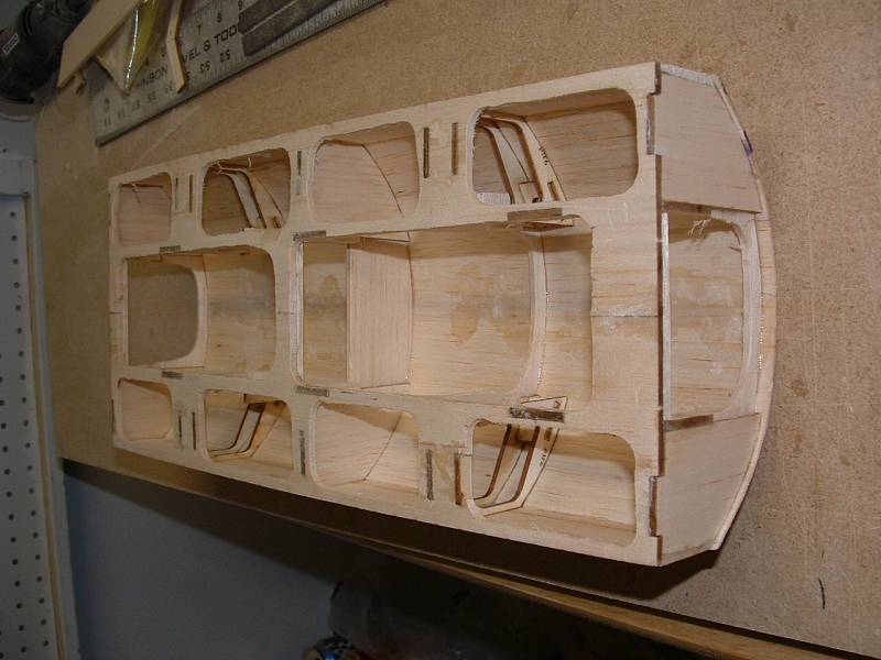

okook, i am a little confused by the pipe tunnel at first, i figured i would just ask for some pics and maybe you can explain it a bit better.
Mark?!?!?!?! pics please.. and also i am fixing to start attacking my noze.. and i am not sure how you did it, if i fill from the outside and sand... then i sand down to nothing. sooo
HOW BOUT SOME INSIGHT BUDDY.... no really, mabe some of your build pics or manual pics could clear this up some.. thanks...
here is where i am at:
Old 03-12-2007 | 11:32 PM
  #36
Joined: Aug 2004
Posts: 1,119

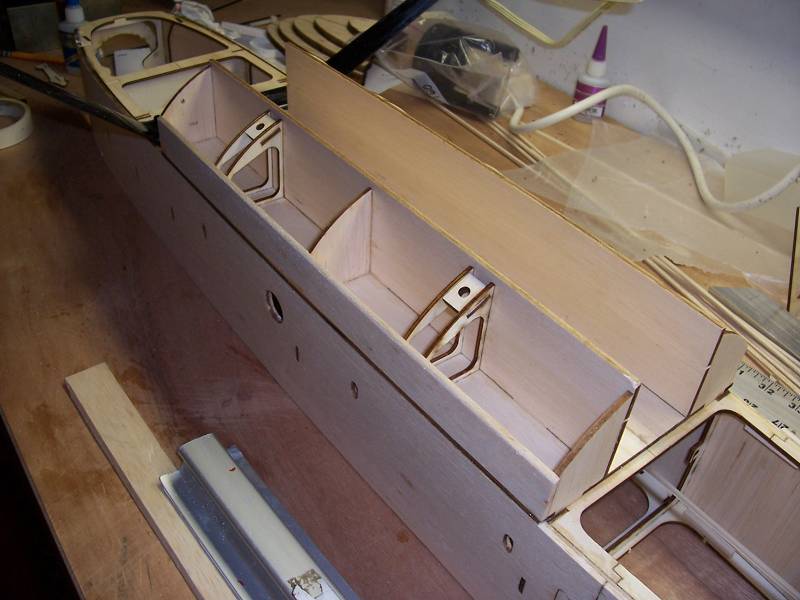

ok, maybe i should add the pics... here is the basic tunnel framed up and no glue.. LOOK MA... NO HANDS!!!
hehe i love this kit.
enjoy
Just a note... the plywood structure in the middle of the sides.. hmm see the plywood... ok, that is the mounting tabs for the subfin.. we use nylon bolts to attach so in the event that it has an encounter with terra irma for whatever reason it will shear the bolts and hopefully lessen the dmage to the airframe.

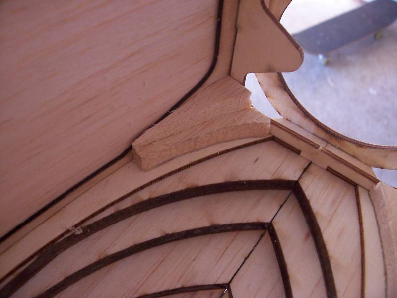

Chuck,
You've been making some good progress! This is very cool.
As for the pipe tunnel: It can be a bit confusing because the fuse sides have very little curvature in this area and therby making it very easy to get the floor on backwards. I have attached a pic showing how the outside edges of the pipe floor should meet up flush with the fuse sides. In your case I will be very interested to see what you do with the pipe tunnel since you are running electric.
As for the little holes at the nose: I filled these with some scrap 3/8" sheet balsa (use the scrap from the sheets that have your L.E.'s and Hinge caps) from the inside. I shaped them so that they protruded through the holes. I did the same in the spaces between the nose ring former and F-1. I rough sanded them flush, then went back with some light filler and final sanded. It was very easy. In the last picture you can see the remnants of the filler and the end result.
Hope this helps,
Mark

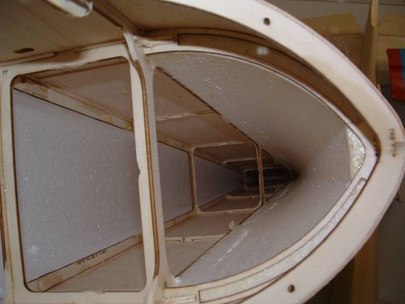

Ryan, thanks so much.. and you are right, the kit is terrific, so many little odds and ends that i cant begin to tell you how much time you save not having to make those "special" pieces.

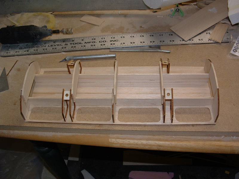

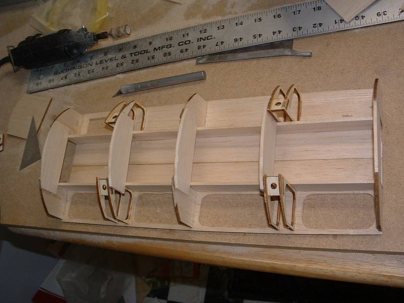

OK, got a good run at the front lower fuse section ( ala pipe tunnel)
Went together nicely, then i hogged out all that i did not think was needed, and cut the weight in HALF.. then sheeted and added the same weight back, hahaha, go ME!!
so here you go:

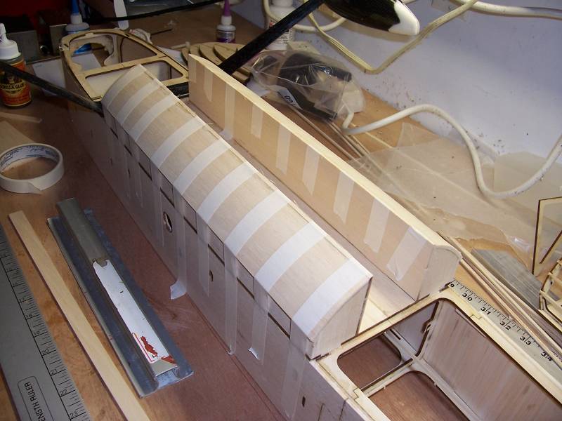

OK, changed sanding drums, MORE HOGGING!!! YEAH BABY!!!....
Here is where i ended up with it all done!
Enjoy

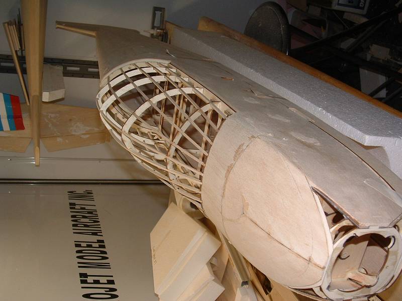

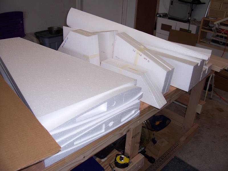

Well, this evening i did not get much building done, BUT, checkout what i happened to pick up!!!
i would like to take this opportunity to acknowledge my sponsors etc etc etc
Aerojet Model Aircraft (dealer inquiries wanted for flat foamys of all sorts including the pentathlon)
2DogRC ( www.2dogrc.com )
Dualsky Motors and batteries ( Imported by 2DogRC )
Mark Hunt Designs
And here is my big surprise....
ID:	642454   Click image for larger version
ID:	642455   Click image for larger version
ID:	642456   Click image for larger version

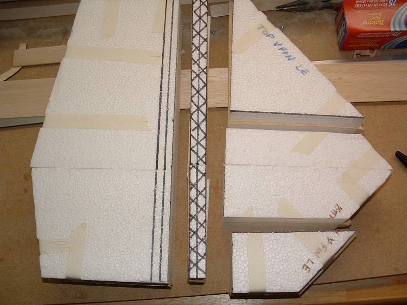

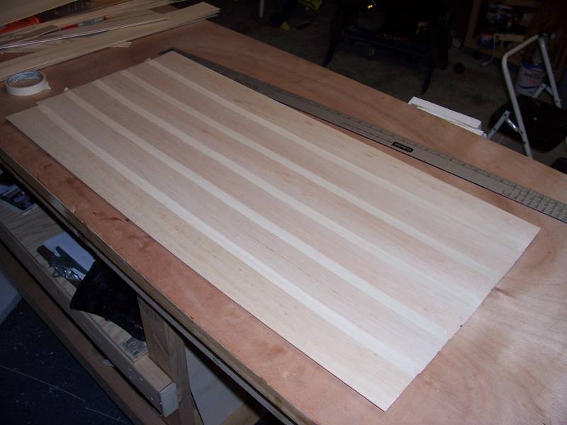

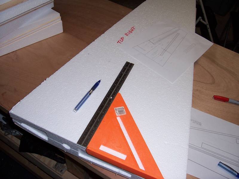

OK, had to use some extra resources to try and finish this bad boy maybe before Toledo and possibly but not looking good before temple (our first contest).
Mark was kind enough to take the wings on for me and shared a few pics with me of his process.
First, he squars up all the sheets and tapes them together making a nice well-bonded sheet.
then he draws out where everything is going to lay up for the carbon support and ailerons, wing tube, false rib and wing tube support.
Here are the pics, mark, please feel free to chime in here. thanks again!!!
ID:	646293   Click image for larger version
ID:	646294   Click image for larger version
ID:	646295   Click image for larger version
