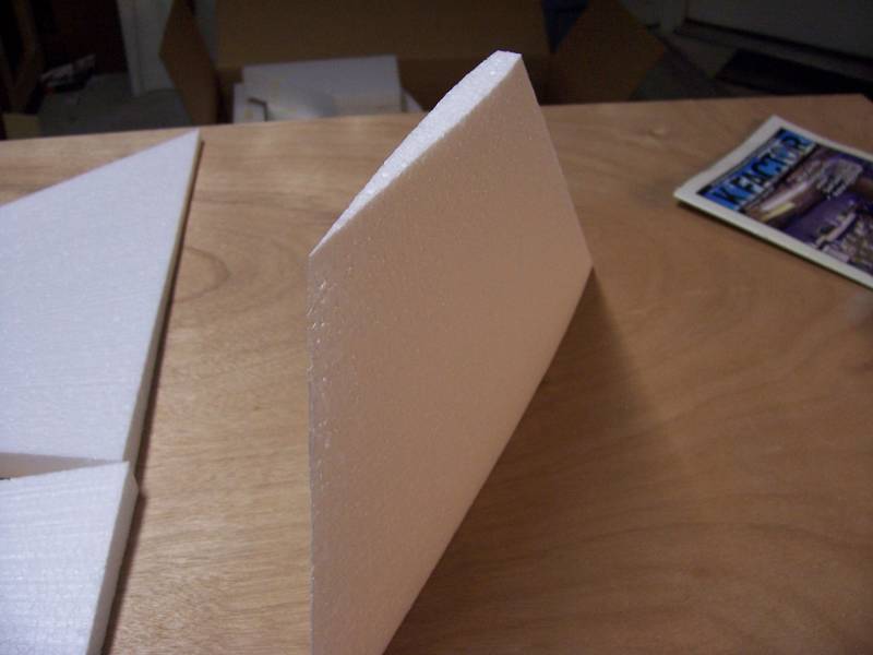

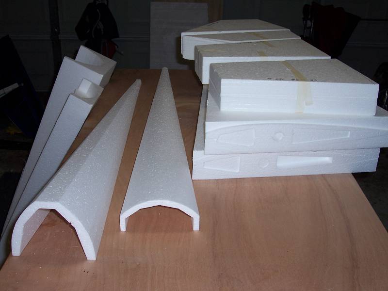

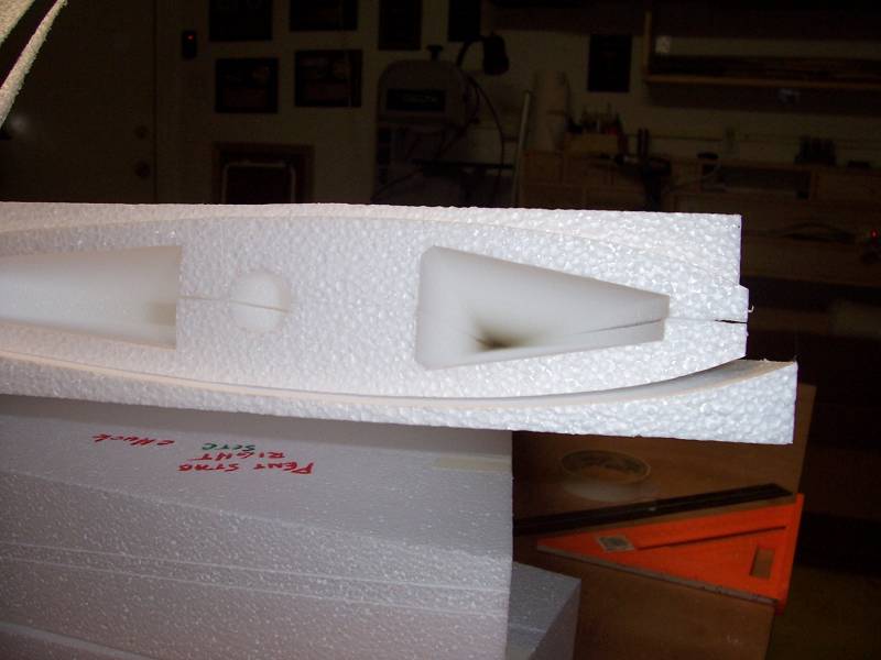

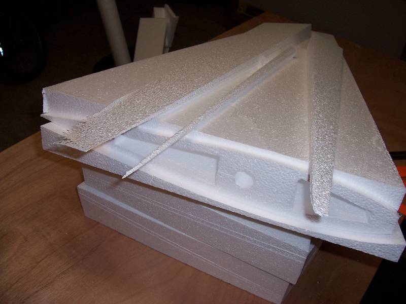

Sorry, just realized i missd some of the foam parts. Please note, these parts are CNC cut and are awesome!!
Notice: the wings are cored and remove an ounce from each panel !!!
here ya go:

Looks like a nice kit. Are those wing panels cored all the way through to the tip? Any pics of the tips?
Old 02-13-2007 | 11:53 AM
RC_Pattern_Flyer's Avatar
Joined: Aug 2004
Posts: 1,119
From: San Antonio, TX
Default RE: Pentathlon Build Thread
Funny you should ask, i was getting better pics together this morning to add so people can see the completeness of the kit.
Enjoy!

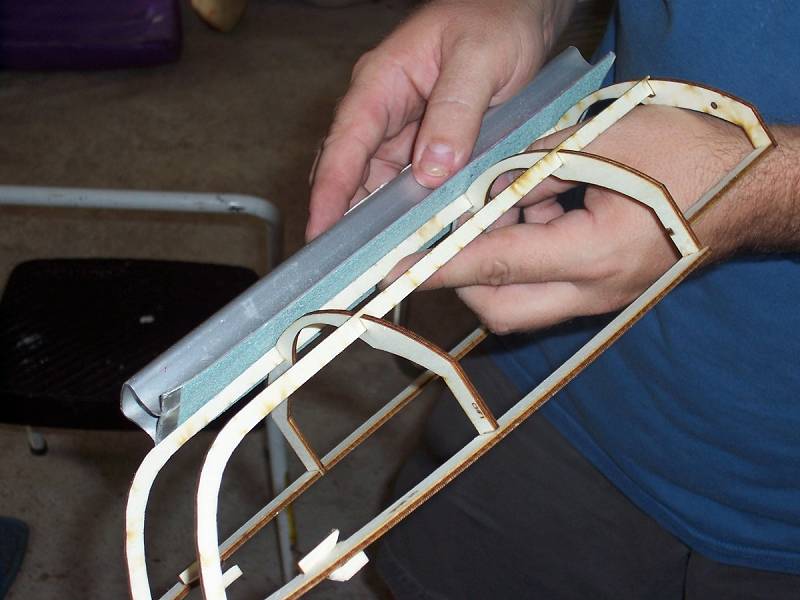

Ok, now is when i start the first humorous part of the thread.. i call it humorous cause if i didnt laugh about it i would be crying my eyes out, thanks god i am going to make this one electric... let me explain.
Mark designed the fuse to be built upside down, when it is upside down, there are laser words say "top fuse this side up" , "bottom fuse this side up".
SO.. here i go, i get out the big ole ruler, draw my line on the building table and start gluing.. woo woo, look at me go, 10 mins and the fuse top and bottom are slotted together, dead straight.
Next, test fit all the formers, landing gear plates, nose ring, nose former, wow, this thing is built and together with no glue awesome.
-Disassemble and grab the square.
Slot, tab, glue slot tab glue (squaring each piece), more slotting tabbing and gluing... look at me go, i am awesome.
well, NOTE TO THOSE WITH A.D.D. DOUBLE CHECK THAT THE FUSEBOX IS BEING BUILT UPSIDE DOWN!!!!!
so i assemble the model and stand over it proud father on the machine to be.. i rock. i take pics, i send to mark ....
THEN.. i take measurements and send to mark, he quickly slices the 3d model and sends me back the EXACT former i need to cut out. SO, off to the band saw, whack slice and dice, one new firewall for electric motor from www.2Dogrc.com and i am on a roll. ( i used birch ply for this as i fear the dreaded outrunner flex front)
SO.. then i get another email and Mark has generously taken a top view of the plane with the former in place. yes, where to cut new slots and tabs so it just DROPS in, OMG this is too easy.
Back to the band saw, more cutting, more sanding, more pride (silly me) and away i go... notch here and notch there on the fusebox....it slides together perfectly.
At this point in time i crack open a refreshing cold beverage of choice and admire my work... onto beverage # 2 as i imagine everything dropping in place but something keeps giving me that not so fresh feeling.. whatever could it be...
i measure some more before i decide to glue in the firewalls...things seem different, or at least uncomfortable, i keep having to flip marks drawings to get them to fit properly.
nother refreshment, if i keep em coming maybe things will get back to normal....
Ok, tings are just to wierd, then it hits me like a bullet train and a flyin the wrong spot at the wrong time. I ASSEMBLED THE BLOODY FUSE RIGHT SIDE UP.
Now, you might think this is no big deal but as geometry and my enthusiasm collide, i have built in 2 Deg of perfect left thrust. oh yes, i said LEFT.
How in the heck did i do that, back to marks instructions, reading the fuse tops, everything says this side up.. oh yes, another beverage to now start easing the pain...
a quick phone call to mark to let him know i am a MORON and i can se him shaking his head, why did i have CHUCK do a build thread for me... why why why
mark, you are my ambassador of Quam... anyways, more notching, shifting.. THANK GODDING I DIDNT GLUE IT.
I now have 2 deg of right thrust and 0 deg of down thrust.
So, it didnt take too long for me to CUSTOMIZE another of Marks designs, its amazing, i could screw up an arf i bet.
Anyhow... things are back on track again and away we go....

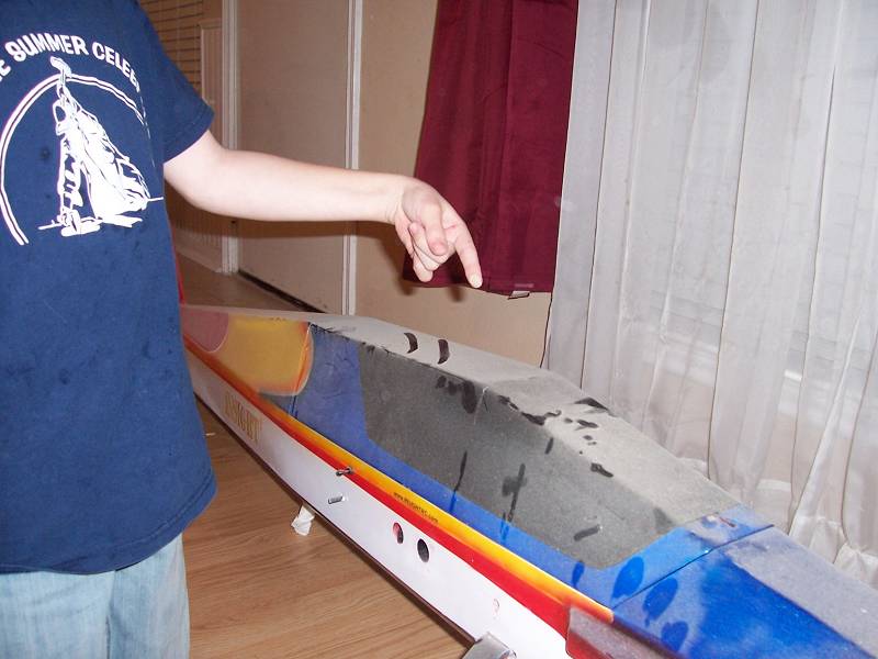

No doubt that this thread will have extrememly high entertainment value! I have to admit though, it is easy to get carried away due to the assembly speed of the fuse frame.
Other than the upside part, the fusebox looks good. Please make me aware of any (yes, ANY) issues with tabs not fitting into notches and the like. I have found that even with a couple updated laser drawings, it is still easy to miss a small offset for the laser cutting here or there. It is usually not a big issue though as the laser burn width is a scant 0.010". However, for a nice, tight fit (), it is necessary to account for the burn width. I would like to keep updating the files so that within the first 20 kits we will have every little issue worked out.
Love the pics, keep them coming. Also, let me know if you are going to be in H-town anytime soon. I would love for you to get some stick time on mine....I know it will provide good motivation for your build.
See the pic below....I added a couple pieces of light balsa stick to strenghten the joints on those long fusetop and bottom pieces (I think I mentioned this in the build notes).
Regards,

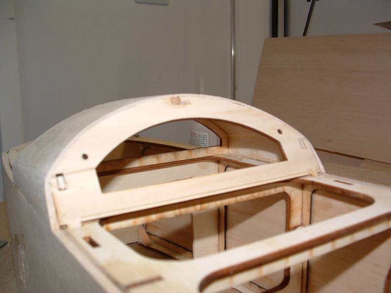

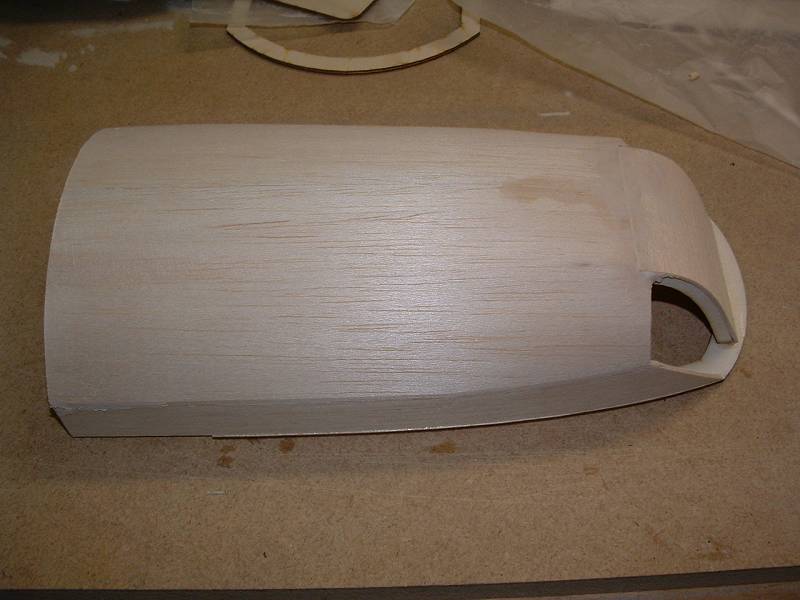

Well, got to playing around with the parts and built the chin cowl framein 3 minutes.. hehehe i love this:
CHIN COWL FRAME-

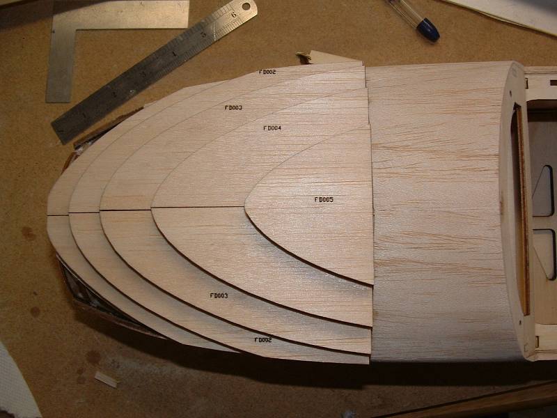

Chuck,
Just in case you feel like sheeting the chin cowl...don't. Not yet anyway. It is alot easier to align the chin cowl pins without the sheeting in place. I have updated the laser parts to have the holes on the front end of the pipe tunnel already in place...but you got one of the early kits.
It's hard not to get ahead of yourself isn't it? Snapping together all those lite ply bits is kind of fun.
-mark

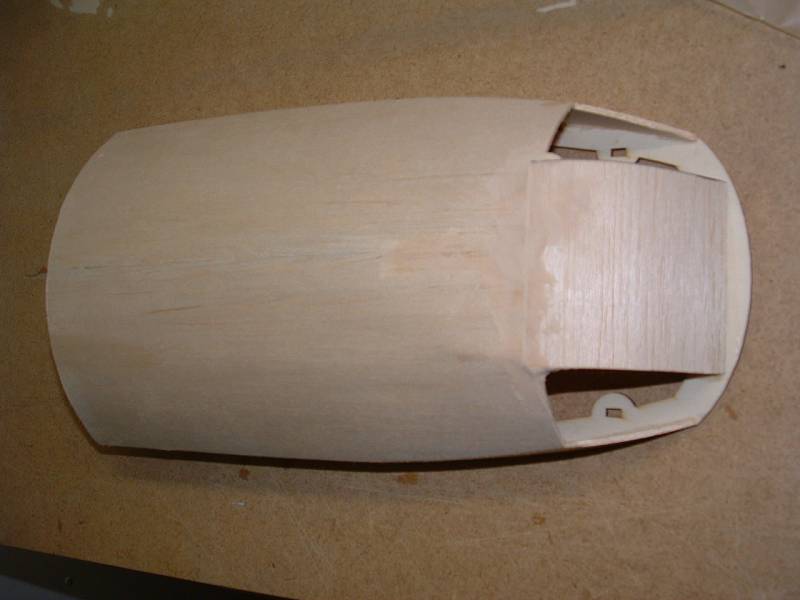

Uh, huhuh, huh uh huhh uhuh.. wish you had posted that 2 hrs before, as I got builders fever and sheeted it. I did my sheeting a bit differently than yours as I enclosed the center portion and left the side open. I did this for looks that i saw that i liked and without the head of an IC motor to clear/cool. So... i will however before i build the "pipe tunnel" mark the front pieces with the chin cowl so i can easily drill it out.
Thanks for nothing! hehe j/k for others building TAKE NOTE!

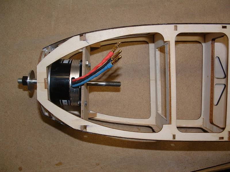

Here is the motor mounted to the new firewall, note that the large shaft out the back was intended for a nosering mount installation which was not practical for me so i ordered the adapter and mounted it MY way, hehehehe.
Anyhow, fits nicely and as good airflow with nice large holes in the back to allow air to pass through the motor.
Enjoy..

The Entire side of the fuselage is upposed to be sheeted with crosgrainsheeting from behind the doubler to the tail. I choose to just use a capsrip method to space the siding enough to make up for the missing sheeting. this takes a little strength away but without the vibration of a thumping IC motor we fiured it would be ok
here is a little shot of what i am refering too.
Well, just went searching fo the picture and it is not so great, i will post anyways but sorry for that! Basically, whereever there was a former , joint, top or bottow of fuse, i put a cap strip of balsa to space the fuse side the proper distance out and allow the doubler to fit properly.

Here is an example of what i have been doing to all the parts to save weight... i hope it all adds up.
AND
Here is a picture of one fuse side on it fit perfectly and slotted right where it was supposed too.

Ok, adding the other side tonight and also added the turtle deck at the rear of the canopy. Some more sanding as well.....

Here i have put together the front turtle deck and also the top of the motor box.
Enjoy!
