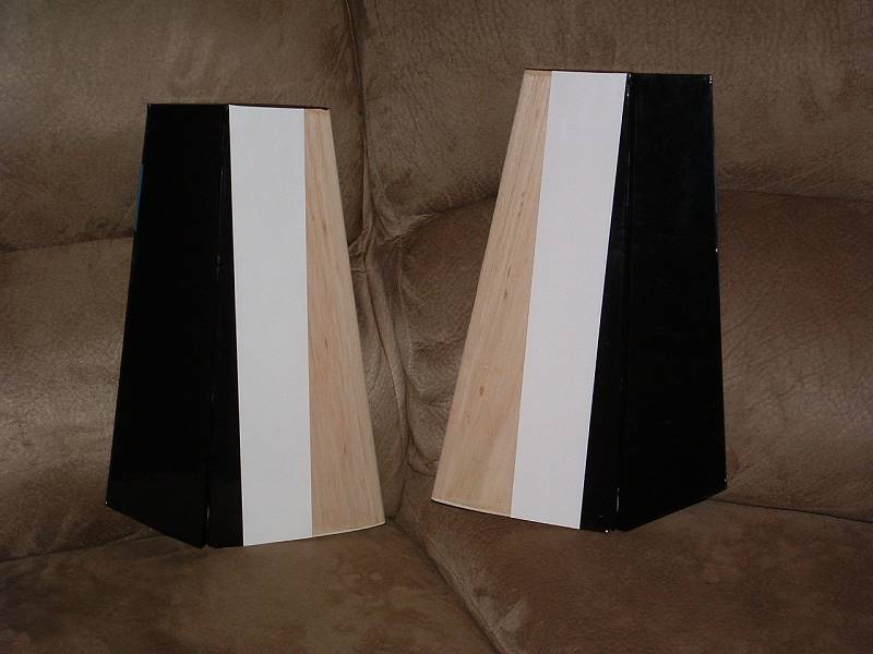

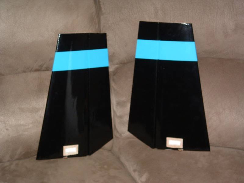

Ok, so i have been covering a bunch this weekend, the stabs are to a point where all i need to do is match the paint on the fuse, red at the leading edge, then some yellow swooshs (nike like) to blend to the fuse at the root area.
Here are the stabs, blue stripes on bottom. I used coverite microfilm for the black and due to outstanding availability the white is ultracote and the blue in monokote neon blue.
As you can see i have great BRAND loyalty, hahaha.
As far as some weights... stabs are identical in weight, before covering stab and elevator: 1.8 oz after 2.1 oz
note, still need red and yellow stripes.
Not to mention, i will be flying JR servos with a Futaba Reciever and transmitter and a Dualsky motor package.
moving on, pics please!

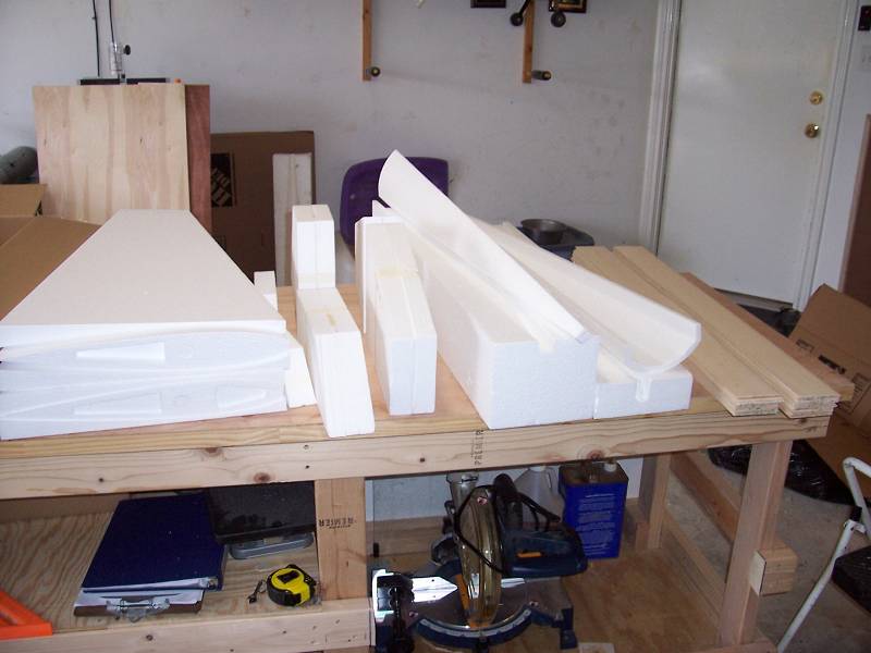

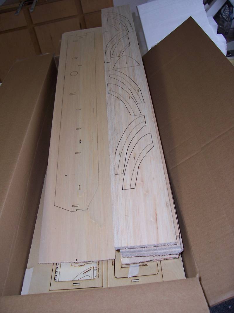

I guess it is finally time to make good on my promise of doing an more detailed build. Now that there are a handful of kits out there, it's time I got started. I still have a few odd things to finish up this week, but I will be getting started on the build.
Step 1
First, inspect the contents of the kit...make sure everything is there.
Have a look at all the foam parts and make sure there was no shipping damage, etc.
I start by sheeting the foam parts. I prefer to do this for a couple of reasons. The most important, being that the sheeting process can take up a good bit of workspace. Those with a big shop (and/or awesome shop like hanglider) can afford to do this while building on the wood fuse frame....read envy here.
Those that purchase the kit with all of the 1/16" sheeting will need to inpsect the sheeting and begin truing the edges of these sheets. I normally use a long straight edge and a sharp razor. You can also setup a straight edge sanding jig to do the job.

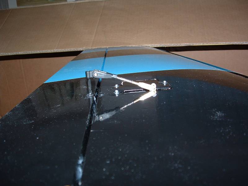

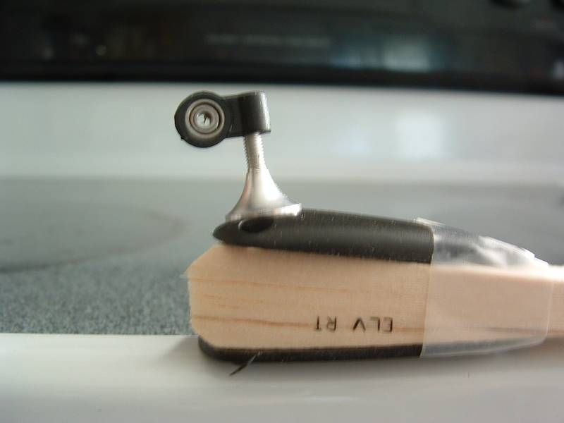

Ok, so i finally got through with covering as far as i can and things are going great.
Wings are curently at 10.6 oz with 80% covered. i figure as best i can ready to fly weight to be 13 oz each.
here are some pics of the bottom of the wing.

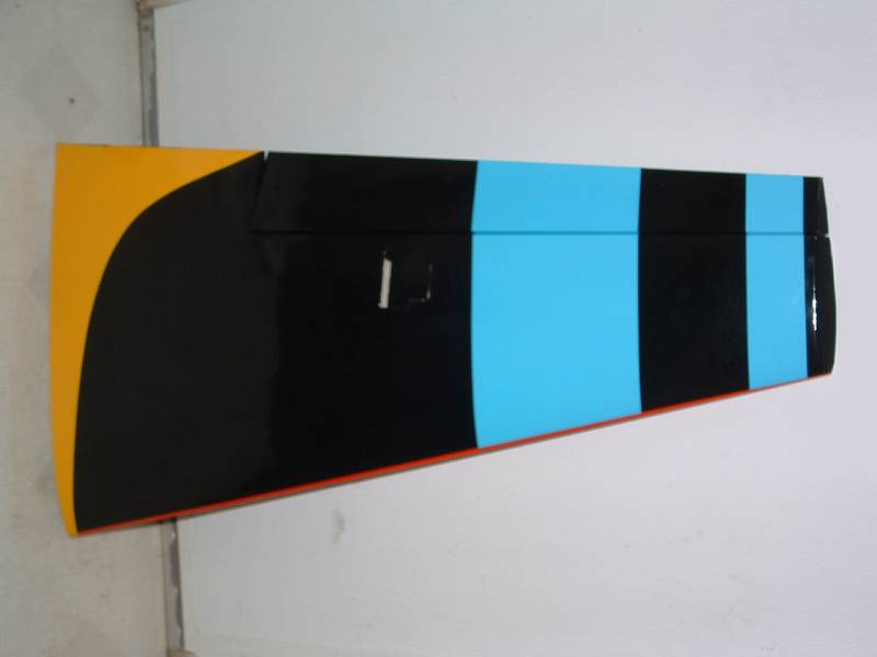

Richard, right on, the pentathlon will have its ailerons driven by Jr 821's.
originally 9.5 oz bare
i have completed the wing except for graphics... here it is: weighing in at 10.9 oz currently. servo=1.5oz leaving .6oz for servo ext. and pushrod.
enjoy.
Chuckles

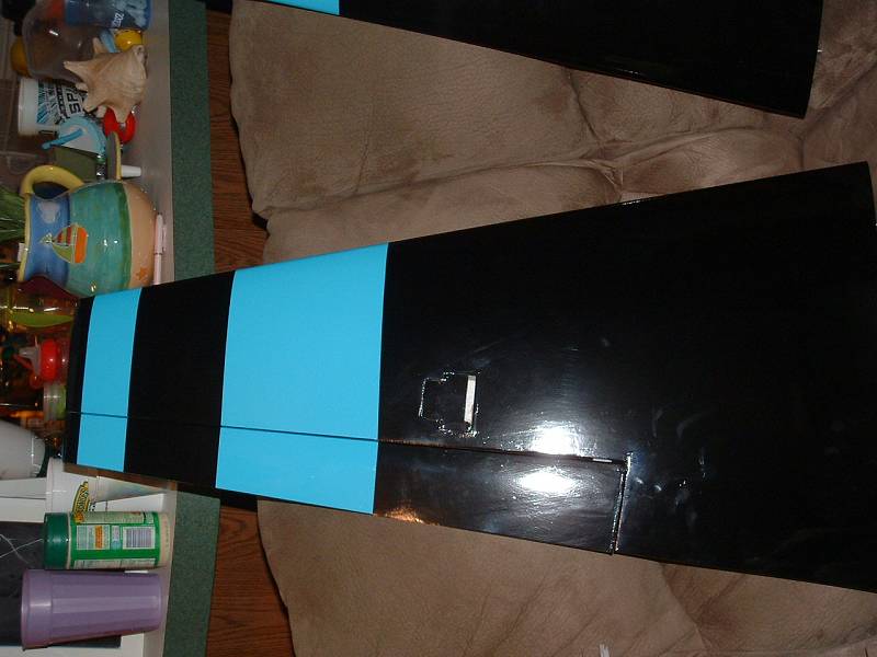

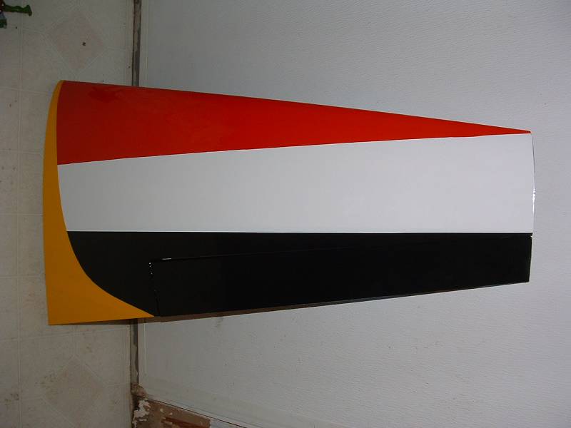

OK!!!! wings are DONE, setup and ready to bolt on.
ratatatatatatatatat... Left wing 12.9 oz Right wing 12.8 oz
