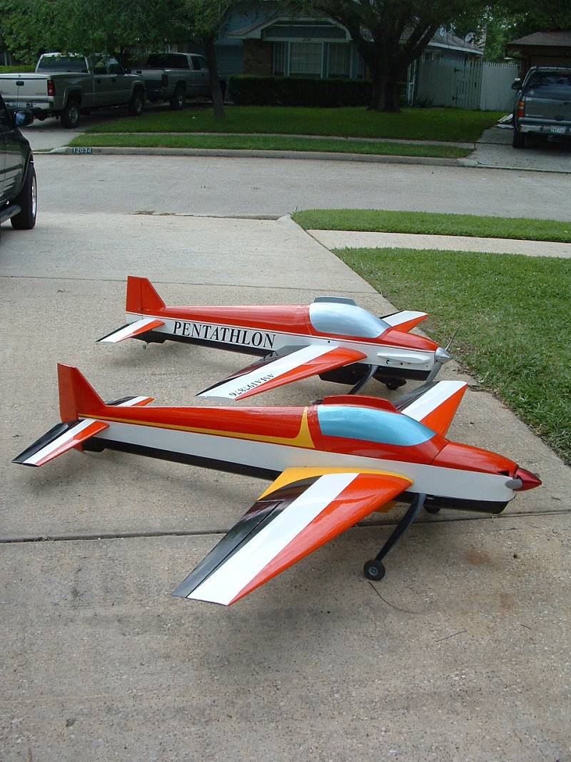

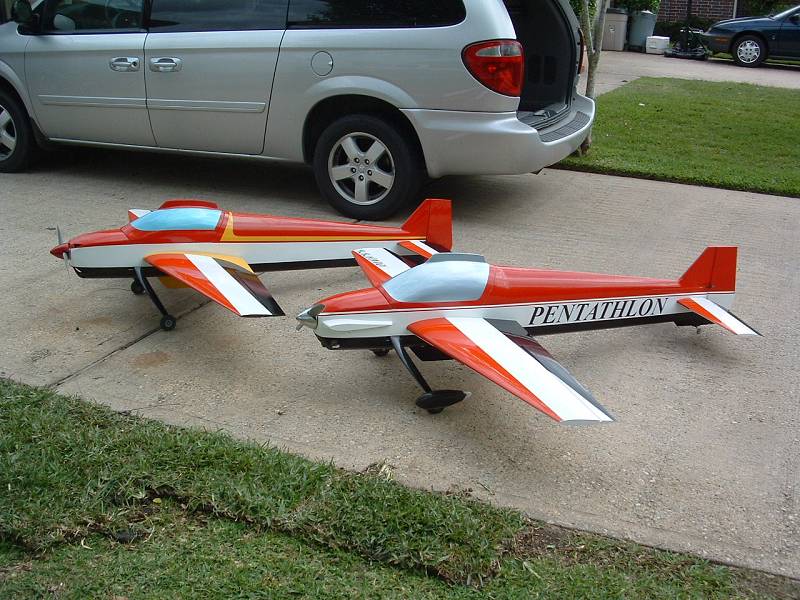

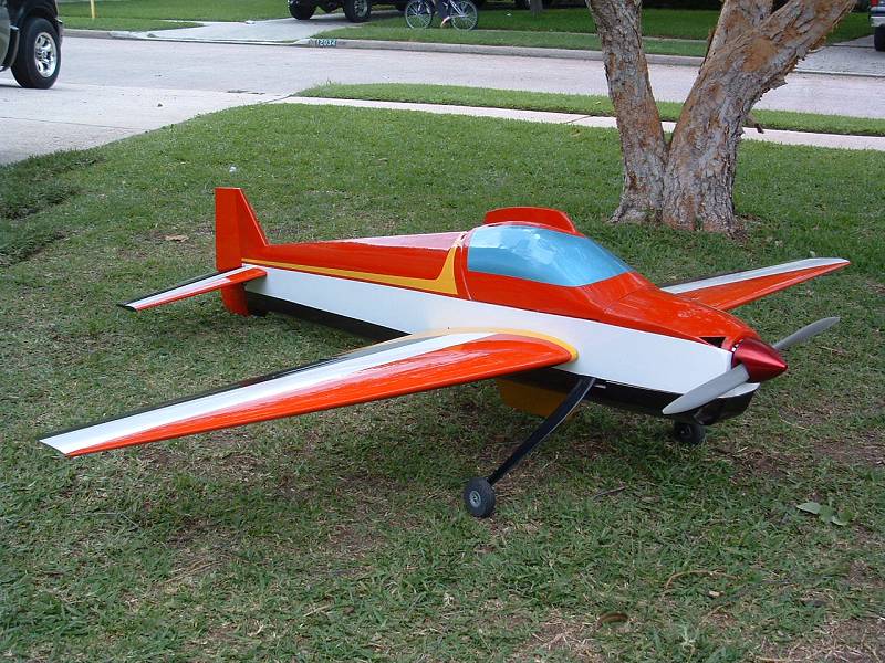

#107
Joined: Aug 2004
Posts: 1,119
From: San Antonio,
TX

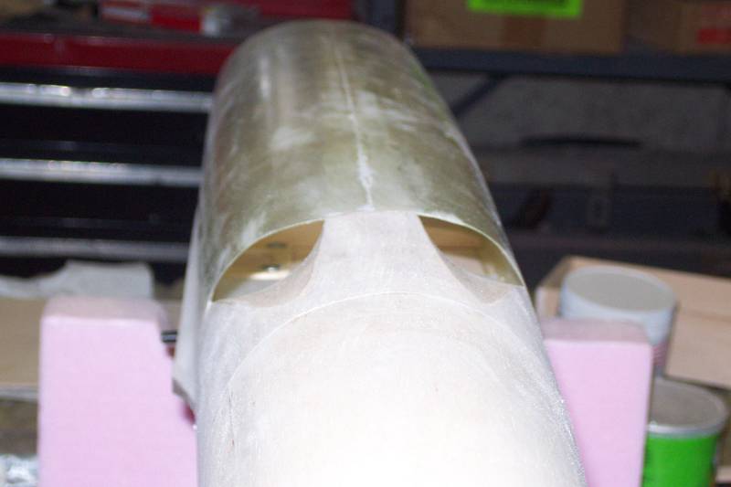

OK, need to make a small jump here, i made a ton of progress this weekend. In fact, she is darn near ready to fly!!!!
I want to thank Jim, Richard and Mark for their tremendous help, guidance, coaching, and generosity!! you have no idea how much i appreciate you guys.
So, without further blabbering. I present, the almost finished prototype #2!
Chuck Hochhalter
Chuck Hochhalter

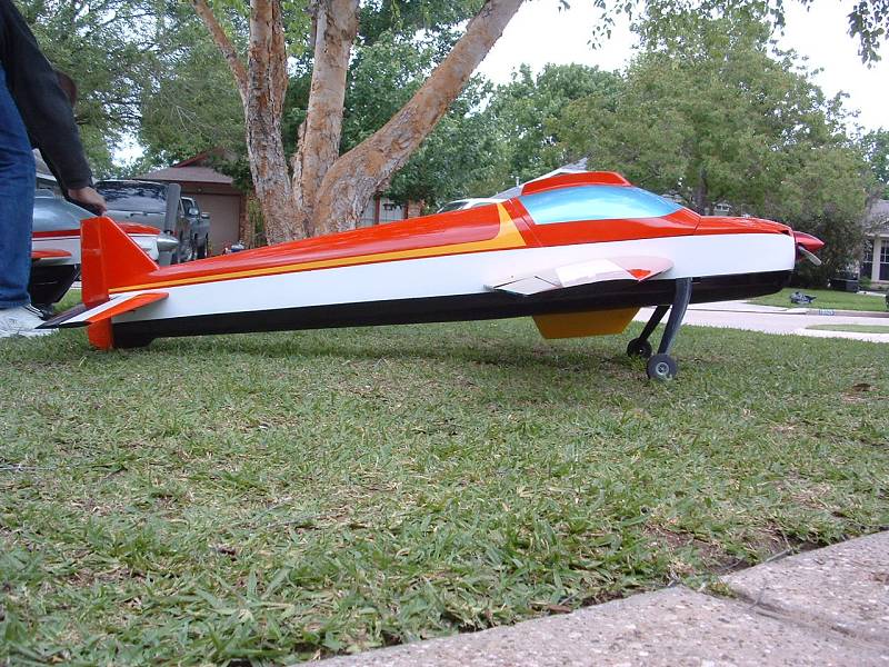

#117
Joined: Aug 2004
Posts: 1,119
From: San Antonio,
TX
Randy, the kits comes with 2 different root ribs for the stabs. There are many opinions on whether or not the anhedral stabs help, Naruke does it. hehe .
Seriously, i would appreciate and opinion by Mark Hunt, the designer... maybe Troy Newman chimes in, both his planes the Adventure and the Astral XXVISTR have anhedral stabs.
Personally, i think it looks COOL!
Few more pics tonight..
Chuck
Chuck
#118
Joined: Aug 2002
Posts: 391
From: Tomball,
TX
As a fellow Anhedral flier, I'll comment that I feel like it provides some benefits in outside/pushing maneuvers and inverted flight. It seems to make the rudder correction feel like less work to correct while maintaining heading and attitude...
What are the advantages of a straight stab over the anhedral stab.....? Can't think of one.
It is also quite sexy looking...
Also, I do not believe that the kit is offered with the straight stab. If desired, I'm sure a custom version could be negotiated, but why would you want to build a plane any other way than the designer intended?
Richard
Richard

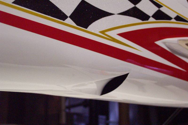

#124
Joined: Aug 2004
Posts: 1,119
From: San Antonio,
TX
Umm, yeah, what they said... i say FLY THE PLANE MAN... FLY THE PLANE.
J/K.. I got the stabs fully glued to the fuse last night and the pull=pull narly completed, just need a bit larger servo arm and sme kwiklinks to button her up. Cut the hols for the cables last night, shaky hands the whole time, hate that feeling of no return.
Tonight, plan on finishing the rudder and then, deciding where and how much cooling to cut in the fuse to relieve air out the bottom... really not looking forward to that!
Any thoughts?
Chuck
Any thoughts?
Chuck
#125
Posts: 379
From: Agawam,
MA
ORIGINAL: RC_Pattern_Flyer
...deciding where and how much cooling to cut in the fuse to relieve air out the bottom... really not looking forward to that!
Any thoughts?
Chuck
Any thoughts?
