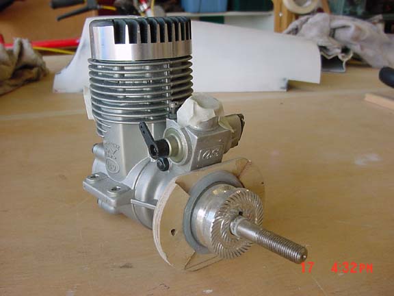

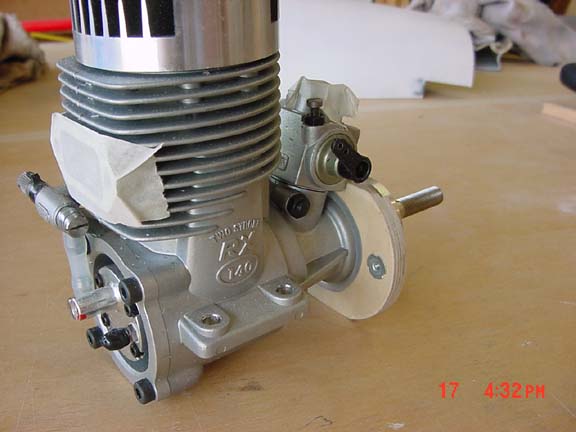

Most Hyde type soft mounts rquire a nose ring. If you get any kind of osilation with a nose mount you should nose ring it.
I have made my own nose rings. Use 1/8 ac ply and split med. fuel tubing for the insulator.
See photo...
See photo...
Posts: 821
From: Plano,
TX
Homemade nose ring.
When sizing the hole just use your dremel sanding drum a little at a time till there is a snug fit. A little silicon on the tubing makes it slide on easier. Easy to replace the tubing when needed and no need to special order a nose ring. Fuel tubing is in my tool box. I replace the tubing about once a season so far.
Wayne
Wayne
