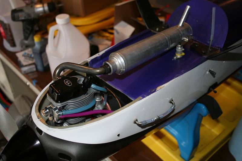

Guys,
Periodically I've had some people write me and ask me specific questions about how things are installed in my plane, or where they are and other questions to help with builds. I've decided to just post a bunch of the pics, so that as people ask, they are here to reference. On the chin setup, it does not fit that poorly...I only had the front screw in as a demonstration and it wasnt aligned correctly...the chin fits perfectly when mounted. Here is the setup that I'm running in my plane with servo choices.
YS 1.70DZ with 18.1 X 11 prop…I REALLY like this prop. Just a hair faster than the 10 on a windy day, which is nice, but gets rid of the loud bark too, so it will make noise much easier. I have about 25 flights on this combo and really like it.
CG ¼†behind leading edge of wing tube
Stab incidence 0
Wing incidence: a robart meter pointer thickness below .5 degrees positive
Radio Equipment all Futaba.
Elevator: 9254
Rudder: 9155
Aileron: 9154
Throttle 9650
Elevator
Up 13 degrees
Down 12 degrees
Elevator Snap
Up 20
Down 17
Rudder
22 degress right and left
Rudder Snap
16 degrees right and left
Aileron
Up 13 degrees
Dn 13 degrees
No differential, this is nice!!
Aileron Snap
Up 17 degrees
Dn 17 degrees

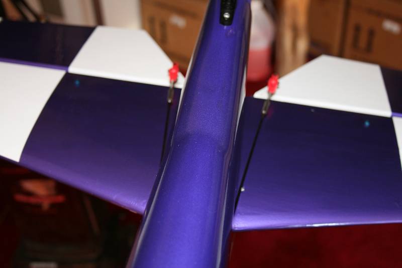

Pictures of the fin area,
Arch

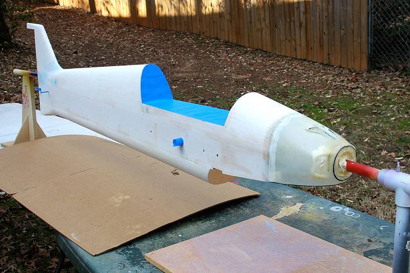

Hi all,
today I finally had warm temps to do my primer.
I finished the fiberglass / micro balloons base off with 220 grit and the block, like I was preaching back a few posts. I got her back on the scales - I am now + 2.65 oz for my fiberglass base, way better than I ever imagined - oh yea happy with that....
Next I taped and masked off the entire plane and installed my nose mount for my painting jig. Mixed up a 3 oz batch of PPG K-36 and with a 2" foam roller, rolled out first a heavy coat then a light coat. I also rolled out the rudder. Once happy with that I sprayed the cowl and chin with my new primer gun a friend gave me. He bought it off the Matco tool truck and it works really well, better than the Cobalt gun I got from Lowes. I installed this 15 dollar pressure gauge - you really need that gauge....
Rolling really kills a lot of the pin holes after I was finished I didn't see a single pin hole.

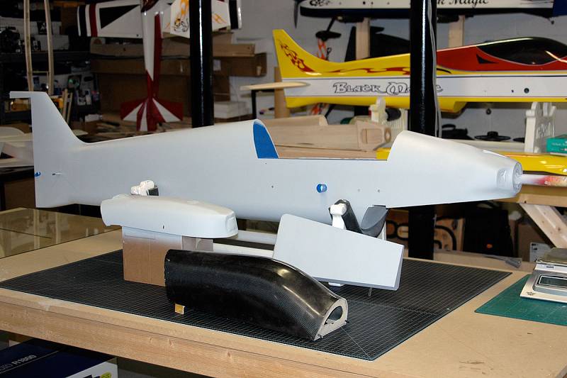

Here is the primed plane, cowl and chin. I'll be glazing and sanding tomorrow. I start with 180 grit and finish with 320. I'll be sanding about 90% of this primer base off. Should be fun
Not sure yet if I'll do another light primer coat or go right to a white base coat yet...
I also just got in the full catalog of SEM candy and opaque colors. I'll be having fun with this paint scheme !!!

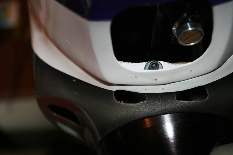

An you thought you were done with ?'s. Can't seem to find this anywhere. Is it a tank surport an tie down.
I am planning to monokoteing, do I need to beef up any one area?

Wendell yes that is the fuel tank mount.
No beefing necessary. Watch the weight!
-Mike
