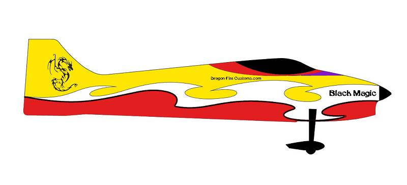

I finished wet sanding my primed fuse today, I went to 600 wet. She is now 100% ready for base color. I am working up scheme drawings. I've attached a rough drawing of another "Fire Dragon" scheme, taking what I did on the Red VF3 I did last summer and really pushing it a little further with the tribal look. I am also working on the Dragon Head graphic that will be on the nose of the plane.
I am trying to create a scheme with no straight line segments, eveything will be done in spray mask, designed on my computer and cut with my vinyl cutter. I am fairly close with the basic layout. I am just figuring out how to do the Dragon graphic....

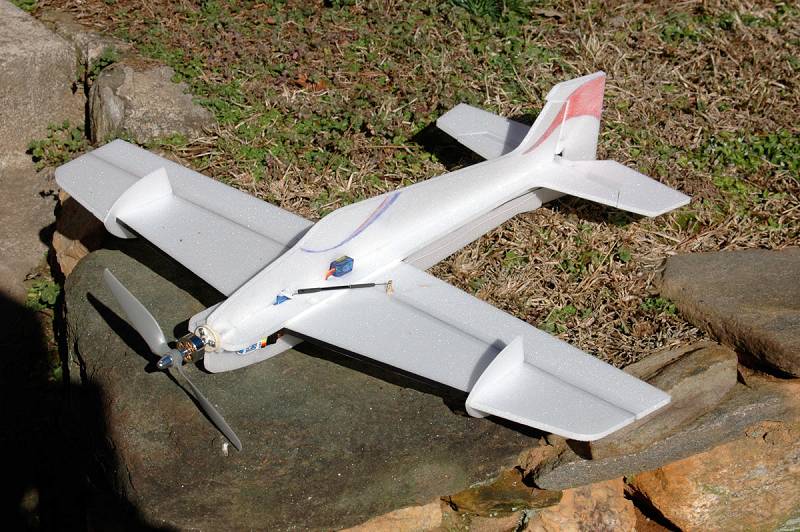

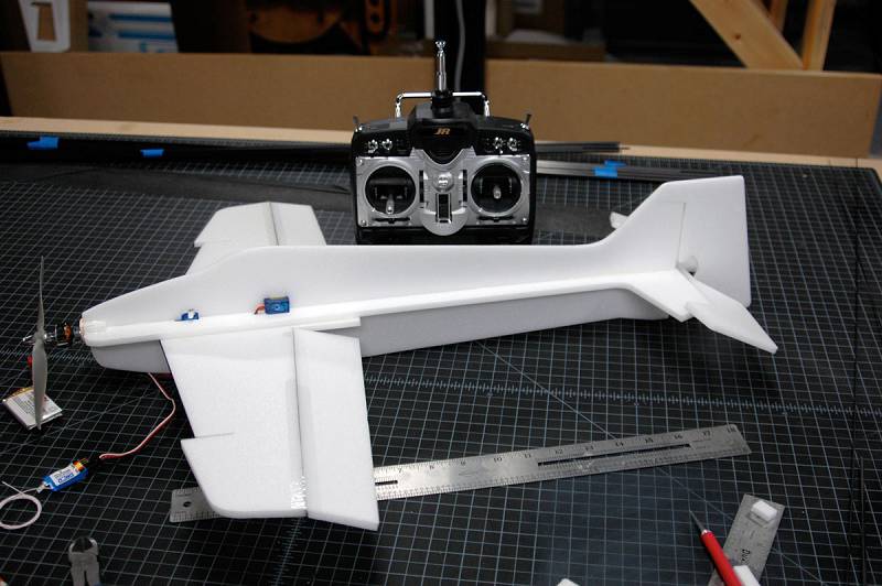

I drew up and built my new prototype Mini Black Magic Foamie - It's got a 24" wingspan, made from 6mm depron, all up weight of 4.75 oz with a 20g CD motor, 3c 350mah TP pack, 3 6g servos, berg UL rx and 10 amp esc.....
It's designed for high speed aerobatics, flew it today in some really stiff winds. The winds where over 10 mph and gusty.
And boy was it a blast. Now it will fly slow, hover and 3D. But this little bugger is designed for speed baby speed....
I flew it about 6 times today - a little over 60 mins. and I am still smiling....

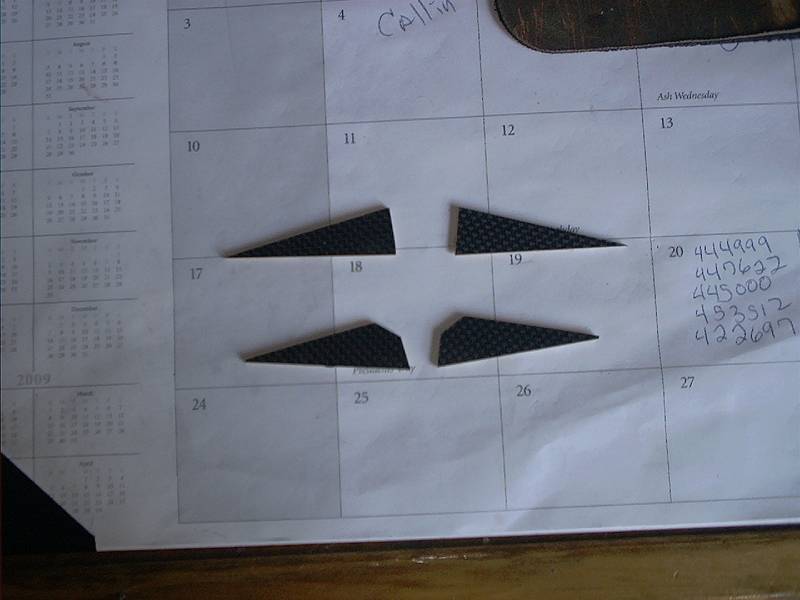

Anybody know were these go, Better late than never. These are for the BM3
Hi Wendall,
I tried to answer your personal email but you have a tight spam filter and I can't reply to your personal emails.
those are braces that attach to the front of the turtle deck former and secure to the top rails....

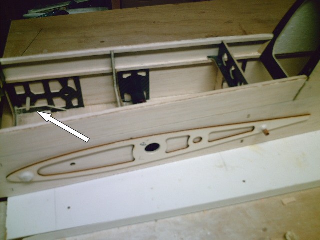

O.K in this piture where I inserted the arrow is a wing nut bolt, my ? is shouldn't the hole that the bolt go's threw be elongated so when the wing adjuster is adjustedthe wing can move an wouldn't it be better for the adjuster to be in the front?

Wendell, again it goes back to that prototype kit
Cass wanted to use hard points in the wings instead of the standard root. He was going to cut off the rear of that front doubler and use 2 more adjusters there.
Now, what you have is an arrangement similar to the electric set ups. You just have a little extra doubler there LOL but that's not necessarily a bad thing at all.
Now about the question: yes and no. You want to open the hole up just enough to accept the bolt and not bind the wing if/when you adjust it. The best advice is to set it on the table at about .4 degrees positive and only open up just enough to pass the bolt without binding. I garauntee that if you do it that way, you will be in good shape and not have to open it any more. The more you remove in the hole the more prone you are to having some type of a failure over time.
So, just do it that way and call it a day. It doesn't take me more than a few passes with a round file and I'm done.

Ok that threw me for a loop
I assume yours have the other set of holes in the front correct?
If so the adjusters go in the front hole. Don't open the bolt hole too much, only enough to pass the bolt. if you find you need to adjust the incidence beyond what the bolt hole will allow (I have yet to see this) then just elongate it SLIGHTLY with a small round file.

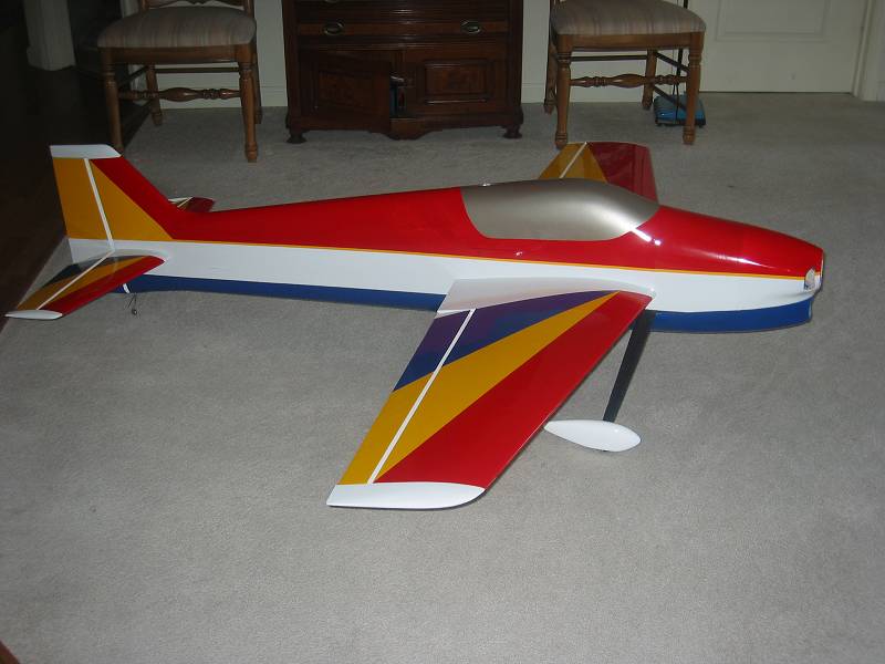

Hey guys... got another Black Magic V3 coming out of the hangar soon. Will be ready to fly in a couple weeks, a few things to figure out yet. Will be electric with equipment to be named later, but it finally looks like a finished airplane. It is being built by my retired father, Al Messer, and when i first saw it I swear it was the biggest pattern plane I had ever seen... but once it got covered (yes, not painted), everything seemed to come together.
Good airplane Mike, looking forward to see how it flys!
