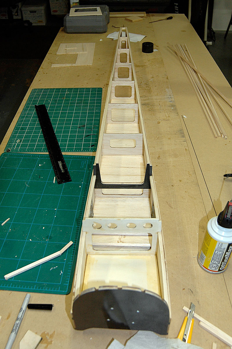

Let’s get this thread back on topic…building VF3’s!
Not being one who enjoys repairing gear blocks, I’ve added some 6 oz CF to secure the front of the gear block since there are only shear joints preventing the plate from twisting out. I’ll also add reinforcements up the sides once the stringers and sides are cut for the gear.

After seeing some failures on the 2s, I discovered that the main weakness in the 2 was that the edge is essentially only bonded to the 1/8" doubler at the sides. As long as you never have a bad landing or don't drop it in hard in grass, you won't break it. (err ok SHOULDN'T, you should see what mine went through!)
From the pic you can see how I addressed this on the VF3s. All it needed was that extra little doubler over the top, and all is well. A couple bazillion flights and not one VF3 gear failure to date.
One thing to take SPECIAL note of is that any time you are glueing to the carbon laminate, you MUST rough up the carbon with 80 grit paper (knock the shine OFF) and clean it thoroughly with acetone before glueing to it.

#131
Posts: 379
From: Agawam,
MA
Thanks for the offer Mike (gotta love that support!) but I'll laminate some 1/16th crossgrain balsa with 3/4 oz cloth (ala Brio floor) for that front piece. That should give me a lightweight, weather proof structure with ample strength (I always worry about flying in the rain with an electric!)

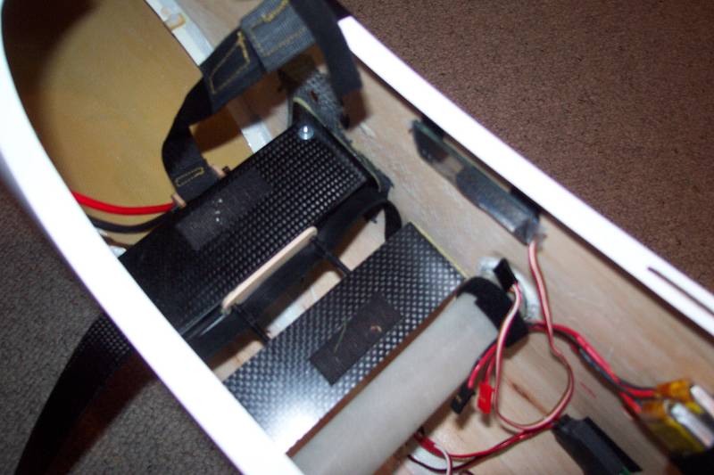

Also post up your battery support tray when you get there. I am always looking for a better way to build that mousetrap using as much existing structure as possible.
-Mike

#134
Posts: 379
From: Agawam,
MA
It may be a few months before I get to that so here are a few pictures from my Prestige to spark some ideas. I utilize the gear plate to attach a 3/4" nylon strap (much lighter than Velcro) that runs down and around the wing tube and Velcro’s back onto itself. (Gear plate and wing tube are after all the strongest structures!)
A secondary Velcro strap then goes perpendicular to the main strap. That strap is secured underneath by 5/16†CF push rod material (used in a couple places as seen in the pictures.)
I’m sure I’ll do something similar on the VF3.
(My datalogger goes in that 'open' piece of Velcro)

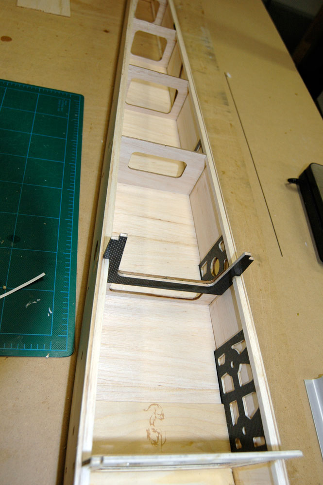

#148
My Feedback: (23)
Hi All !
okay okay - it's been like 3 months and I had a few other side projects cooking, meets, districts, road trips, foamys, etc etc etc..... I know I know
SO.
Let's get this build thread back on track. Here is the basic fuse crutch fresh out of the jig. It's under 10 oz.
SO.Let's get this build thread back on track. Here is the basic fuse crutch fresh out of the jig. It's under 10 oz.
#149
My Feedback: (23)

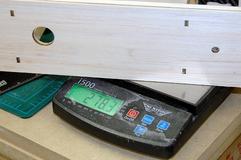

Fuse flooring:
I drew up a temple of the flooring. I am building one of Mike's early kits and I do not have the laser cut flooring. I took measurements off the plans. I butt glued 2 pieces of 1/8 x 4" wood and had at it with the knife. There is a bit of sand to fit and triming to get it perfect. Take your time fitting the flooring as a messy job here really looks bad and is hard to hide, there is nothing like perfectly clean balsa floor. Trail fit all the flooring do not glue anything yet.

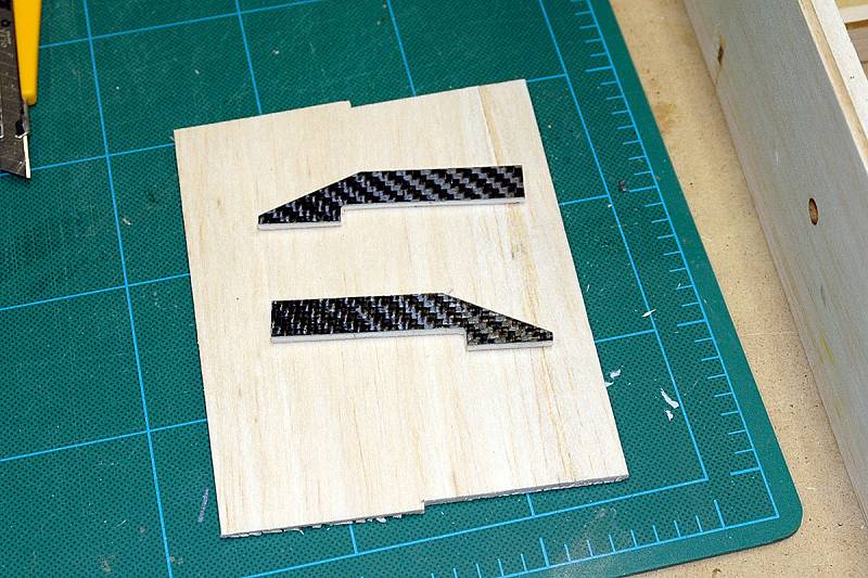

#150
My Feedback: (23)
Landing gear block doubler
Locate these cool carbon composite doublers, they will need sanded a bit, mine had some CNC flash. Trim the balsa flooring at the block, make it a nice fit. I roughed up the mating areas of the main doubler and clean it with acetone. I used west systems 105/206 for the block doubler.
First install the block doublers. Then fit all the balsa flooring and CA with thin then follow gaps with thick CA. I run a bead of thin CA on both sides of the flooring.
