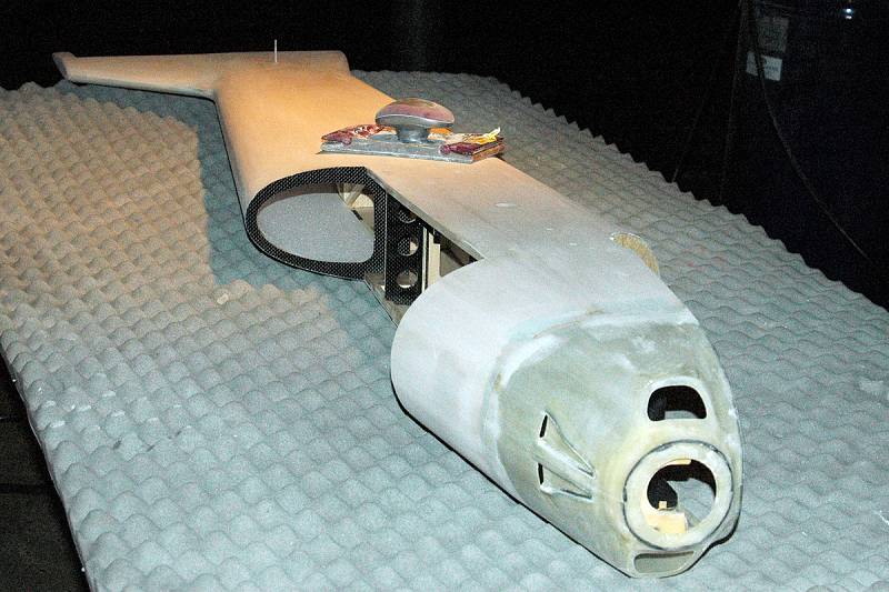

#332
My Feedback: (23)
I started sanding the glass base tonight. I am working outside under my point light, it's dark and cold out tonight, it's in the 40s tonight.
I first weighed the rough trimmed fuse . I am now at +3.65 oz with the final cure and rough trim. I am going to start working with 150 grit on my larger 3M block sander, I got this from Lowes or you local hardware.
I uses this large foam sleeping/camping pad on a 30 x 72" table. Just start working the block. Do wide passes with the block, you will be making lot's of white dust, use compressed air, make sure you have an air cleaner. I have both a large moisture trap air cleaner at the tank and this little turbo air cleaner at the air gun. You can get these little turbo in-line air cleaners at you local auto paint shop. The last thing you want to do is spray your plane down with nasty slimy water.
You can see in the close up shot, the texture that you are trying to sand off. The raw surface will looks like cracked hard mud - I guess. You can see it in the close up. Overall the surface has a white milky - frosty look to it.
What you are trying to do is sand off all the micro balloons right down to the top of the cloth. The 150 cuts well. Also notice you will have to change the paper about every 15-20 mins the paper will get coated and will just not cut as well. Just keep working the block it's really a big mess and should be done outside an always use a dust mask.
As you remove the balloons the fuse will get more of it's balsa color back. Just take your time and keep your eyes on what your doing, don't sand thru the glass.

#335
My Feedback: (23)
After about an hour, it got a bit too cold and it was getting late enough to call it quits for the night. I brought the plane into the shop - under the shop lights. It's weird how your eyes adjust, you are now able to see the surface differently, your able to view the surface as more of a whole. I noticed I may be less than half done with the surface prep. Looks like I'll need at least another one hour session to get all the way down to the weave over 100% of the airframe.
The fuse went back on the scales, I am now +3.3 oz. wow - I am thinking that I could be at +3 oz or maybe slightly better for the glass - and that my friends would be "super awesome". I'll be back on her tomorrow. At this point I am not in too big of a hurry, my paint booth is an unheated 2-car garage (really not that big of a problem here is the southeast USA) and there is a major winter storm coming and it's going to be too cold to paint for a couple days. That's ok, I've got some graphics to cut and ship...

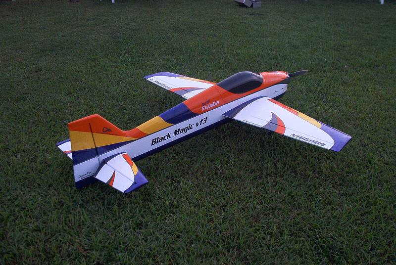

#340
My Feedback: (18)
I am no Don Szczur by any stretch of the imagination, and when it comes to building, I am not even Don Knotts, but I have to say that so far I really like the way the plane goes together. I am not intelligent enough to imagine how in blue blazes someone could frame one of these up in a week though. I have been nearly six months, admittingly working on it two days a week, to get it to this point. That is still about 48 building sessions. I am probably one of the slowest and least experienced builders in the whole pattern forum so that should be taken into consideration.
I have to agree with Mike that there really isn't anything particularly difficult on it, even for a hack like me. I have to really thank Mark Atwood for holding my hand along the entire way. He has taught me how to correct just about every mistake I can make, and I have made some real head scratchers. You should see the look on his face when I complete a step and say "why does it look like that"? [X(] He has this expression that is kind of a combination of puzzled amazement with a hint of sadness and bewilderment.
With any luck, a lot of fuel, and some time to practice, I will be collecting advanced points all over D4 this year on my way to a district championship
I'll keep my fingers crossed that mine is built straight and light enough to make me look good. Now if Mike could just design one to keep me from flying the wrong maneuvers.
Anthony
NSRCA #759
I'll keep my fingers crossed that mine is built straight and light enough to make me look good. Now if Mike could just design one to keep me from flying the wrong maneuvers.Anthony
NSRCA #759
#341

#343
My Feedback: (18)
Mike,
I can not tell you how fortunate I am to have Mark helping me throughout this build. He is an incredible resource and a credit to the pattern community. He has opened his home to me and shared his precious family time and free time with me. I can not thank him enough.
On the airplane. So far I love it but I am keeping my fingers crossed until I have about two thousand flights on it
I am already proud of it and love being able to share highlights of the build with everyone here and everyone in the local club that will listen. Just about everyone in the northeastern Ohio RC community has either seen the pictures on my camera or heard about the airplane.
