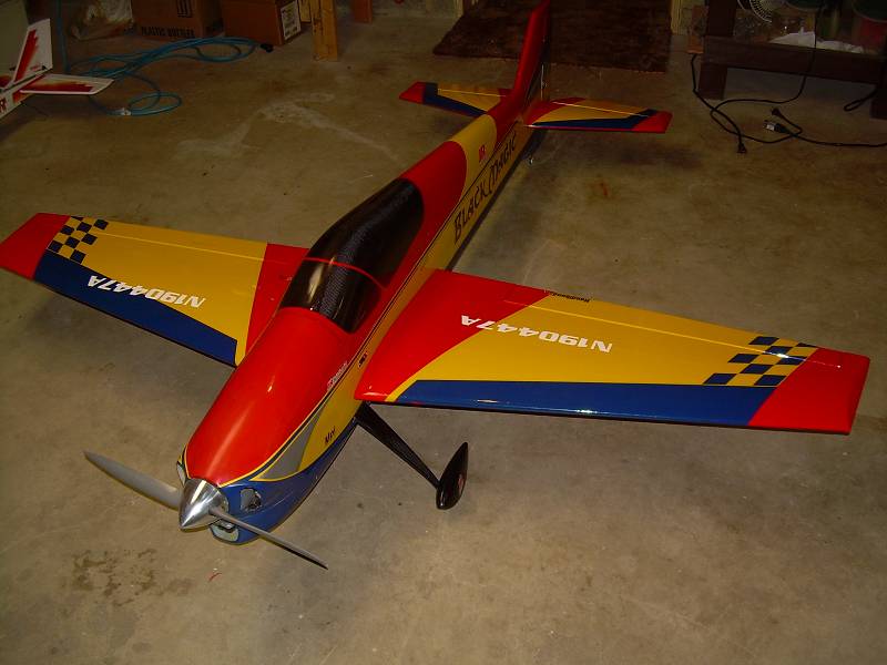

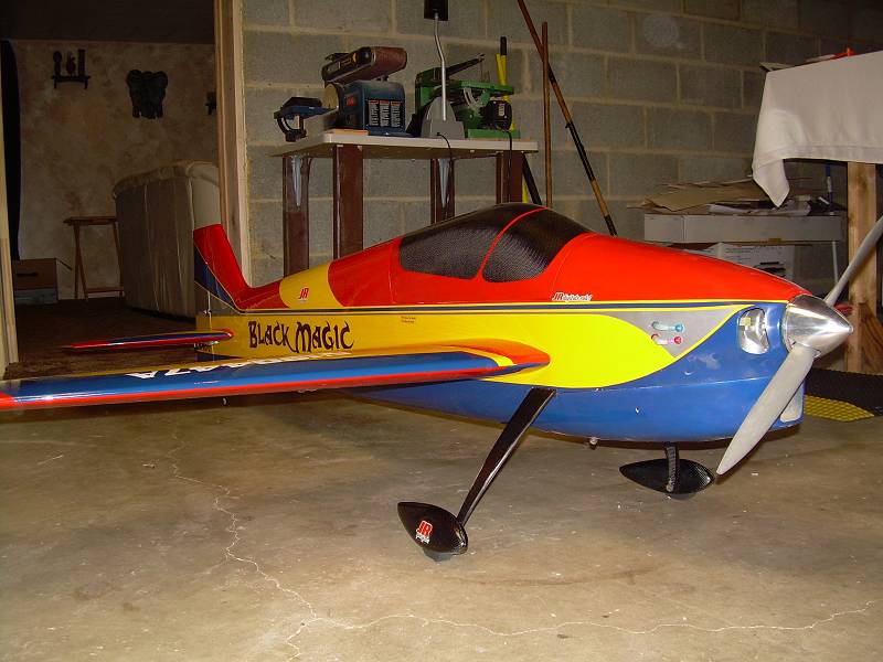

After several delays and some serious slacking on my part I finally have my BMV.3 ready to fly!! Barring any unforeseen circumstances the m=aiden flight is scheduled for this Saturday at the Weak Signals contest. Hopefully everything will go well and I can report back on a very successful maiden flight (fingers, toes, and eyes crossed). I followed this thread closely and took as much information of value from it as I could.
I would like to thank everyone that helped me along the way, with a special thank you to Mark Atwood for being my guardian angel throughout the entire build, Arch Stafford for his set up advice and moral support from half a mile away, Mike Hester for answering Mark;'s questions in the middle of the evening during Sunday build sessions, and Dean Funk for printing graphics and making an awesome canopy spray mask for me. Hopefully i didn't forget anyone.
Here are the pictures of the just about finish product.
YS 160 DZ with short pipe
JR and Airtronics Digitals throughout
JR 2100 Synthesized receiver
JR 9303 for guidance

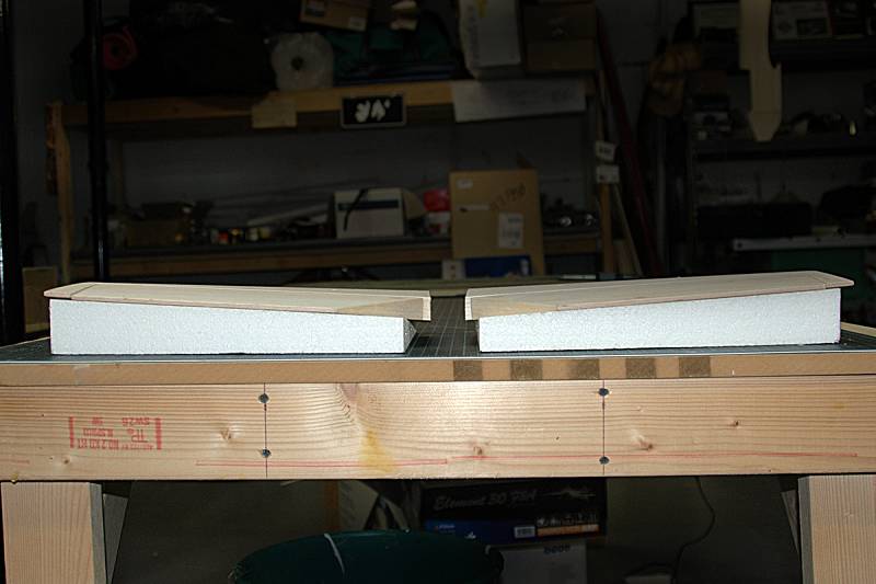

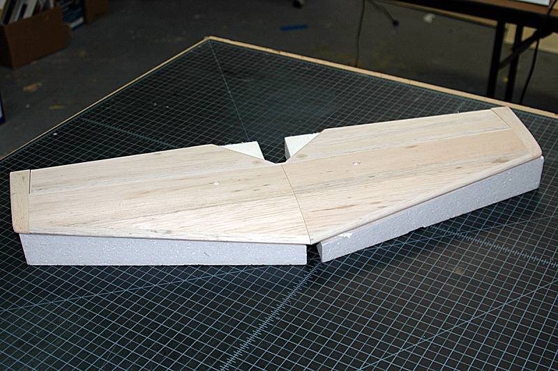

Anhedral Stabs...
Mike and I spent the day testing the prototype with these new anhedral stabs. The plane did well and they look wicked.
I'll let Mike fill in all the details, they aren't ready or available yet as an upgrade as a lot more testing needs to follow. But so far the results are very positive.
He is sheeting a set for my plane tonight for further testing as well
the prototype did well today.
enjoy the pics
enjoy the pics
enjoy the pics

So far I really like them. I had tested a set in the early life on this plane, and didn't really like them all that much. Seemed like they screwed up more than they fixed. but after a year of working on it and being analytical, I cam up with a set that had a lot less angle, a sharper TE and a little more thin overall, and still be a plug in quick change with what was already there (important for me).
What the heck, I decided to ttest them out. I only have 8-9 flights, maily through masters and P-09 with some F elements at the end of the flights. The effect was very canalizer-ish. The controls were more sensitive, the small amount of mix I was carrying was gone. Snaps were cleaner, stall turns were much easier, and the track was even cleaner than before. Inverted flight was the most stable thing I have ever felt in a pattern plane. That was interesting.
But the REAL difference was in the FAI patterns. Most planes in normal configuration feel like more of a controlled slide in KE loops and integrated rolling manuevers, but this feels much more like a clean cutting on KE. It definitely dug harder and really turned pure and nuetral with the rudder. That was also the first time I have been able to perform the last 1/4 of a KE loop at idle...LOL (it's still more comfortable with power on).
So I flew it around flat and just did hard over flat turns, pffft didn't even drop a wing or lose altitude. That was neat.
I still need to do some more playing to find the real pros vs cons, and look for any hidden suprises. But so far, so good. I hadn't really planned on offering an upgrade, but you guys know me, if it works and I really like it, I'll share.

My new stabs....
Mike built me up a set of the new anhedrals.... 3.2 oz for the complete stab, ready for the tubes, roots and adjusters, smoking awesome Hester quality.
I can say OH, YEAAAAAAAA !!!! on the plane and covered this holiday weekend...
he wanted me to tell you all that they are NOT ready as an upgrade yet, too soon to order these.... but soon, he is still playing with them, they are quite a bit different than the original stabs.
They are going on my new plane !! I am going to redo the tribal scheme on the new stabs a little bit different....
enjoy the pics
