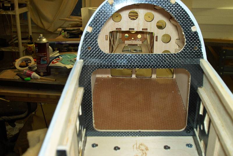

As promised here are a couple peeks at the newer electric front end. I consider it a work in progress. It's ridiculously stiff and light, but it has it's disadvantages. It's a lot more work for one. You have to pay a little more attention to cooling, and it's not quite as easy to install and remove the motor itself. It's not difficult by any means, but the stand offs are just SO simple.
Still there have been quite a few requests for this, so I am working on it. This method seems to work well, but I am going to keep scratching my head and see if I can't make it better.
I have to thank Dave Lockhart for the idea of this, we had been discussing it for a long time. in the end a simple box attached to the cowl around the spinner area was the simplest, strongest way to go about it.
I would suggest making a rear support after the motor is mounted and you know exactly where and how it will sit. Future versions will probably allow a tad bit more space between the spinner and the mounting plate.
have fun!
-Mike

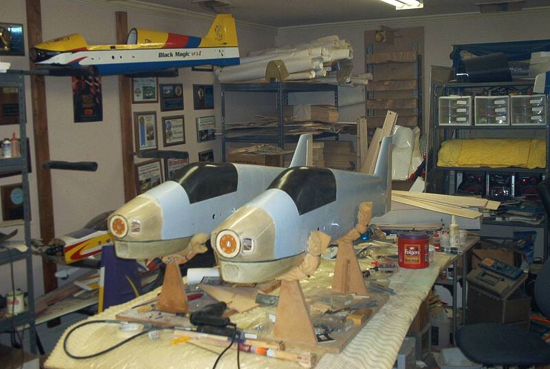

A couple more pics just for the heck of it.
These are a matched pair of electrics, 2 of the 12 planes I have been working on lately. very light. Right now they sit in about 6-8 ounces of primer each, the first brush coat to fill the weave. This coat gets sanded all the way off, then it gets sprayed. usually it takes one coat like this, one full coat of spray, and then you just work the problem areas.
And then there were 4......and then I can build a plane for myself....and get to work on that 110!

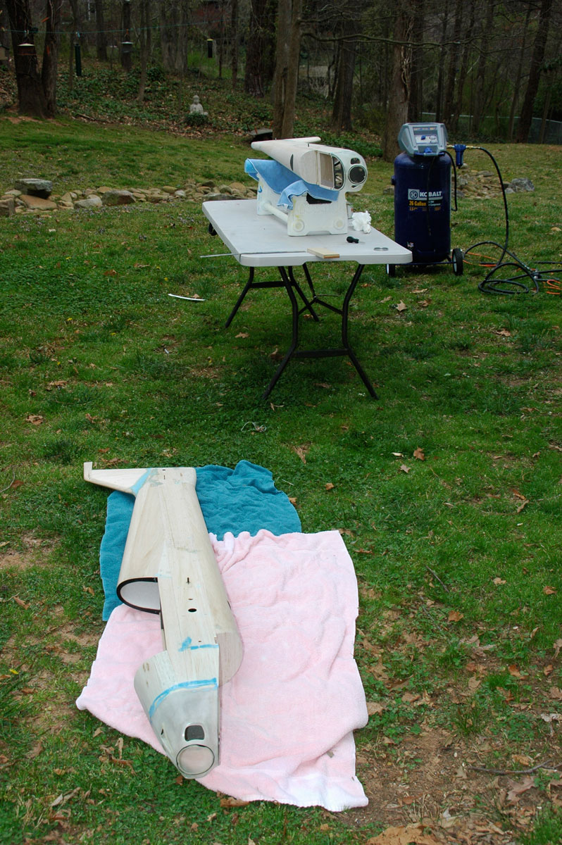

So I agreed to take them back home and put the first coat of primer on. Only took about 45 minutes of block sanding, and then rolled the primer. And while they were here I did a few more small details just for the heck of it.
They are some pretty sweet planes. I'm sure he'll be happy with them. I sure wouldn't kick em out of bed! (figuratively speaking).
So that's 8 down, 4 to go, and 3 of the 4 are VERY close. I may have myself a plane for the nats YET!!!
