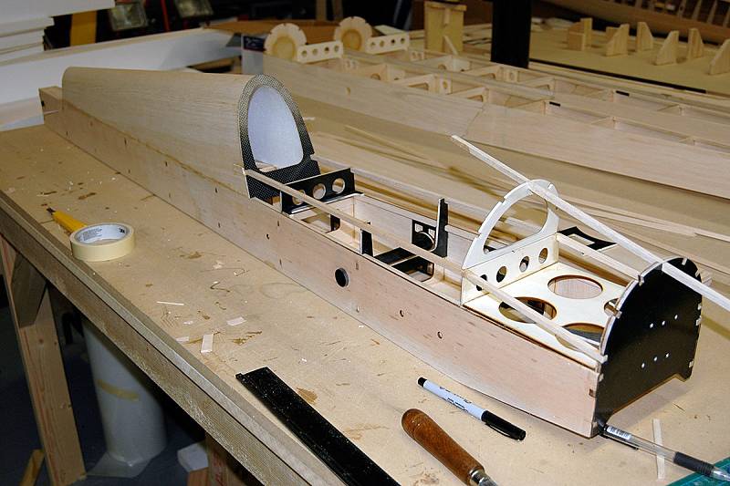

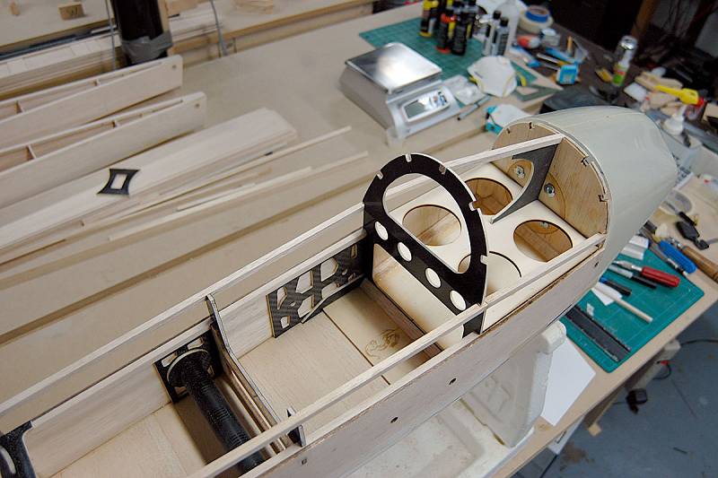

Fuse top etc....
Okay we are making good progress here.....
Once the top turtle deck core has cured install the front carbon turtle deck former, I used a thin layer of 5 min epoxy.
Now install F2T - the top former above F2 - Use a piece of 1/4 stock and lean it forward so it's 6 5/8" from the firewall. Epoxy in place.
Install F3T and F4T with epoxy.
Cut and fit the top side 1/4 stringers that run from the firewall , across F2 - F3T - F4T and then into the top turtle deck. Cut a slot to recess the rear 1 1/2 or so into the top turtle deck. Once in place you need to cap it with a bit of 1/16" sheeting wood.

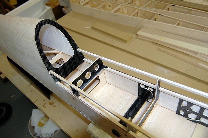

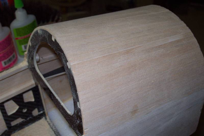

Okay now finish the forward 1/4 stringers and your ready to add the upper 1/8" fuse sides. You want to make sure your upper stringers are nice and straight. Use the canopy base to check your fit.
At this point your ready to sheet the forward turtle deck behind the cowl (between F1 and F2). there are basiclly two methods here.
Cut 1/2 and 1/4 wide planks from semi-hard 1/8" stock and plank it up - or - Shape 1/8" sheet wood by wetting and forming it to a coffee can or some other tube and trim to fit.
Either way you need to make sure you have strong wood and a good glue bond - and if you use the sheet wood method - watch for sags or flat spots in the wood.
Another thing you can do is add some 2 oz carbon cloth or kevlar to the underside of the sheeting/planking - might be good if you running a YS....
ID:	802441   Click image for larger version

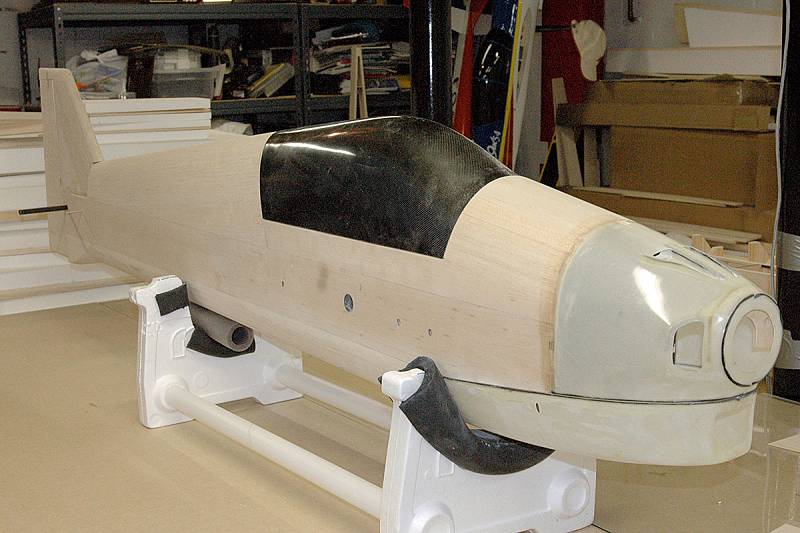

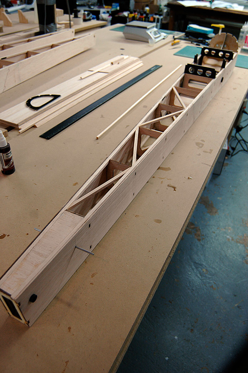

I don't seem to have any pics of the planking or sheeting. I'll update this page when I do the next plane.
But here are pics of the completed fuse, at this point you are ready to install wing adjusters and do you final wing and stab alignments.

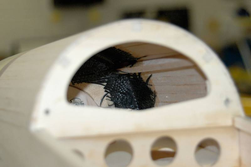

Scott Smith's Avatar
Posts: 379
From: Agawam, MA
Default RE: Black Magic VF3 Build Thread
Here you go Dean, I just happen to be on that step this morning! I have my doubts about how well this will sand out though. I kind of wish I had wet formed the sheeting in a foam mold (exactly like the turtle decks, just no glue.) When the wood dries and comes out of the foam, it holds the shape perfectly. Then it could be glued to the stringers dry.

Hey Scott...
It looks good to me, remember you will be filling that area - apply the filler before you do your finish sanding - use that "SuperFill" filler from aircraft spruce - Mike turned me on to that stuff and it's really good.
I like the strip planks myself - I've seen the wood sag a lot when you do the sheeting. You can use stiffer wood too.

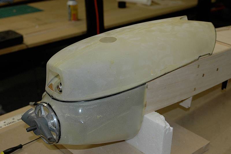

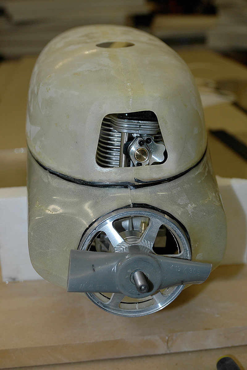

Hi all,
I installed the motor mount and checked alignment against the cowl and chin. The template supplied with the plans is super super close to perfect.
I lined everthing up for the deps that I will install tonight.
